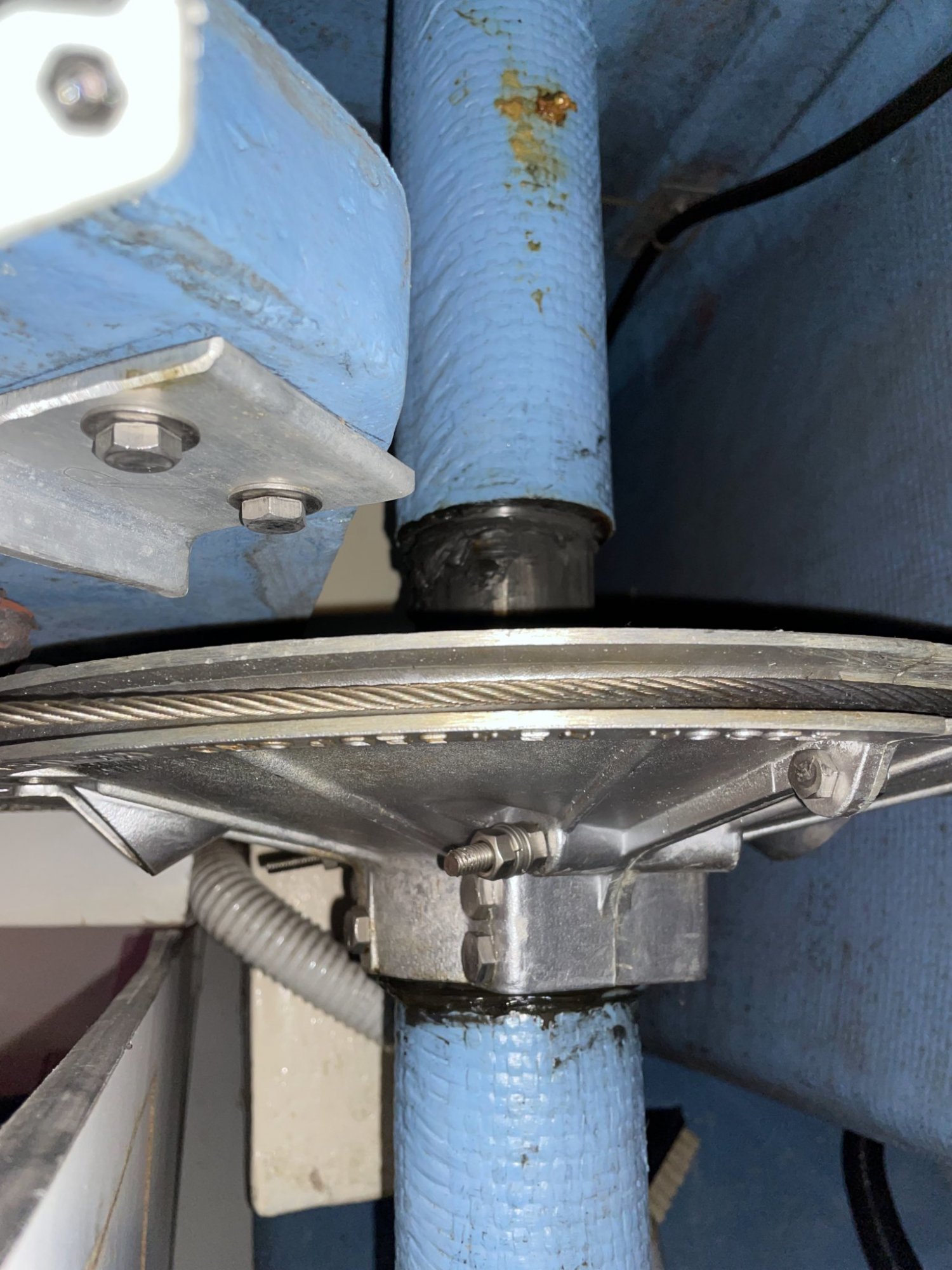

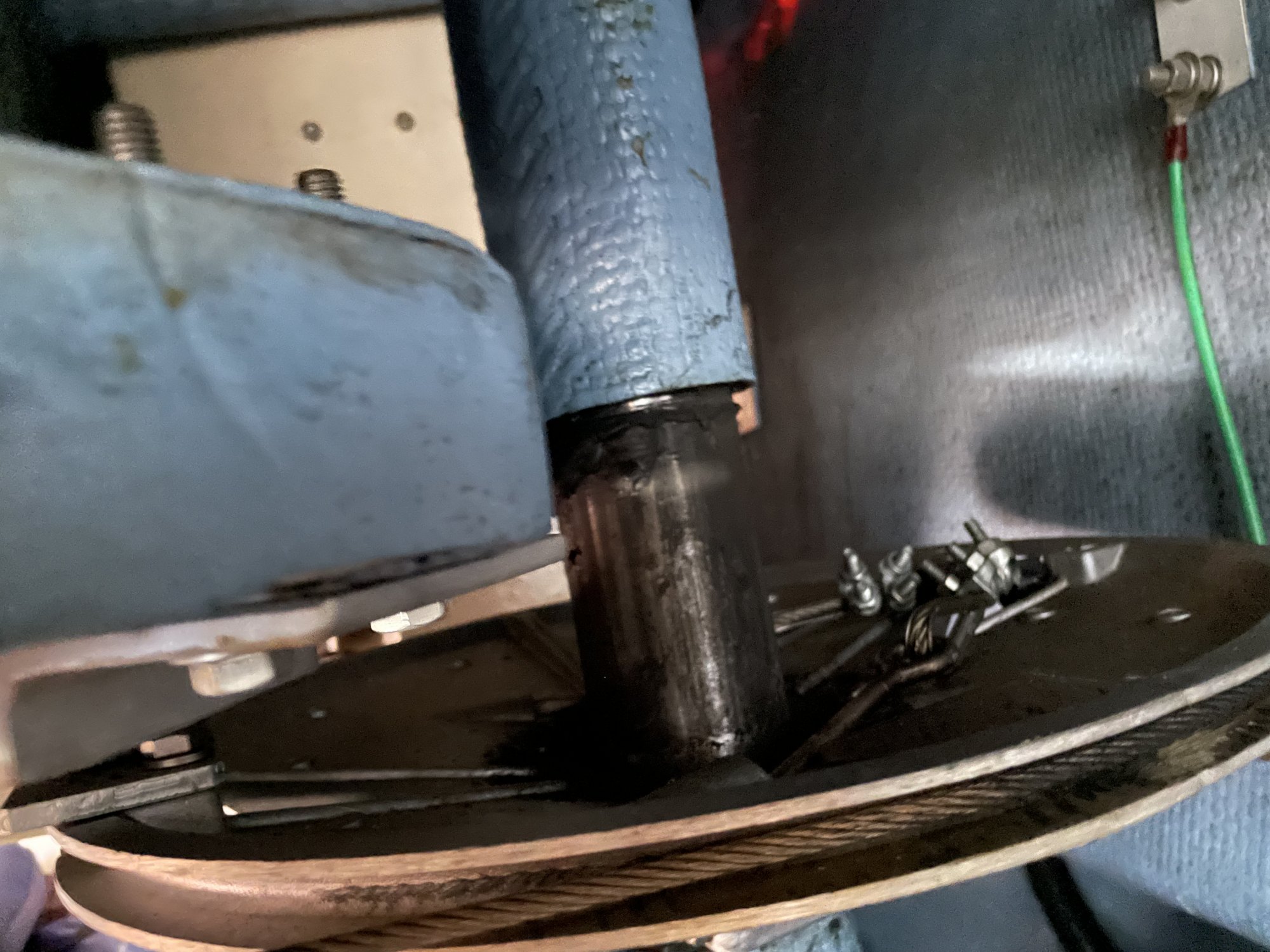

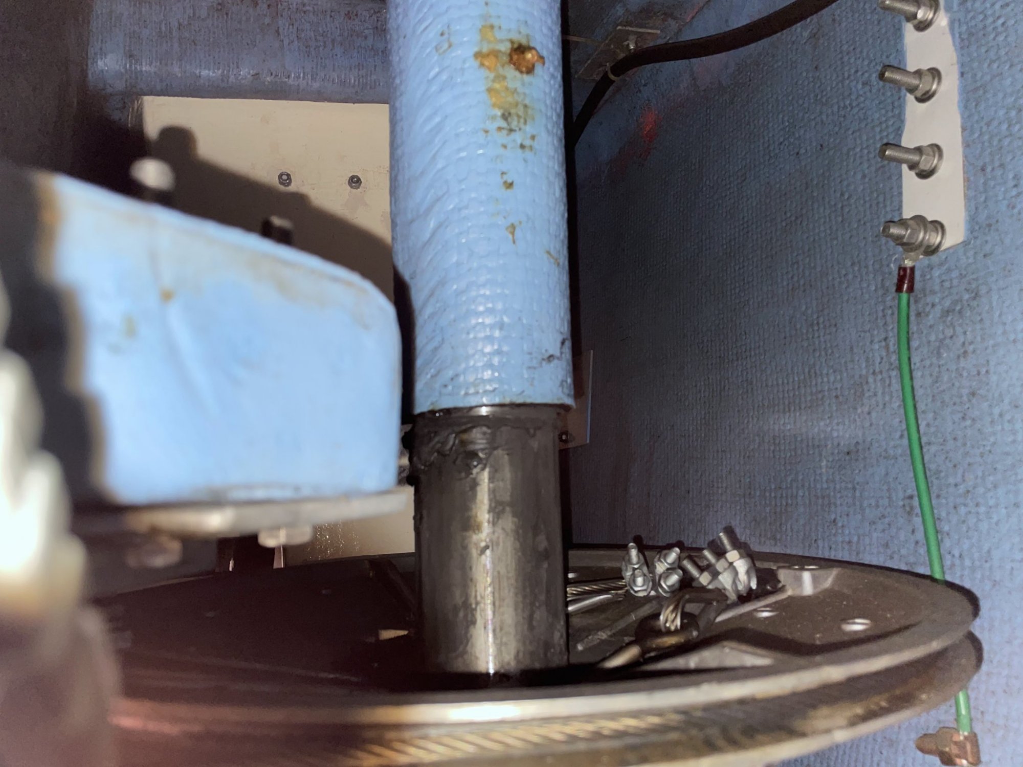

Different boat, but on my O’Day, the cables go around the quadrant, and have an eye at the end. Then the eye is secured on a long bolt on the quadrant.
These may give you a little bit of an idea where to look.

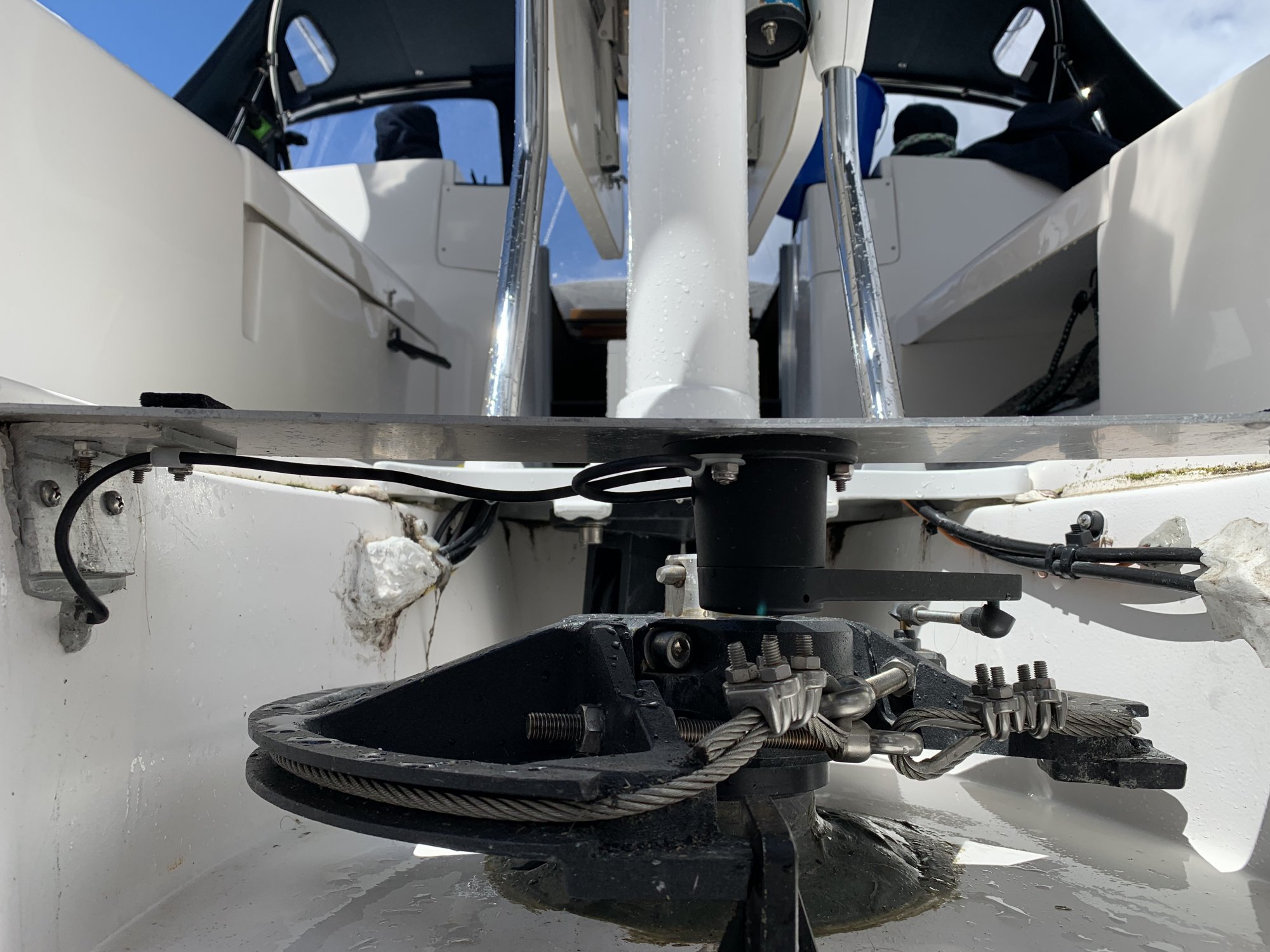

Greg
May 7, 2012
1,573
Hunter e33 Maple Bay, BC
Not a Legend nor a 35.5; but, a Hunter with a quadrant non-the-less. This pic shows well over an inch of take up on each of the eye bolts. If that doesn’t solve the problem back off the nuts on the eye bolts, loosen the clamps on the wire rope, shorten the wire rope and then retighten the clamps again. Grease everything up or spray with Boeshield T-9 while you’re at it.
