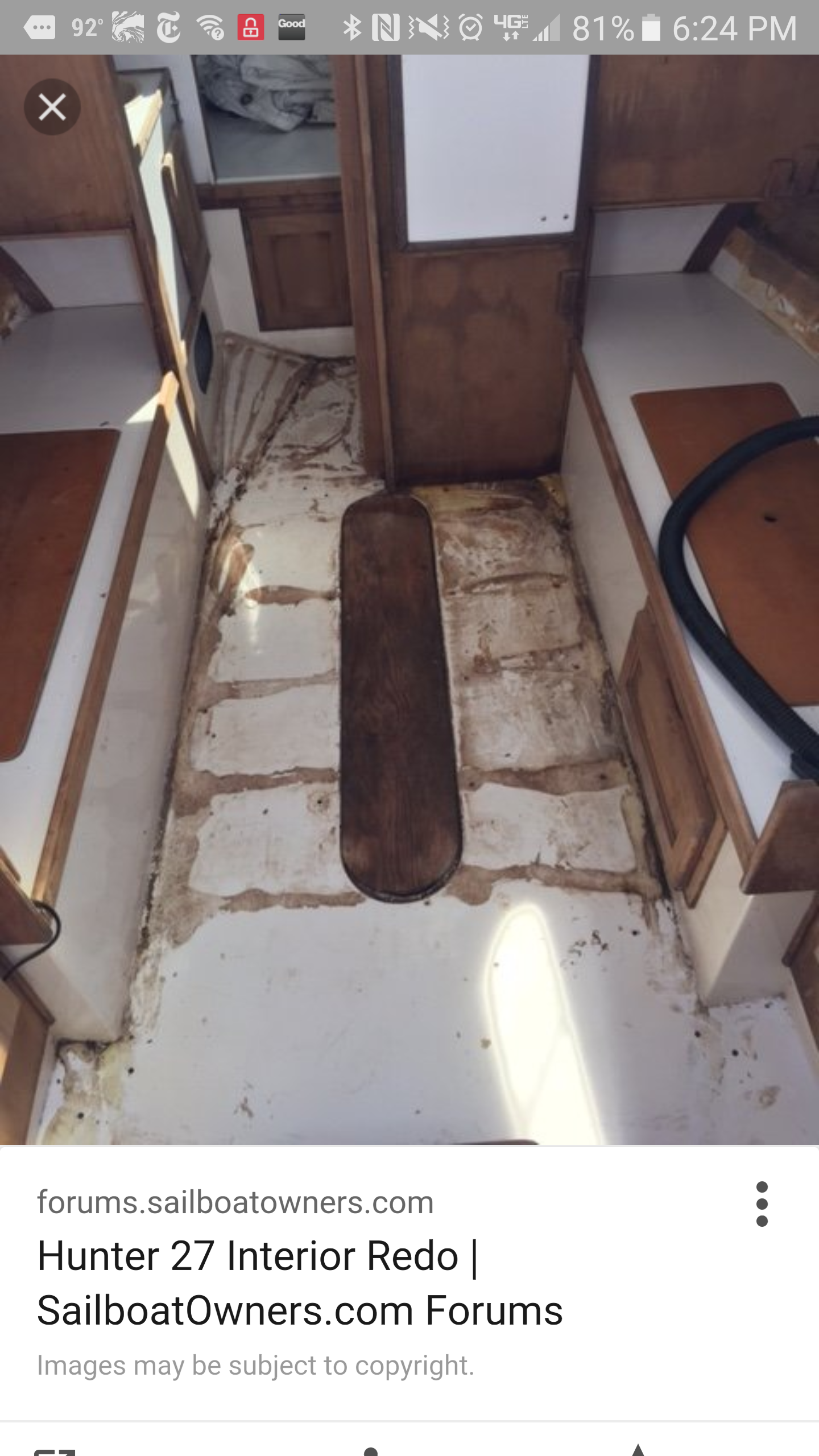

Okay, so ordered the book. I cleaned out the holding tank, and about 70 percent of the smell is gone. But still no go. So decided to attack it as a bilge problem next.
I'm assuming in the attached photo (not a photo of my boat but a sample I found on the internet), that the teak panel on the floor is covering the bilge. Am I correct?
If so, on my boat, this panel will NOT lift up no matter what I do. And the lift ring is broken as well. Any suggestions on how I can get this thing lifted without damaging everything?

If there's a lift ring on it, it's a hatch...or was originally. Hopefully the PO knew better than to glue it down...or at least didn't use 5200 if he did.
Have you tested the sanitation hoses for permeation yet? As I said early in this discussion, it's the most common source of odor inside a boat.

A wide flat screwdriver or a wood chisel may work to get under the edge of the bilge board. You might dent the wood some trying to pry it out, but you need to open her up and see what is under there.

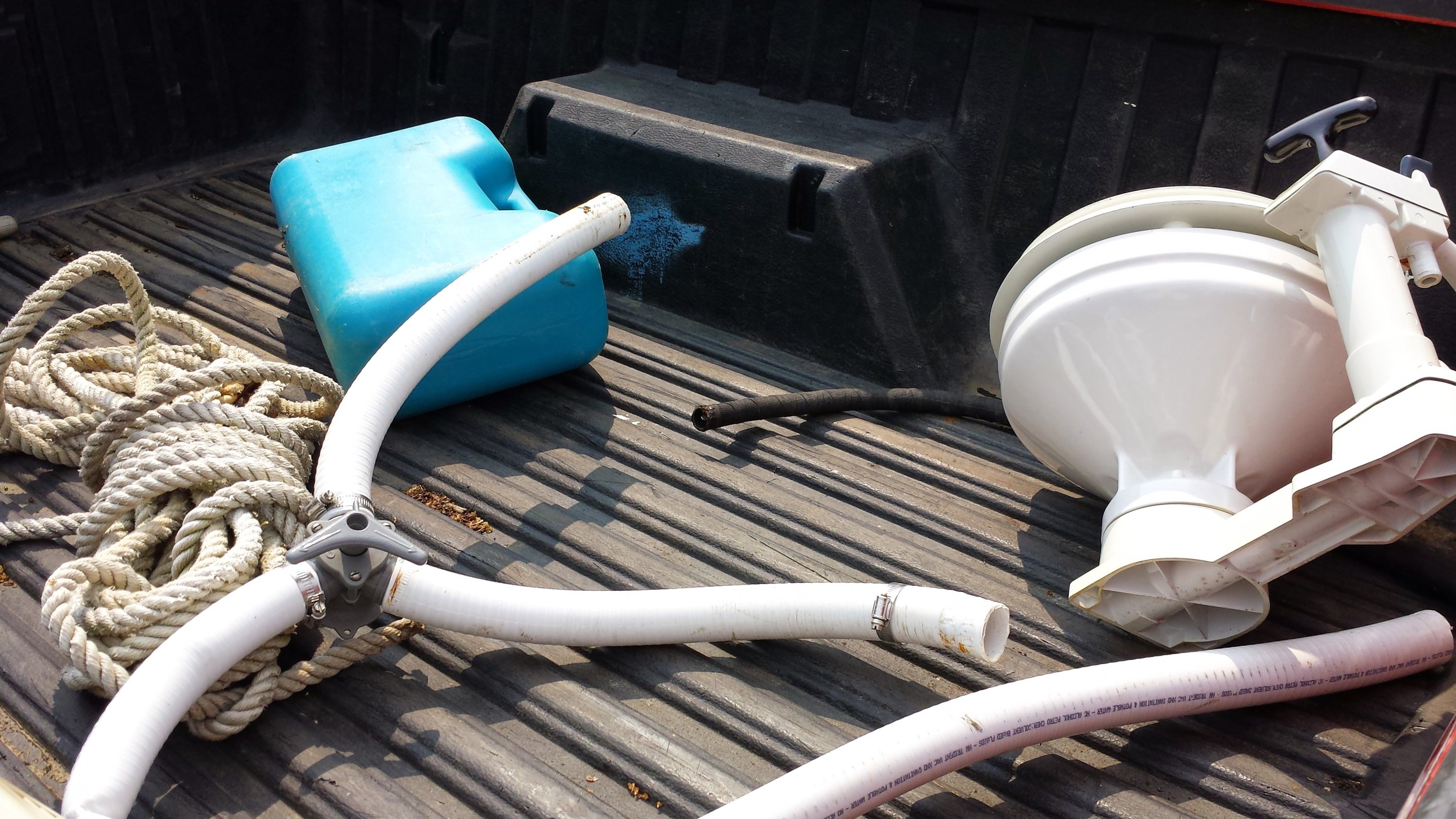

Sorry to say. When it comes to the head, I don't fool around. Every boat I have ever purchased the first thing I do is remove the holding tank, head and head hoses. I'm not sure what kind of set up was in there but it was out about first thing.
Try to link up with a fresh water flush instead of sea water. It will get rid of continuing odors.
I actually used a portable unit by sea land which converts to a holding tank with fill. Kinda crazy but it's great in my 27 footer.
Old:
Darn. No new pic.
Anyway here is kind of like what I got.
https://www.westmarine.com/buy/thetford--porta-potti-550p-msd--14562060?recordNum=2
