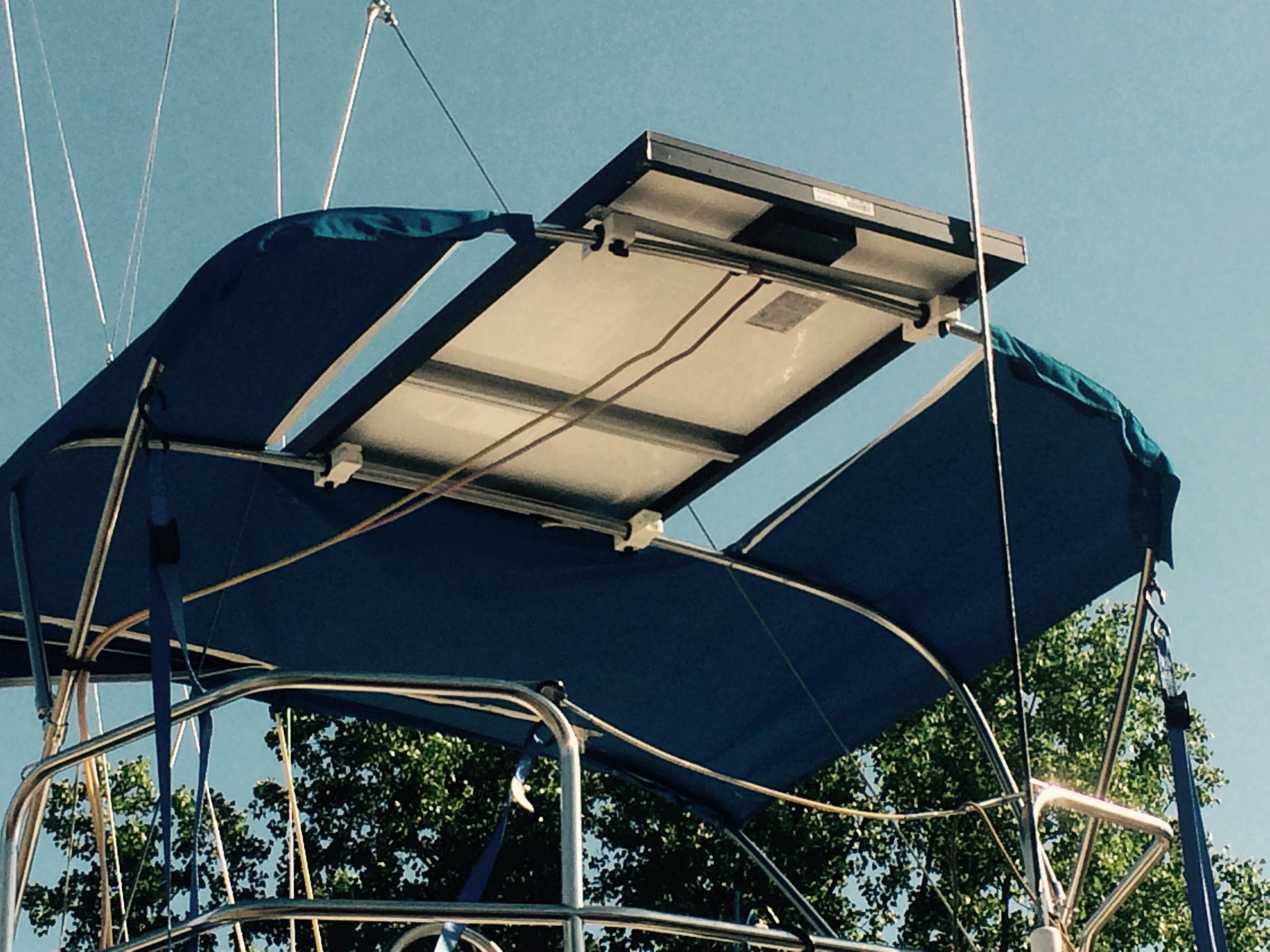

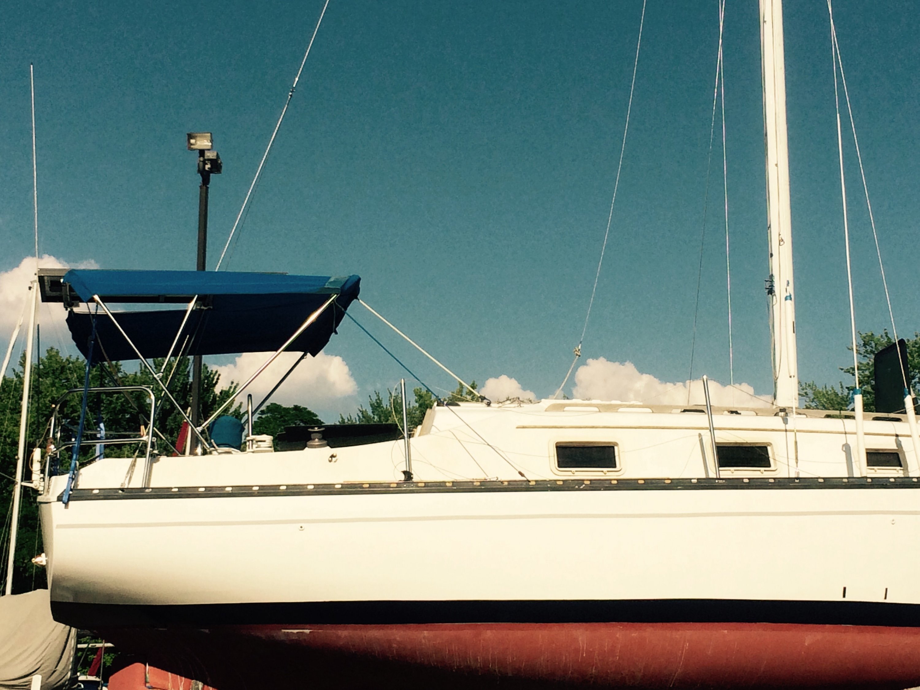

Not sure if my 27 is set up like the 30s, but here's a couple of pics of my split backstay. Plenty of room for my Bimini and solar panel.
