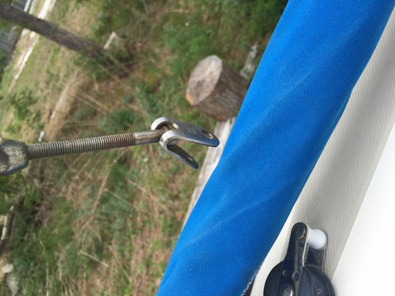

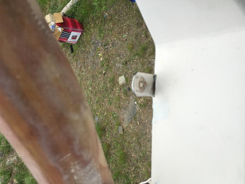

I looked at my backstay and pictured is what I have. I know I need to order a part however I ordered the wrong part from Rudy and wanted to know if this would work. The part I ordered is LOWER TURNBUCKLE T-TOGGLE LH THREAD 1/4-28 COMPLETE W/ CLEVIS PIN. (For an ODAY 26)
Here is the picture of what I currently have:

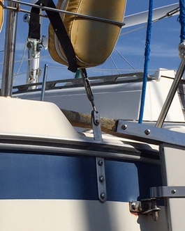

Here is a pic of a 25 or 26 back stay connection. They should be the same. Why do you think you ordered the wrong part? the description sounds right.
Apr 15, 2015
61
Oday 26 Gloucester
Ward,
I originally ordered that part thinking I ordered a turnbuckle. One of the lower shrouds turnbuckles is squashed. I dd not receive that piece I received the Toggle instead. I guess I can use it for the back stay.
