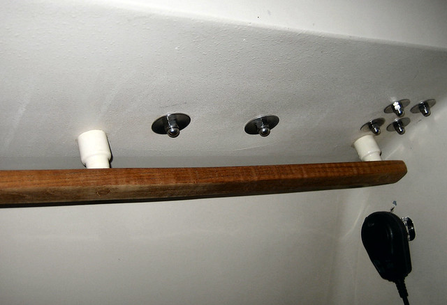

You can also use a teak block and finish it bright so it looks good, or don't use a backing plate at all and use fender washers.
