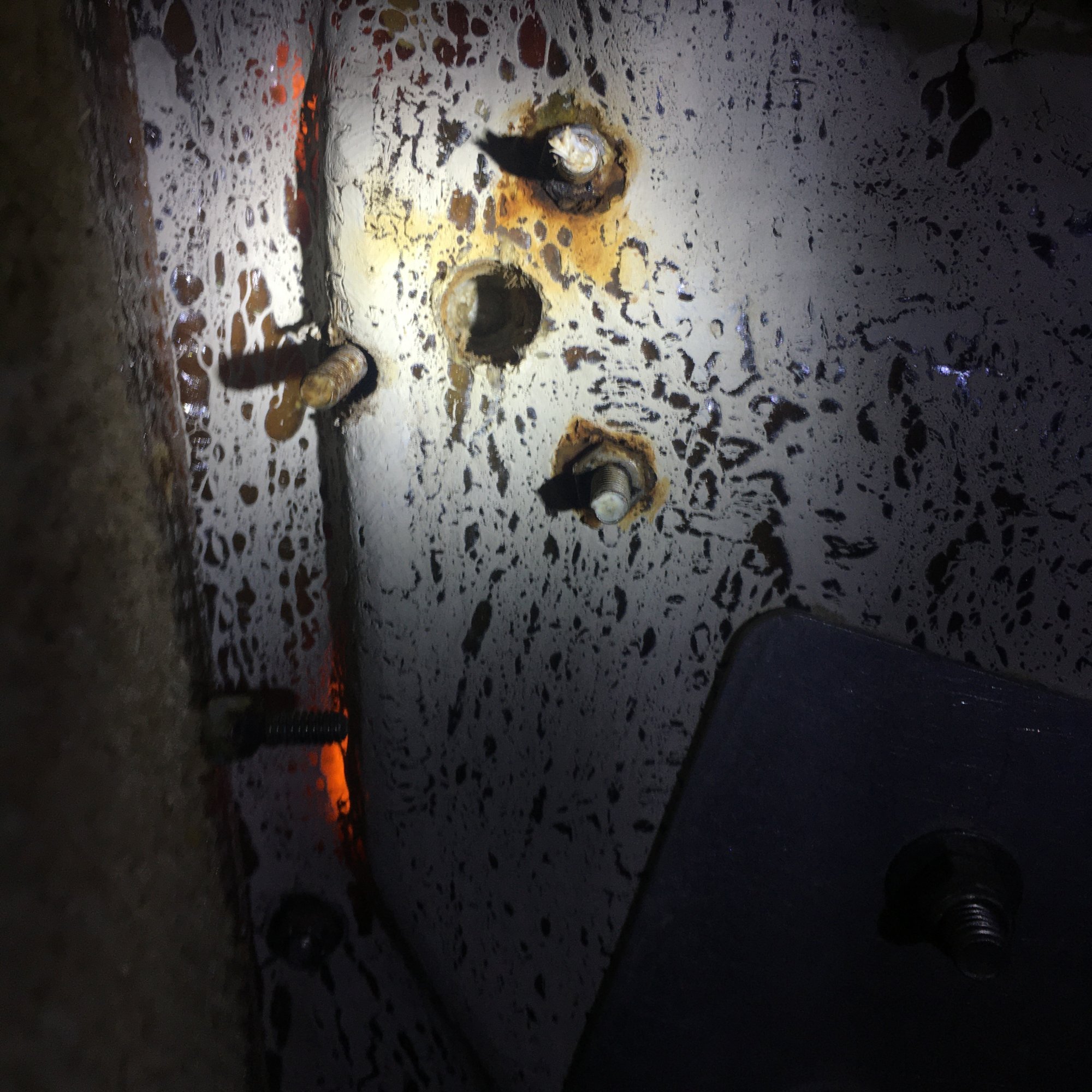

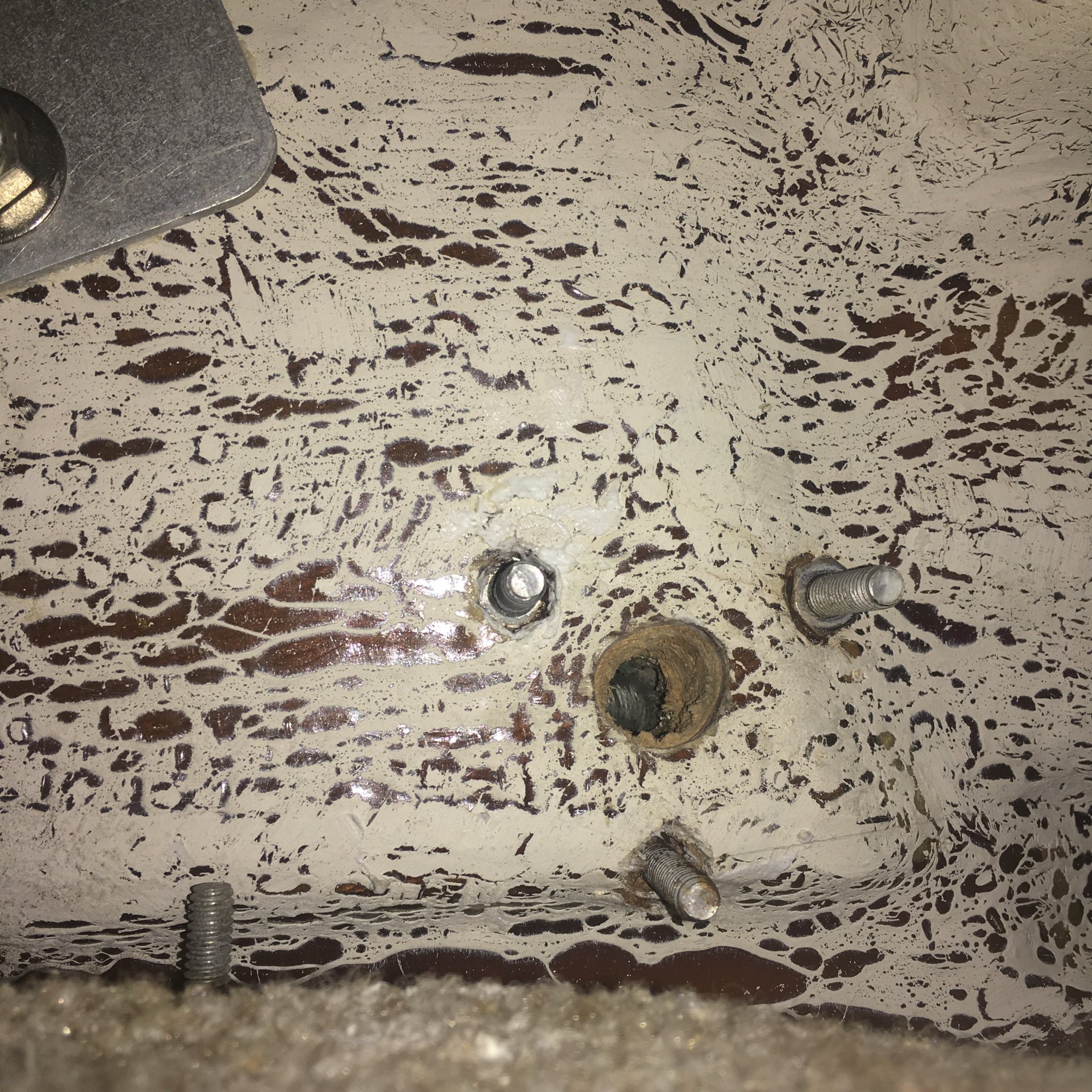

I decided to check out the very hard to get to backing plate under the foredeck deck/anchor cleat on my O'day 31. That was fine but I was stunned to see how the two forward feet of the bow pulpit were attached. Not even a washer! I'm not sure there is even a nut on the outboard end of the two feet. It's my fault I haven't checked and rebeded earlier but I've had this boat for a long time and it has been generally very tight and dry. Guess I've been lucky.
No questions here, I just thought I'd share.

What's the core? Plywood? Plywood can be a backing plate, but there should be a washer at least.
I think it's balsa but could be plywood. But either way it's obvious some of the nuts have been sucked in through the layup into the wood.

If some of the nuts prove difficult to remove, use a nut splitter tool to break them. Clearly you need washers, at least.
Thanks.
For a couple of them I am going to have to grind off the tops of the bolts and push them down through the deck.
The hrd part, other than access, is going to be trying to figure out how to get some effective backing on the two outboard nuts that lie right on the edge between the cored and non cored sections of the deck. I guess a one piece backing plate should handle that though.

... The hrd part, other than access, is going to be trying to figure out how to get some effective backing on the two outboard nuts that lie right on the edge between the cored and non cored sections of the deck. I guess a one piece backing plate should handle that though.
I would probably sand the surface and lay on about 5 layers of 1708, then re-drill. Then the curves don't matter. Also refill the holes first with thickend epoxy. Finally, don't use fender washers (they bend) use extra thick fender washers (Bolt Depot).
View attachment 184845View attachment 184846
You might want to fill the holes with epoxy and redrill.
