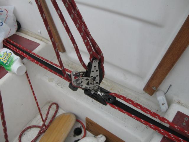

No. 4200 is not very easy to remove. Just slightly easier than 5200. Use Butyl and you will have less chance of leaking and it will disassemble very easily.Thanks, Tim. You have tried to sell me on that traveller before. I just needed a good fix to a bad mainsheet system, and didn't want to get into all that right now. So if I use 4200 I'll be able to remove the cam base without too much trouble when I go to install my midboom sheeting system? Many thanks.
