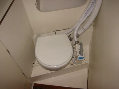

Jabsco 29090 -3000 Twist 'n' Lock manual toilet instructions (does't matter whether yours is the "twist n' lock" version, the instructions are the same for ALL versions). And it needs to be at least 6-8" above waterline AT ANY ANGLE OF HEEL...which on most sailboats puts it 2-3 FEET above the bowl. See attached photo

I went to the boat and verified that I already have the vented loop as you mentioned (and checked it to make sure it works). So I'm debating whether I will replace the joker valve and maybe other parts on this Jabsco or just get the same size Compact II or PHC Raritan. On my previous boat - you recommended the SeaEra to me and it was a very major upgrade. Do you think these inexpensive compact models are built well? It seems my plumbing as-is is done correctly - it sounds like I just have maintenance issues?
