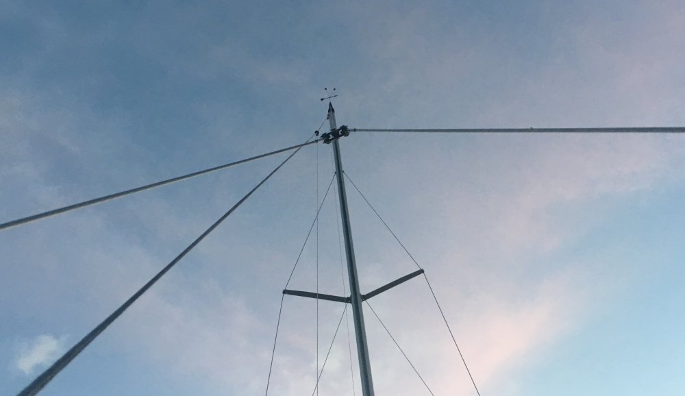

The partner determined our H35.5 back stays were loose. We don’t have a gauge. We don’t have a Legend to compare too. He thought they needed to be tighter. They probably haven’t been touched in years.
It appears the main is even harder to hoist now. Might this be because of the bend he added to the mast?

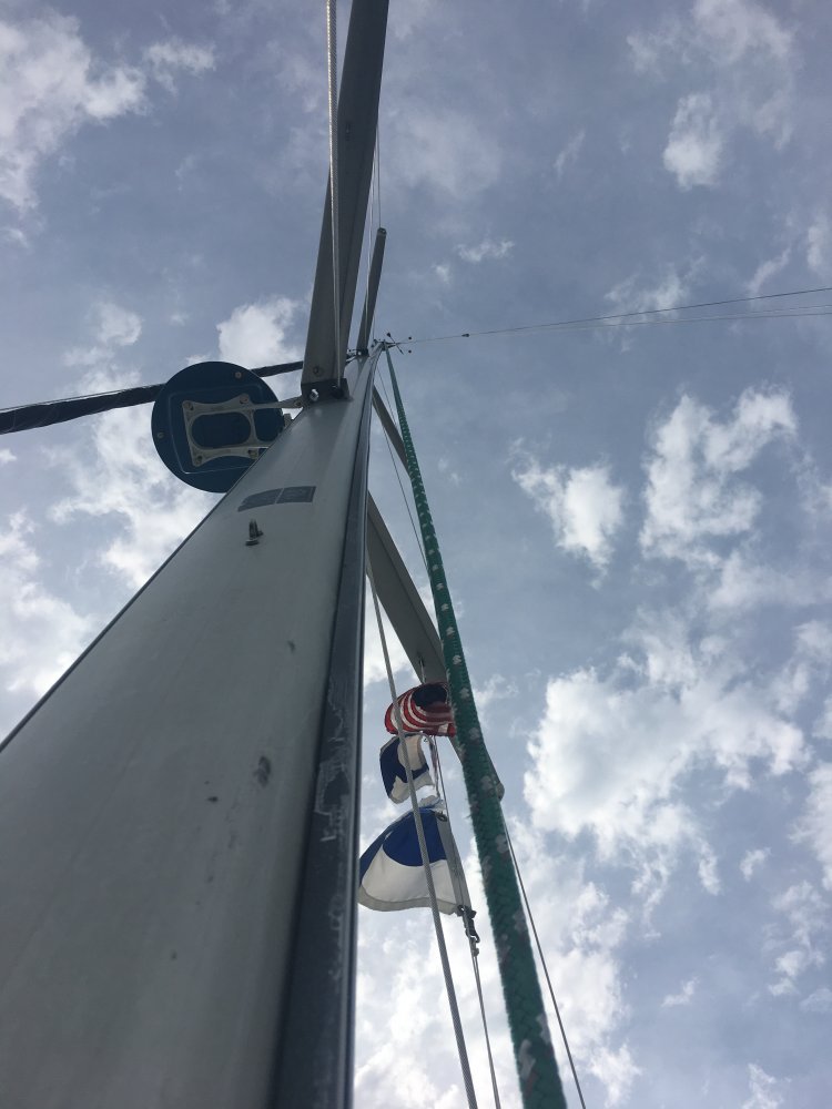

Might this be because of the bend he added to the mast, or am I just annoyed he screwed with something that probably was just fine?
The latter, most likely.
The twist is odd. What size and year is your boat, it looks like a larger model. A picture from the side might help too.

If your mainsail slides are a close tolerance fit into the grove, then extra bend can make them hard to pull. In particular if you have longer ones, or a long one at the head.

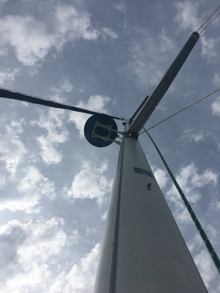

there is a twist in the back stay visible at the plate/clamp thing
Interesting. Mine has a split backstay, but two lower parts are actually one piece of wire, and the diamond plate has sheaves in the lower corners over which this wire runs. There's a hydraulic backstay tensioner on the starboard side only. This is not what the documentation for the boat shows; it shows an arrangement like yours, a tri-plate with two separate lower pieces, with their own turnbuckles. It was either upgraded by the factory or a previous owner.
I suspect your twist is because when the turnbuckles were adjusted, the upper stud in the turnbuckle, swaged to wire, wasn't prevented from turning with the turnbuckle body, and a twist was put into the wire.
You should loosen then, lube the screws (Lanacote) and tension again, this time making sure to hold the upper stud from turning with the turnbuckle body.
