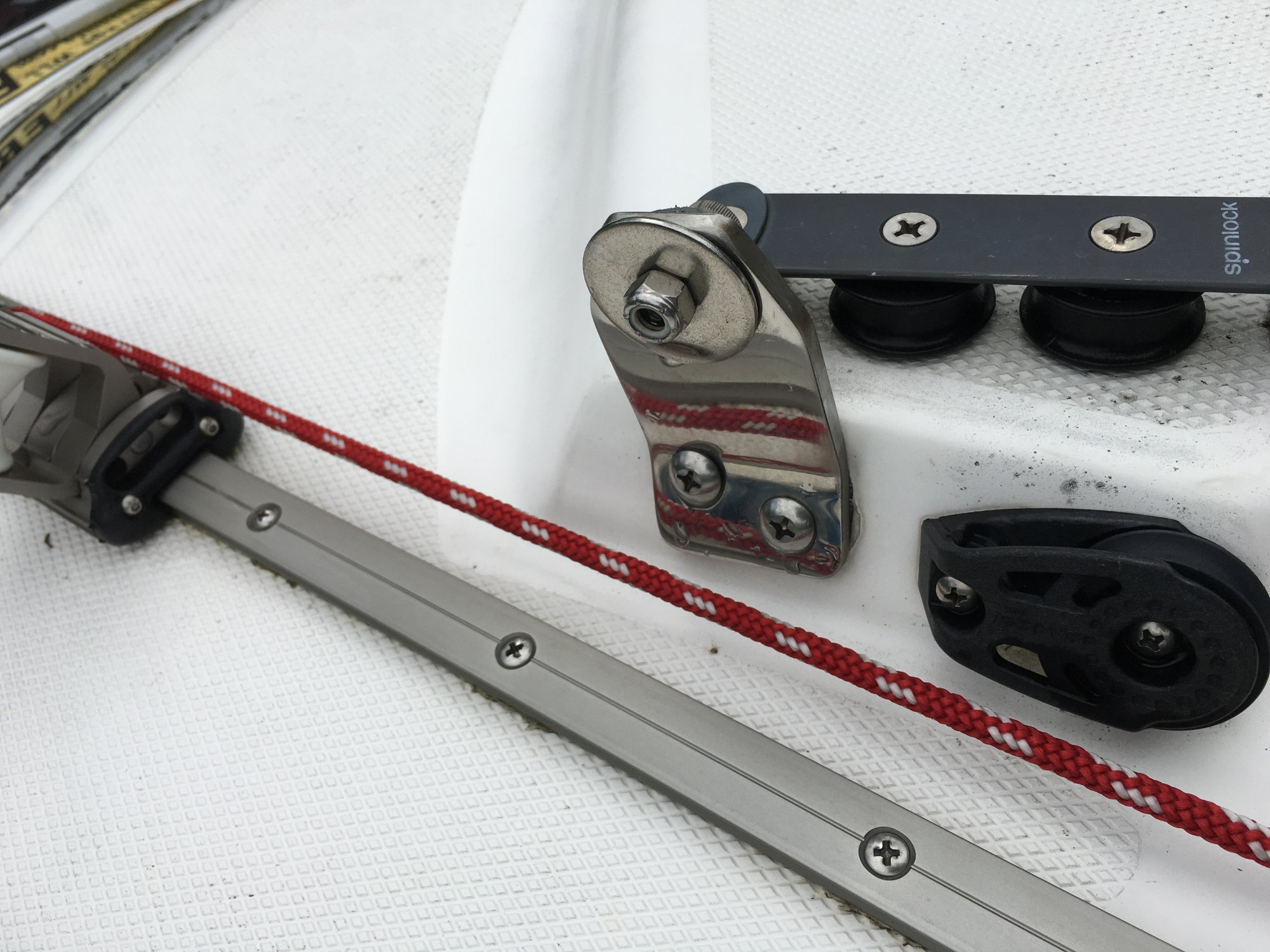

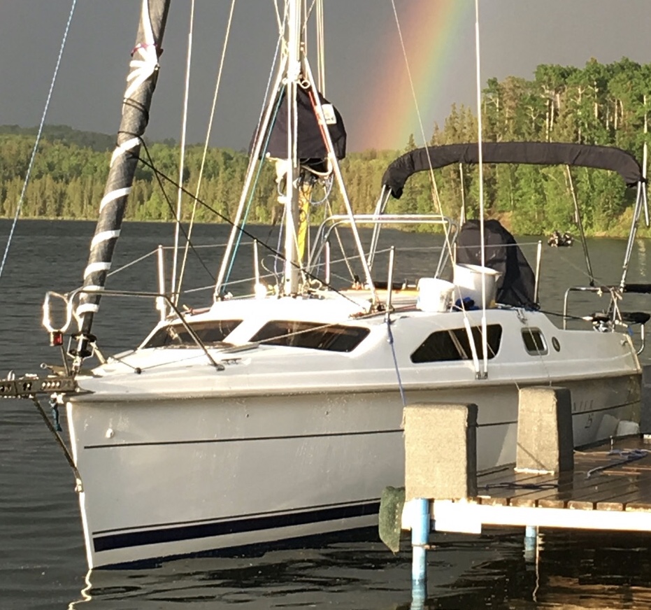

I own the H25 and it comes with two SS struts attached to the mast and down to the deck in line with the pivot point. I know I have some bias towards this set up, but frankly I have hot seen any that are better. It really is simple and adds to lateral stability during and after raising. Here is a photo of my boat and struts. The setup really isn’t that complicated and could be built by DIY kind of guy or welding pro.

I own the H25 and it comes with two SS struts attached to the mast and down to the deck in line with the pivot point. I know I have some bias towards this set up, but frankly I have hot seen any that are better. It really is simple and adds to lateral stability during and after raising. Here is a photo of my boat and struts. The setup really isn’t that complicated and could be built by DIY kind of guy or welding pro. View attachment 182568
Thanks for the picture. I have actually been considering such a setup. It looks pretty easy. The only thing to figure out is the attachment at the bottom of the tubing. I have some tubing laying around that I could use. Thanks for sending.

I can take some detailed photos of the attached for you if you like.

I can take some detailed photos of the attachment bracket for you if you like.

That would be very helpful...thanks! I can deal with the upper attachements but it is the lowers that I will need some help with. Thanks again.....

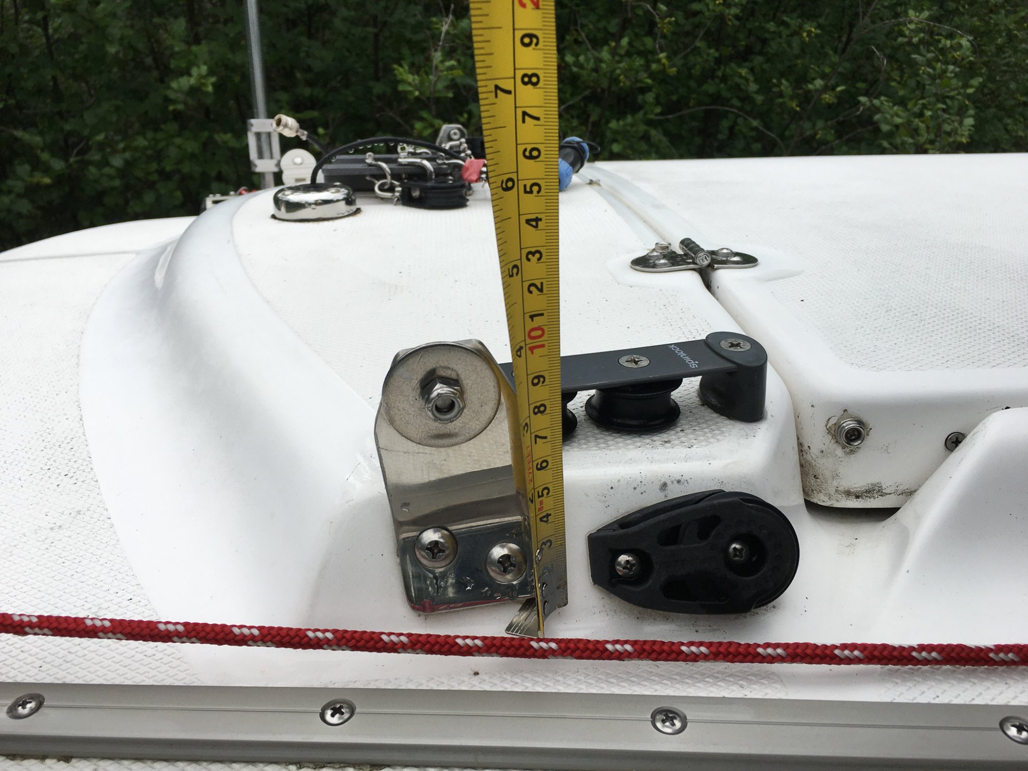

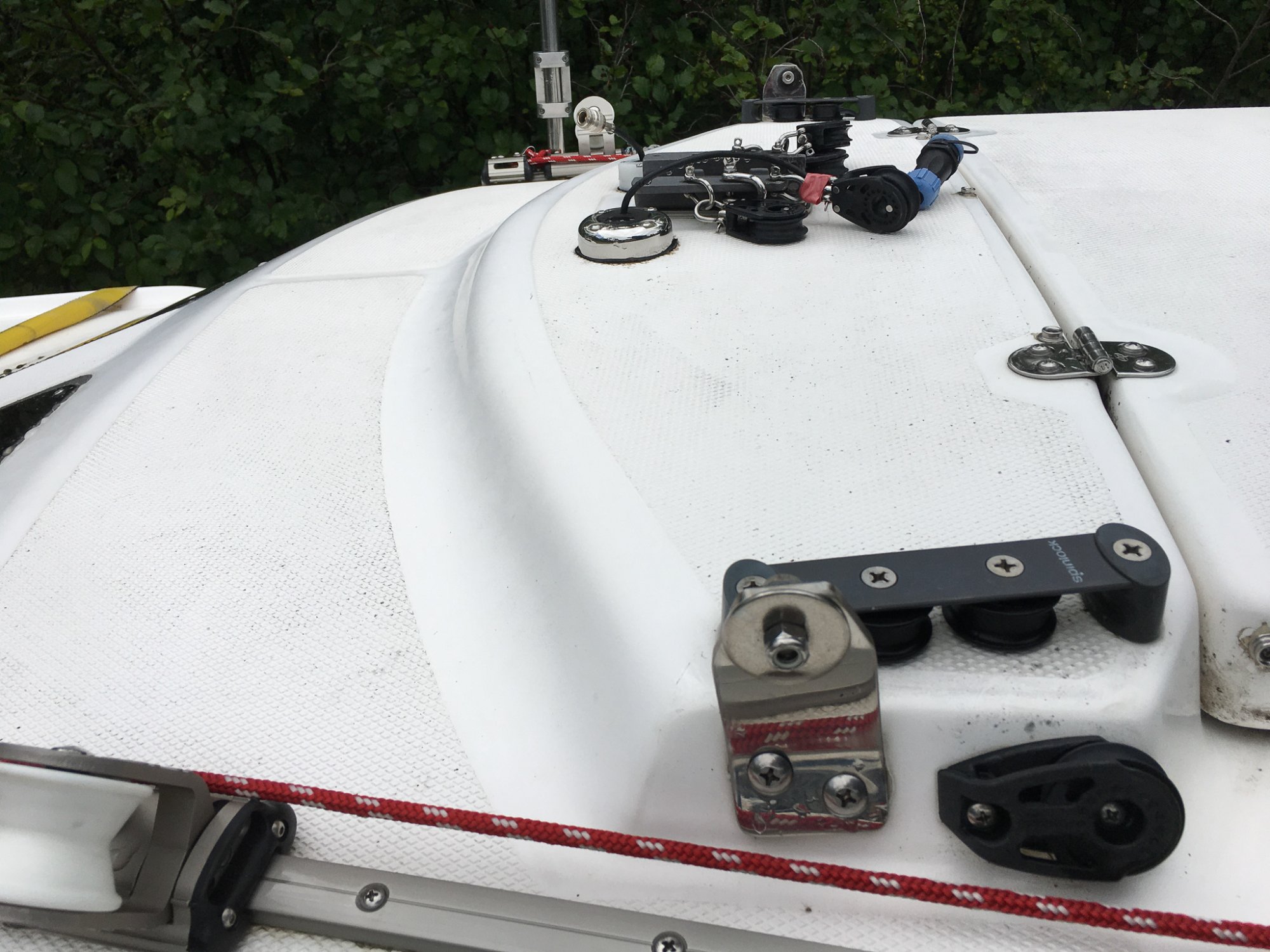

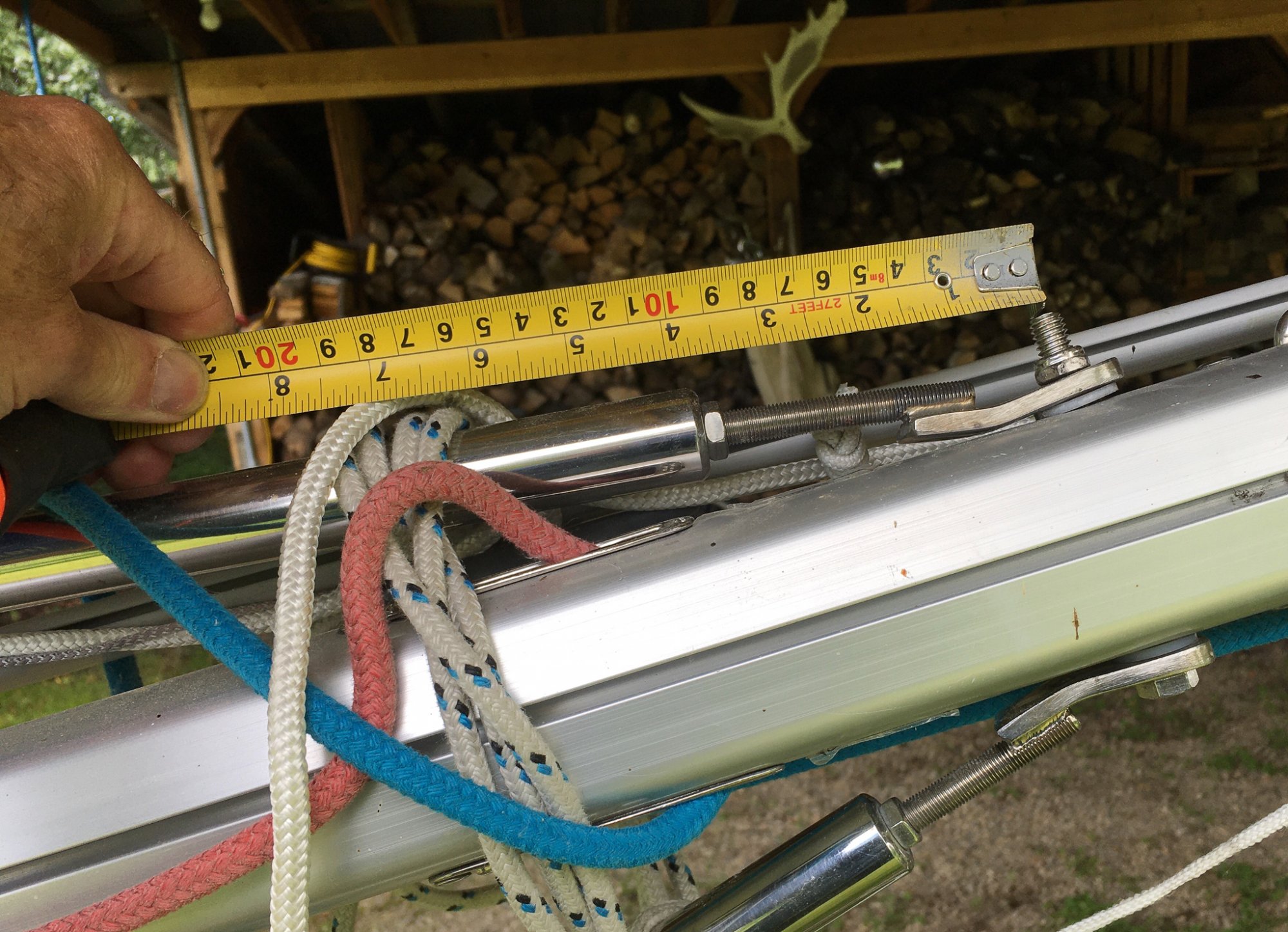

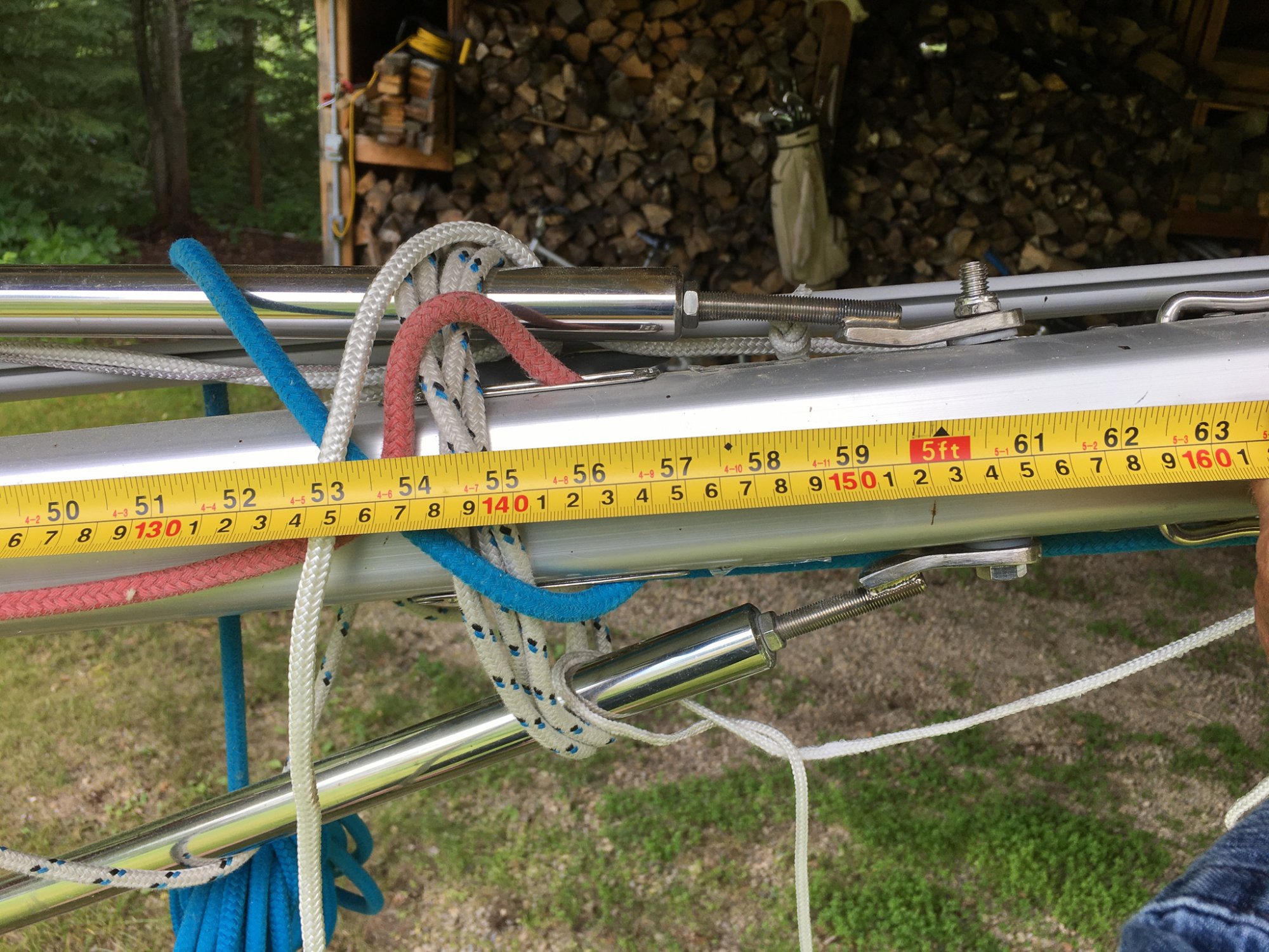

Here is my setup. Must mast if off right now due to an accident in the parking lot that bent the mast. Actually, the two struts prevented the mast from total collapse which would have caused damage to the hull and mast base bracket (another good feature of this rig) I will need to send the photos in multiple posts a they are too large to send all at once.

Here are the rest of the pics. Note the top of the strut has a threaded rod for adjustments. The second pic shows how high above the mast base the struts are attached. Image 6436 shows the deck brackets alignment to the pivot pin hole on the mast base. Also, note the nylon washers on both top and bottom bolts for reduced friction.
Hope this helps and keep us posted with your final product.
