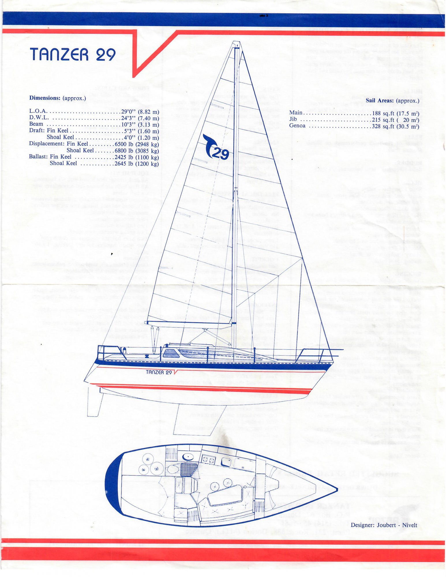

Are we to assume that your question about baby stay tightening is for a Tanzer 29?
The image of the boat rig, I found, does not show a “baby stay”.
Yes, I'm asking about my Tanzer 29.
Either look a little closer at that image or maybe I'm using the wrong terminology.
By "baby stay" I mean the piece of standing rigging that goes from the middle of the mast's height to the forward deck, close to the mast base.
Looks like it has a baby stay to me. Other photos I found of the Tanzer 29 show one too. I think you may be seeing it and thinking it’s a forward lower.
