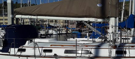

Can you please post a photo of the current arrangement? In the meantime, suggest routing the mainsheet to a block attached to a bail on the boom then through a block with springs attached to the base of the mast then through turning blocks on the cabin top then through a clutch then a winch on the cabin top close to the cockpit like the routing in the photo below.

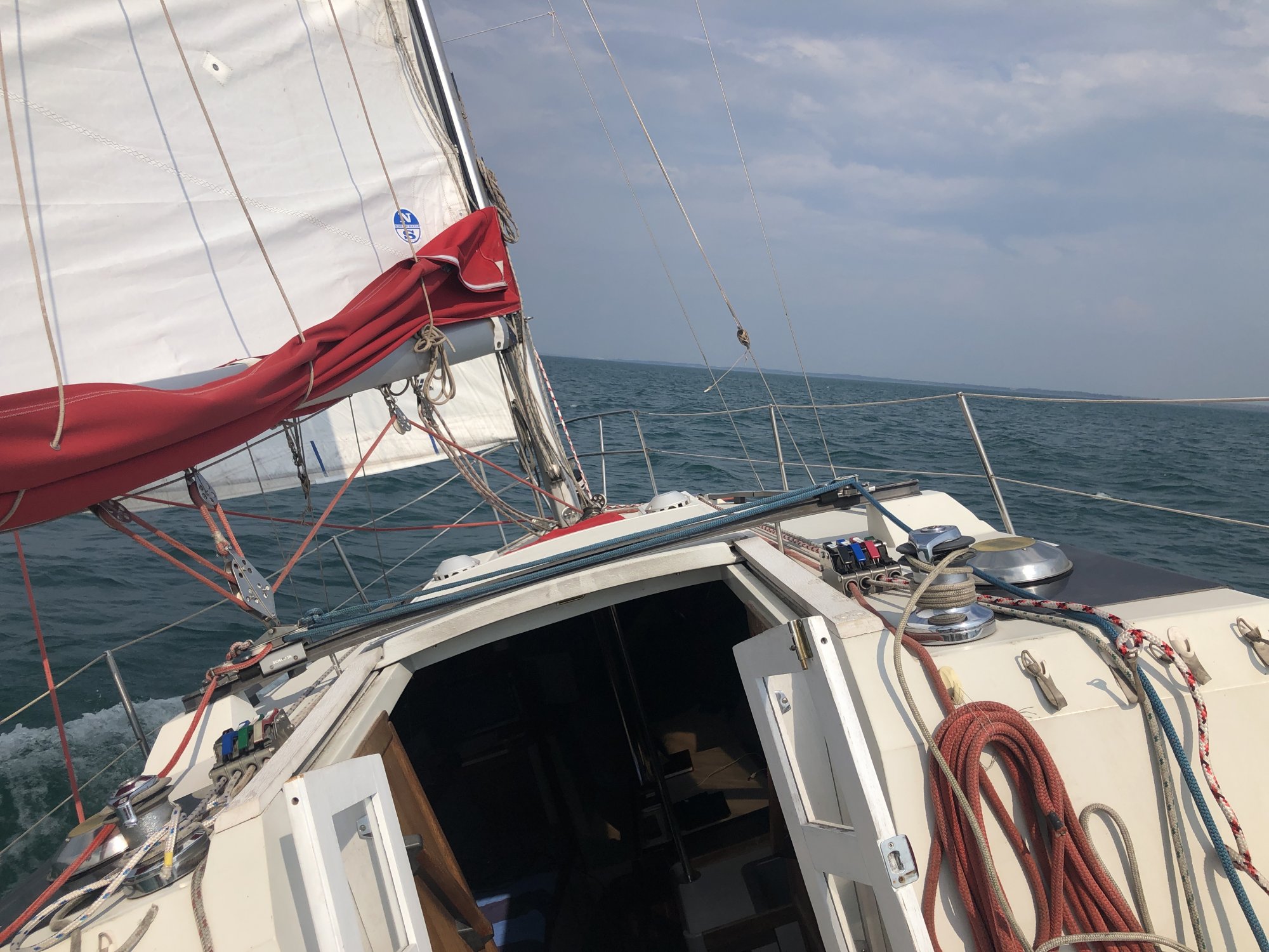

Here is a shot that shows how the mainsheet runs forward to the mast, and back to a clutch and winch on the cabin top. The mainsheet (red line) is hanging to the right of the companionway.
Greg
