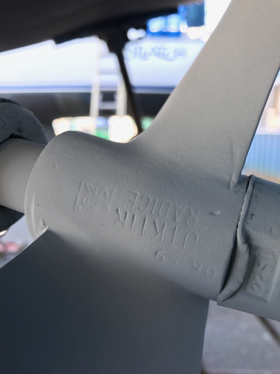

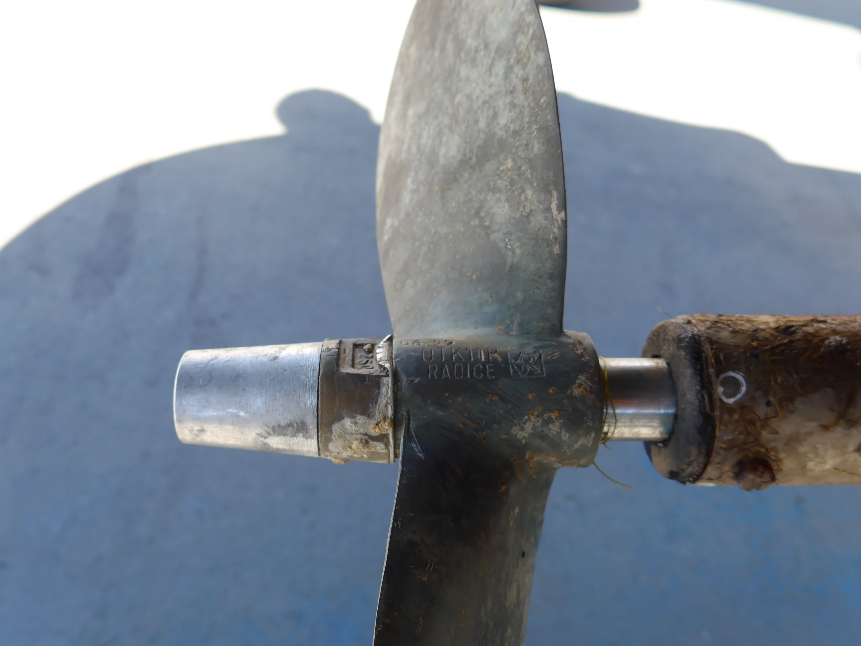

I have a 2000 Beneteau 311 which I think is the same physical boat other than the interior layout. I have a Yanmar 2GM20 engine and the prop turns clockwise in forward, just as @arf145 mentioned above.
Here are a couple of reference photos of my prop. Sort of hard to read the info, but might help.
