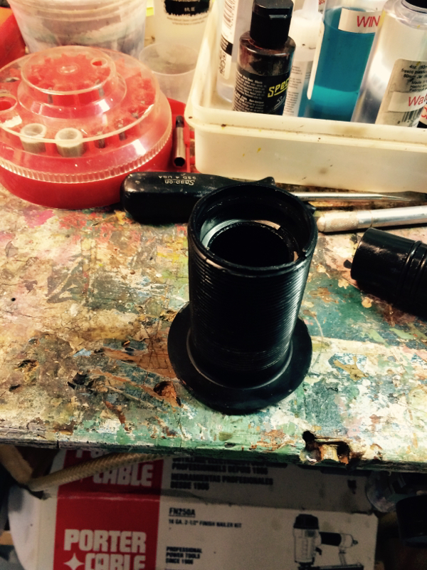

Last season end however I could not stop the dripping and when I went to hand tighten more the WHOLE house rotated! Of course the housing should nicely and securely bedded. So the yard pulled me sooner as water was slowly coming in.
Replace the whole assembly and found it was bedded in RTV silicon. Basically window chalk that is like rubber cement and never hardens. I could peel off with my fingers. So replace with tried and true 5200.

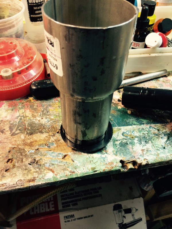

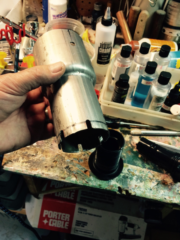

Did make a nice tool I was proud of to loosen the lock nut that is hard to get to with the housing around the depth and speed. Worked great.

Some shots of the tool to loosen stubborn transducer plastic 6 point nuts. Only used to hand tighten the new one as you can over torque.
