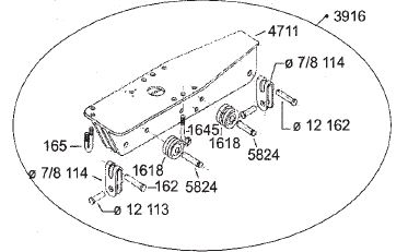

Based on a masthead 'parts list' illustration...which I assume is the one I have (yet to be confirmed)...there are several holes on either side. It looks like possibly a block could be installed externally here. Extrernal safety line could then be routed.

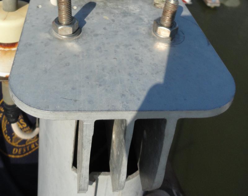

I forget what year Dougs 323 is but my 2006 has a Perko steaming light that the lens come off with 2 screws from the front. I hope while you were at the top you took pics for future refernece.. I hoisted a guy to put an LED in my anchor light, but he could not get high enough to take pics. I wondered if there were two sheeves on the front of the masthead that could handle another line or two.

I did take many pictures. When my boat was rigged at purchase...for whatever reason, no sheaves were installed in the forward part of the masthead. Picture is attached, and this is a 2004 B323. As I mentioned before...I have since installed a couple sheaves...and also run another 3/8" line to use as a safety line for future trips up.
