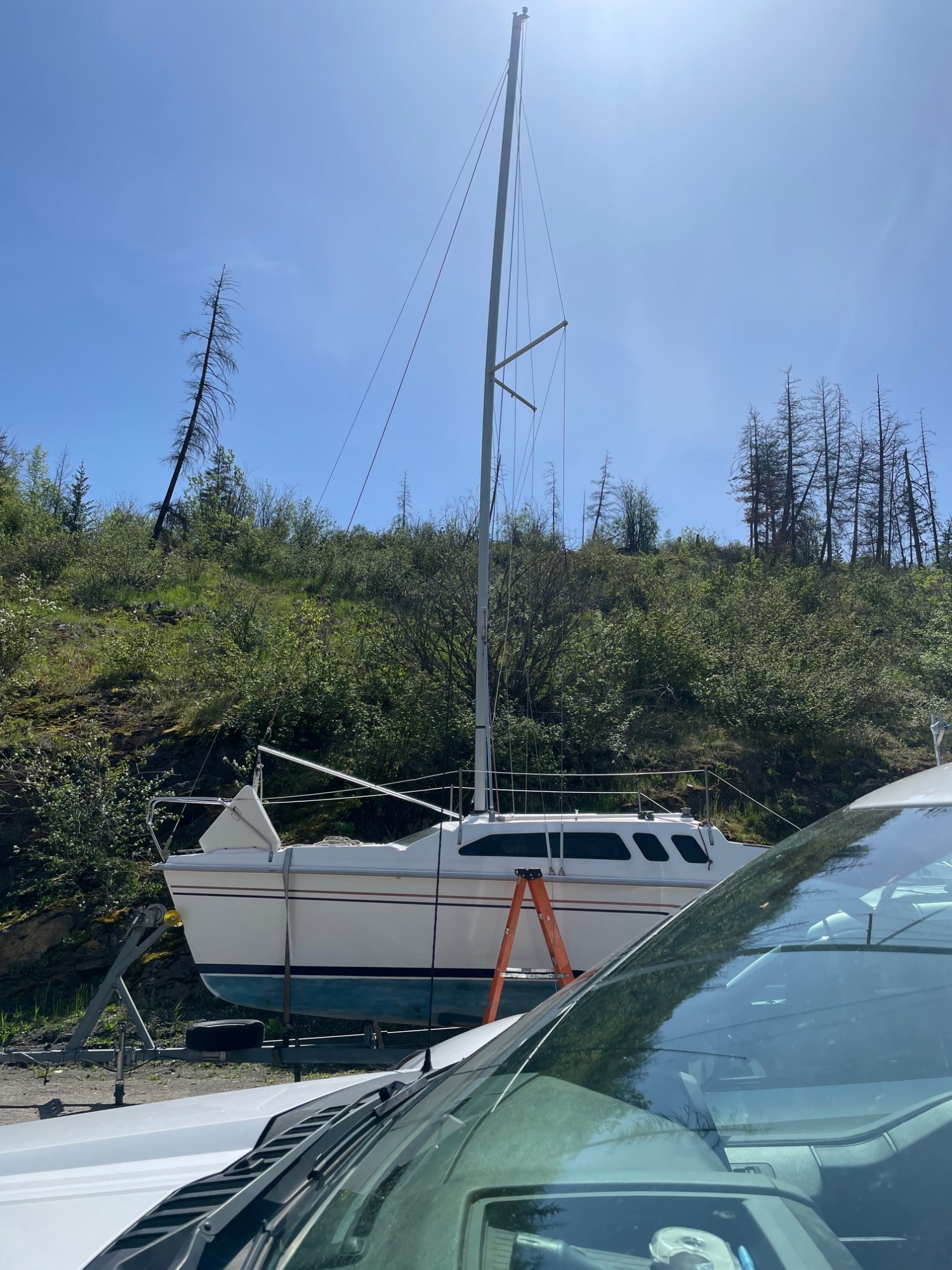

This pre-bend is likely too much but I can see it basically includes the entire mast centered around the spreaders for sure. Not too much time to spend on the vessel this weekend. Every time I drive by her it no longer looks fast, just wrong now LOL :)

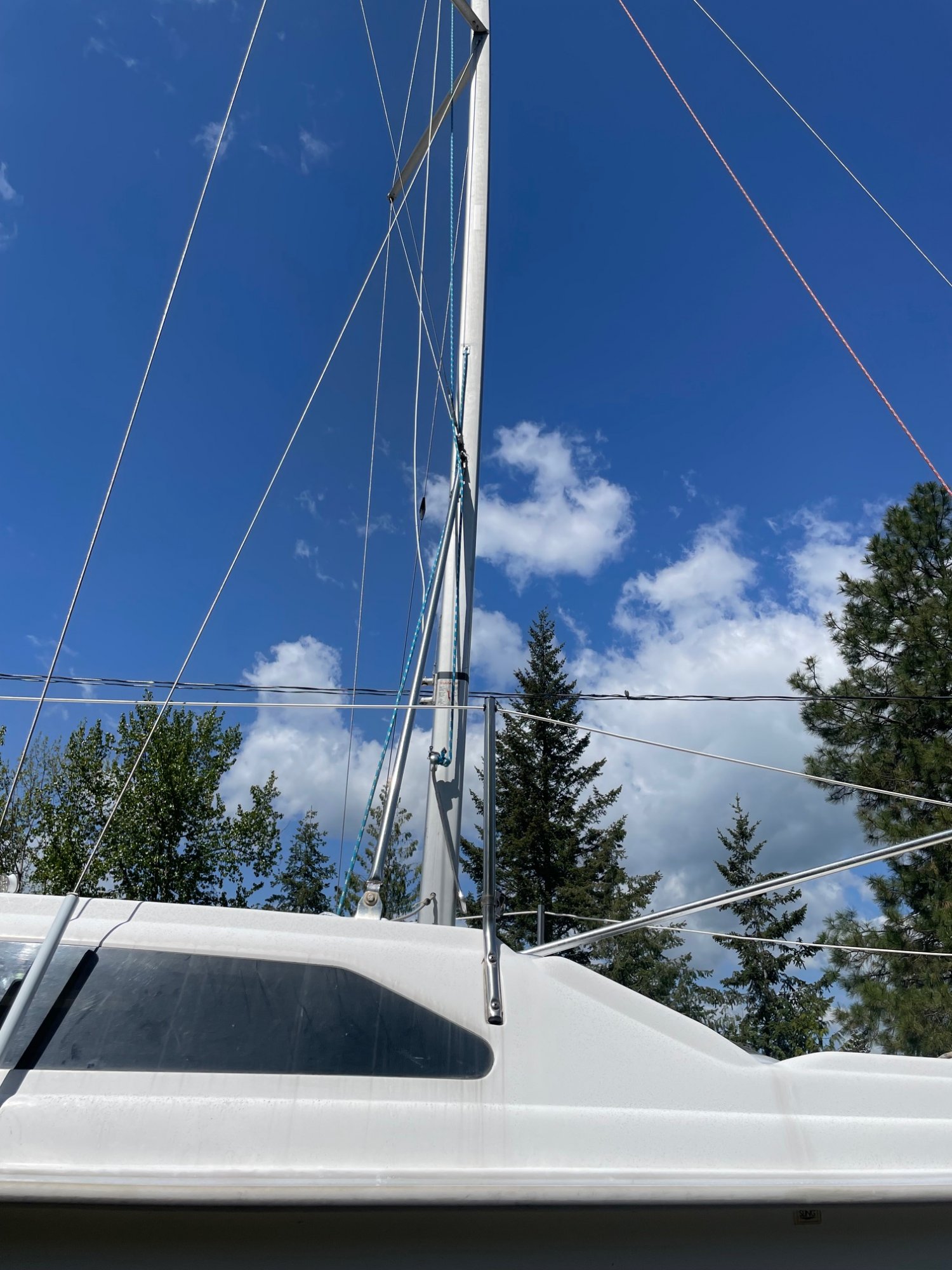

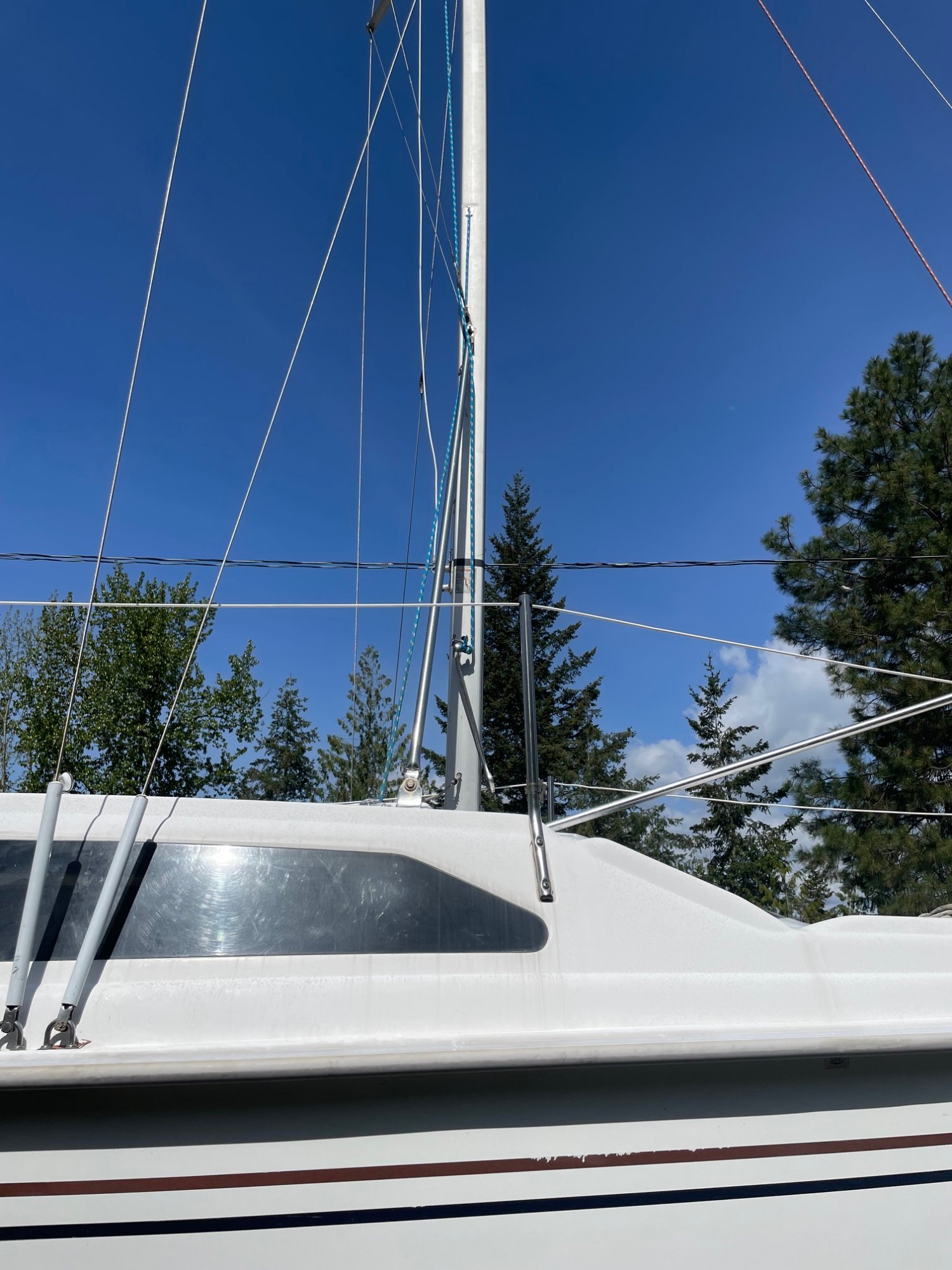

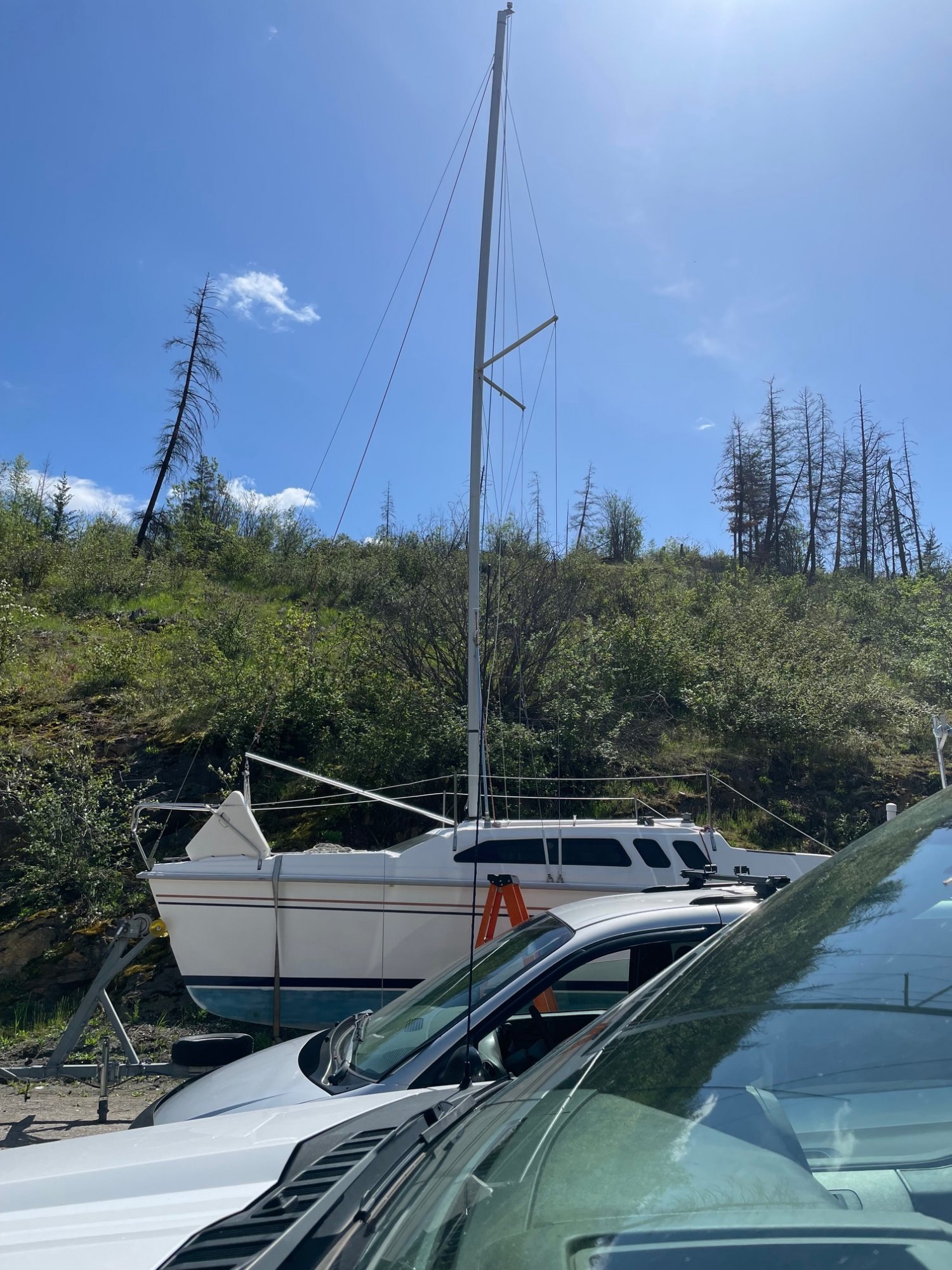

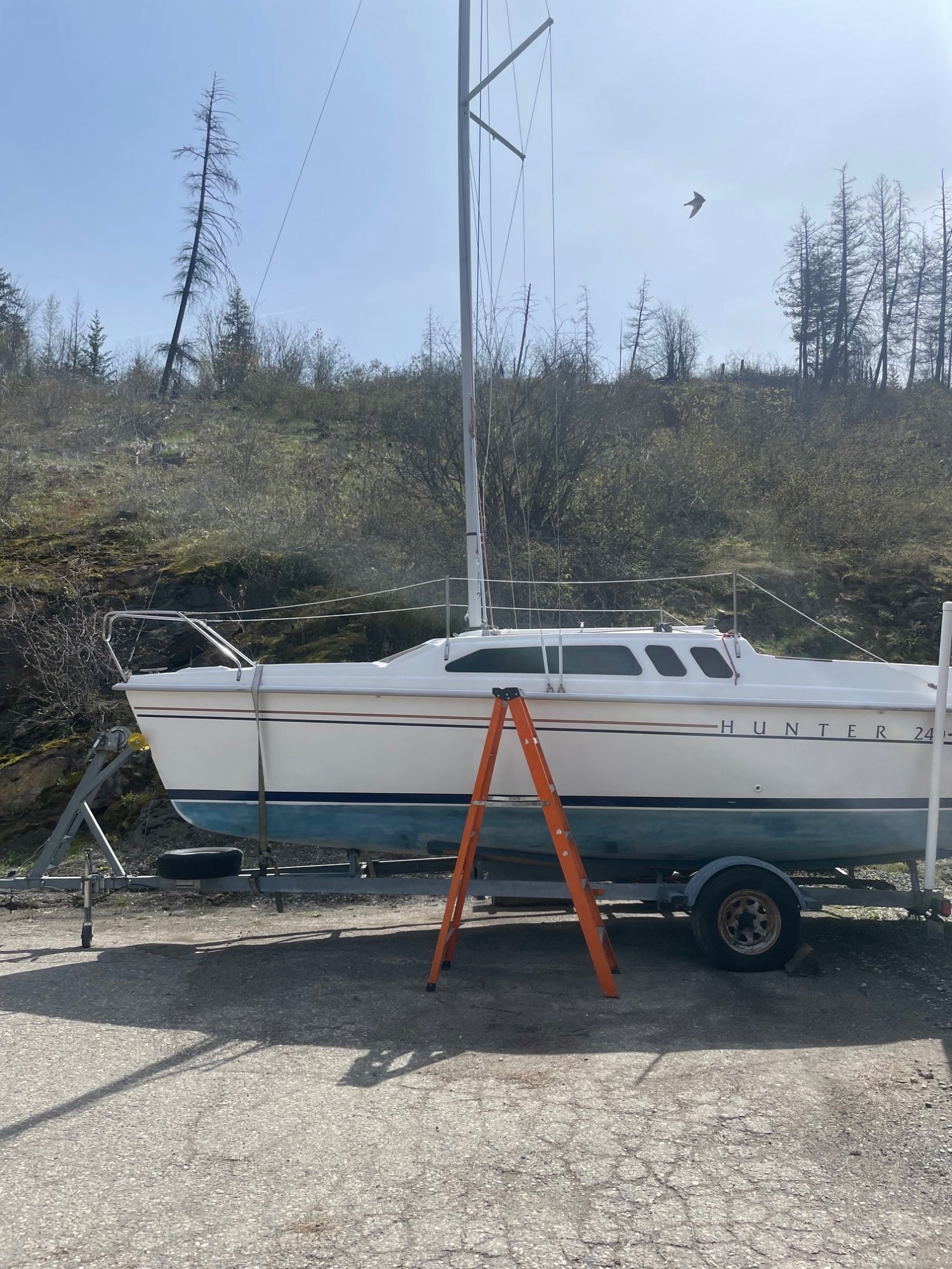

I managed to get a bit of time on her today. I loosened the forestay to the maximum length then proceeded to tighten the side shrouds. I only tightened D1 to 10% and V1 tightened only to about 5%. I can see the mast has to go even further back yet.
I know from last year trying to hook my forestay up, it was too tight. I measured the length, it is 3 inches shorter than the stock forestay. I was able to get the stock length from the manual. I didn't know that I had to loosen the side shrouds too. It was then that I decided to tune this rig and try and learn more. I now know I definitely need a longer forestay. This one is still like new. I am considering a forestay extension plate?

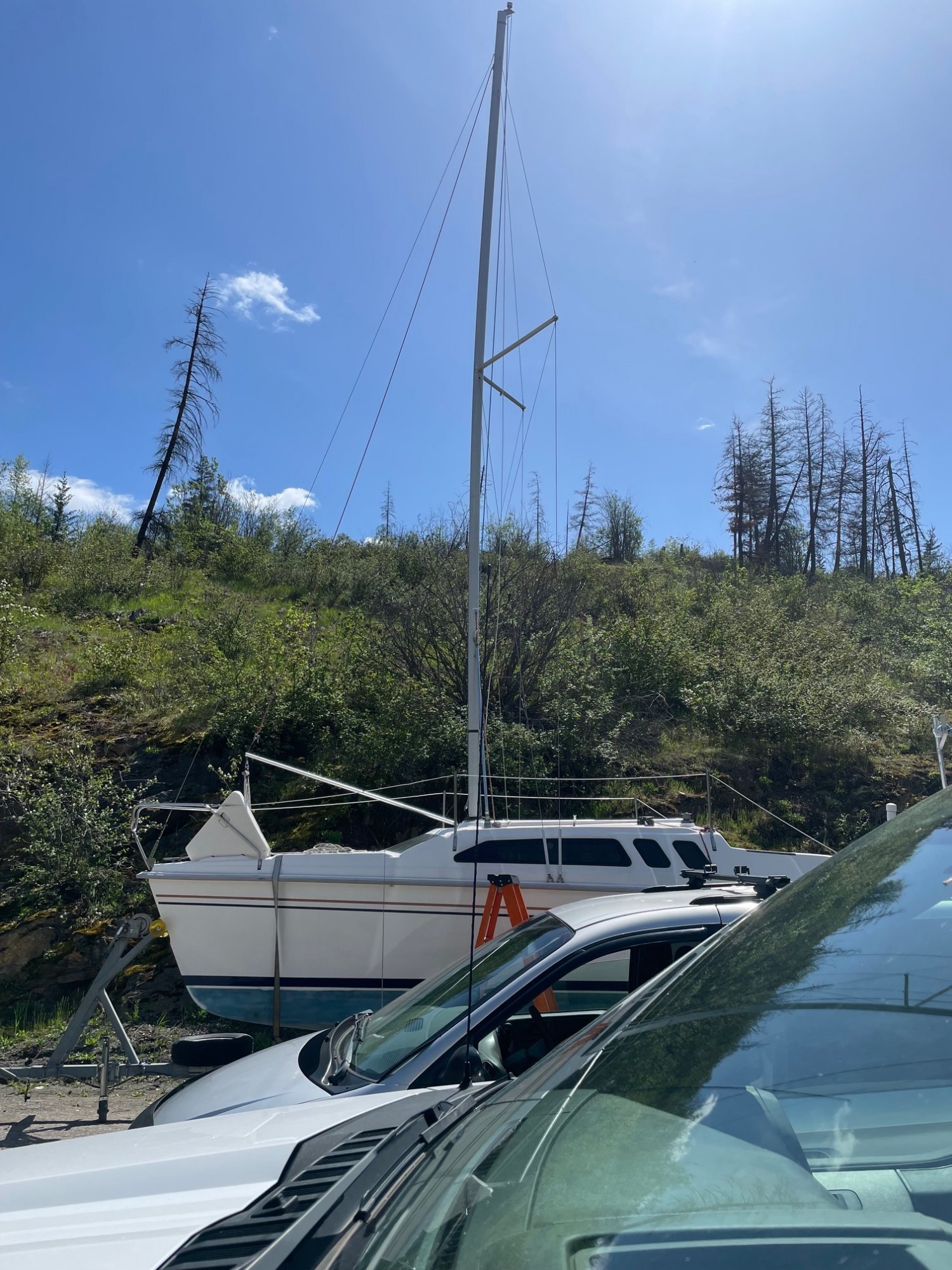

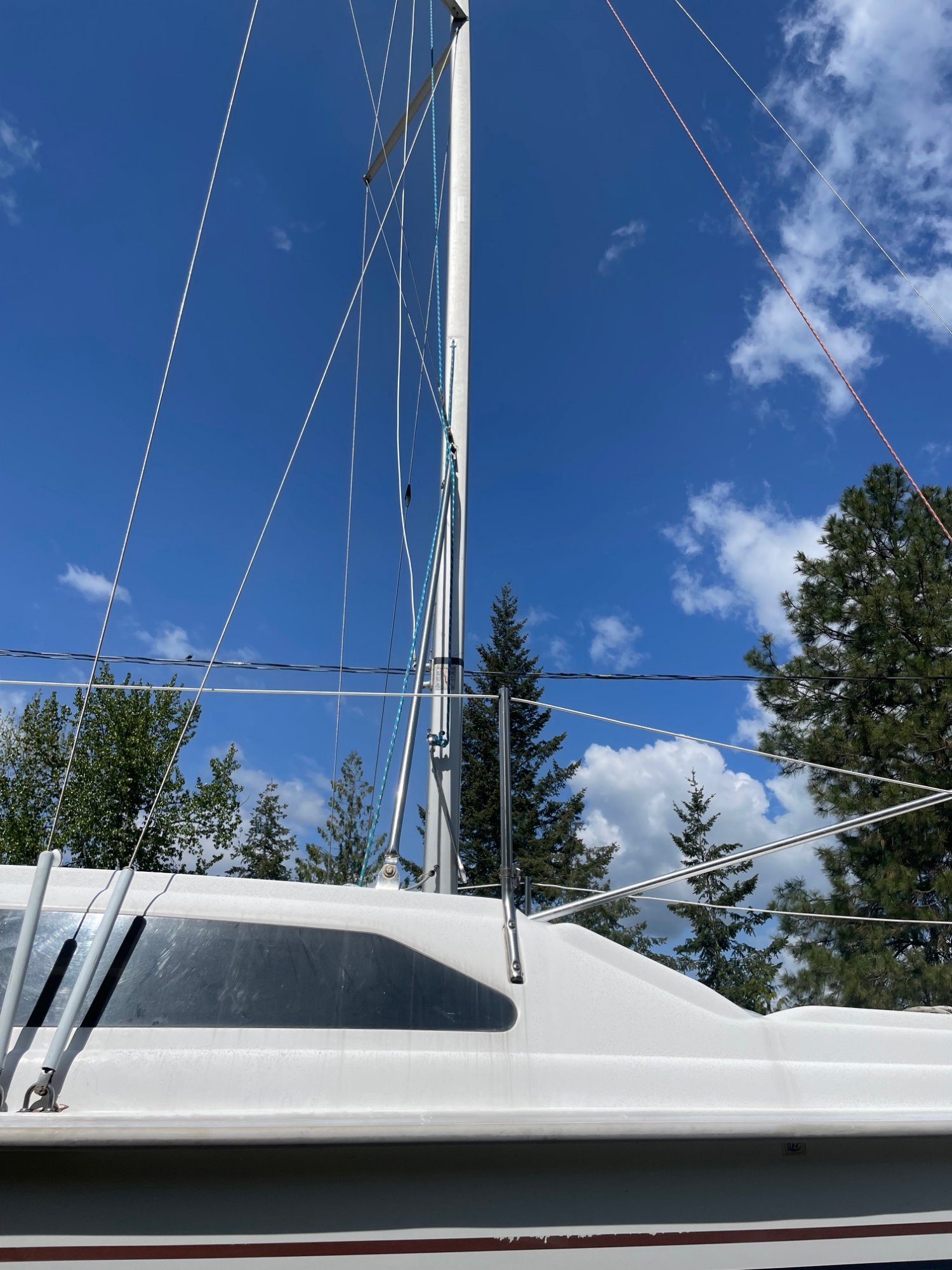

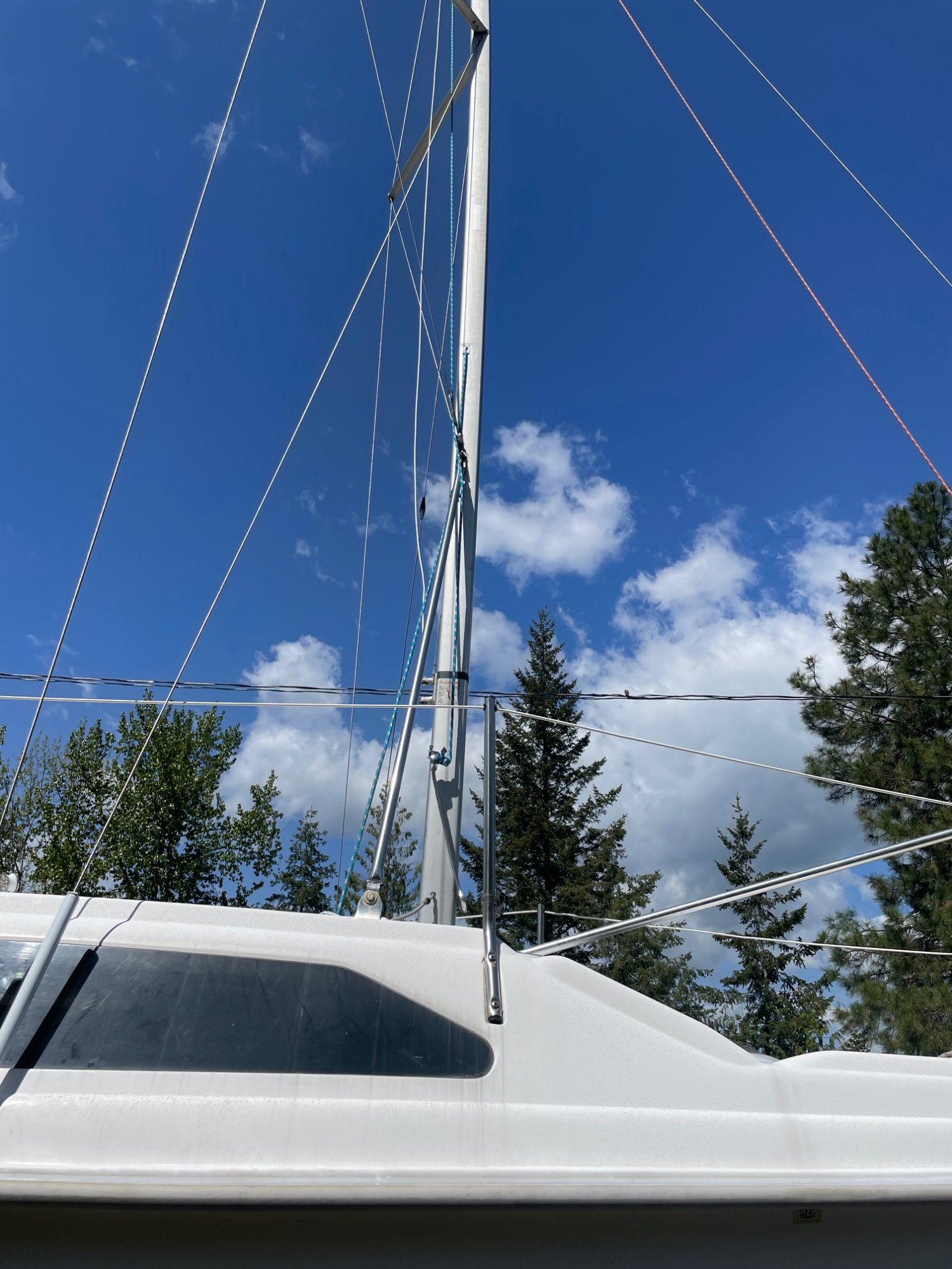

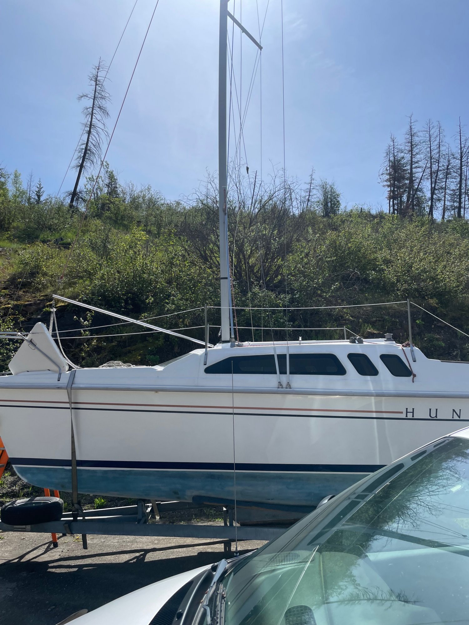

I received the extension and I was able to hook it up today. In the pictures below, the forestay has been extended 3 inches. The side shrouds have been tightened to 10% and 8%, the forestay is only roughly 5%. I was surprised by the amount of torque required to set the tension. I was happy with this for testing purposes.
I think the mast needs to go back a bit more. The picture of the port side looks a bit better as I can get further away from the vessel. The starboard side I am quite close. It makes it look like I definitely have to pull the mast further aft?

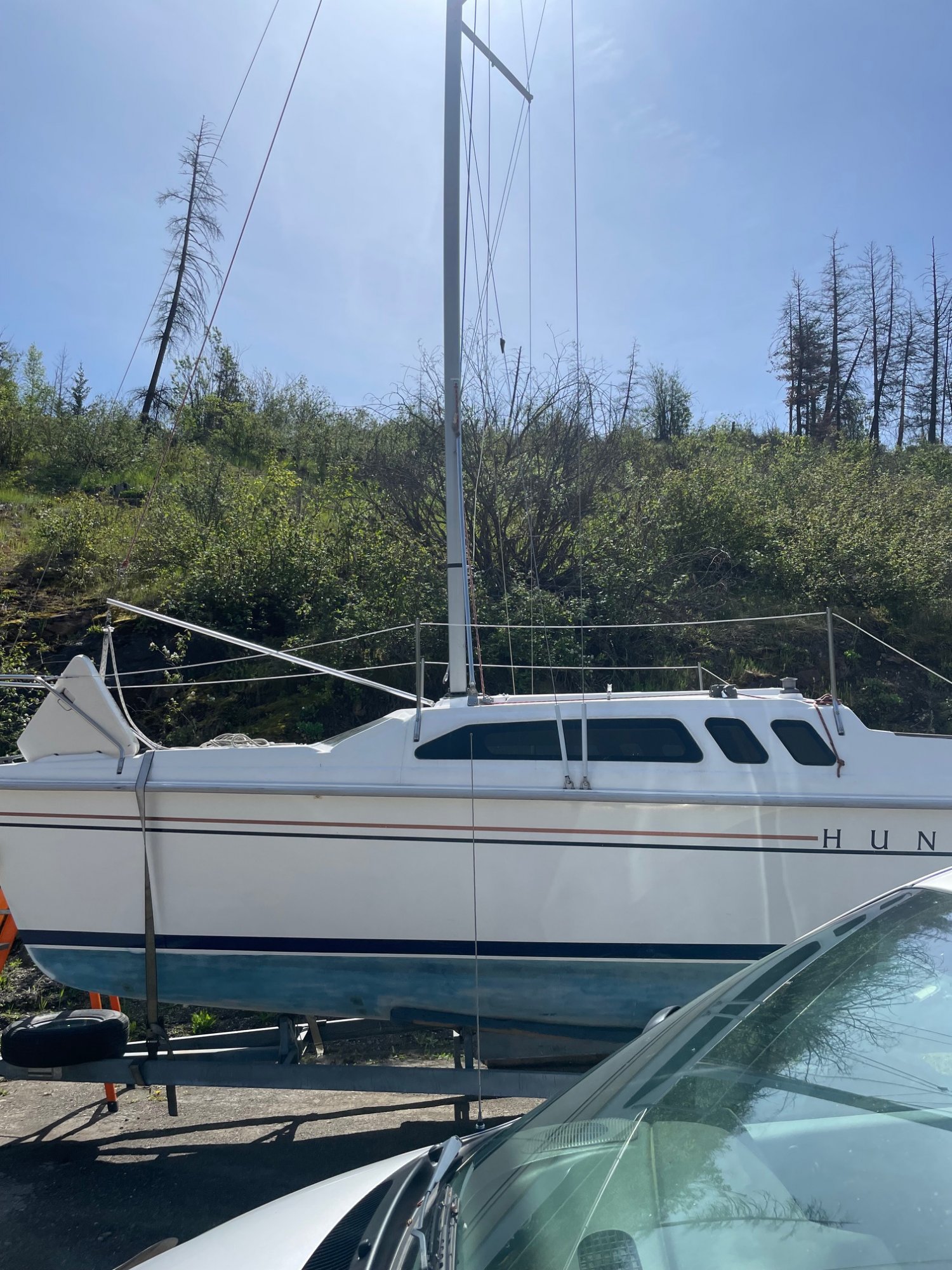

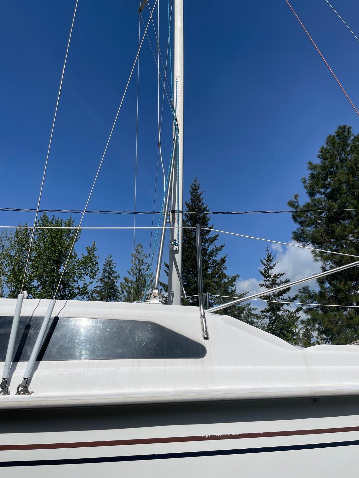

These pictures are with a 4 inch extension and 10% on shrouds with a lighter forestay tension 4 ish% which you can see.
I think this is ok. Once I tighten everything to spec. (tighten the forestay)
Ultimately I would love to go 5 inches as the stay extender would fit much better I'm not sure I have the adjustment room on one of the side shrouds. I will check athwartship (jib halyard side to side) again once I'm happy.

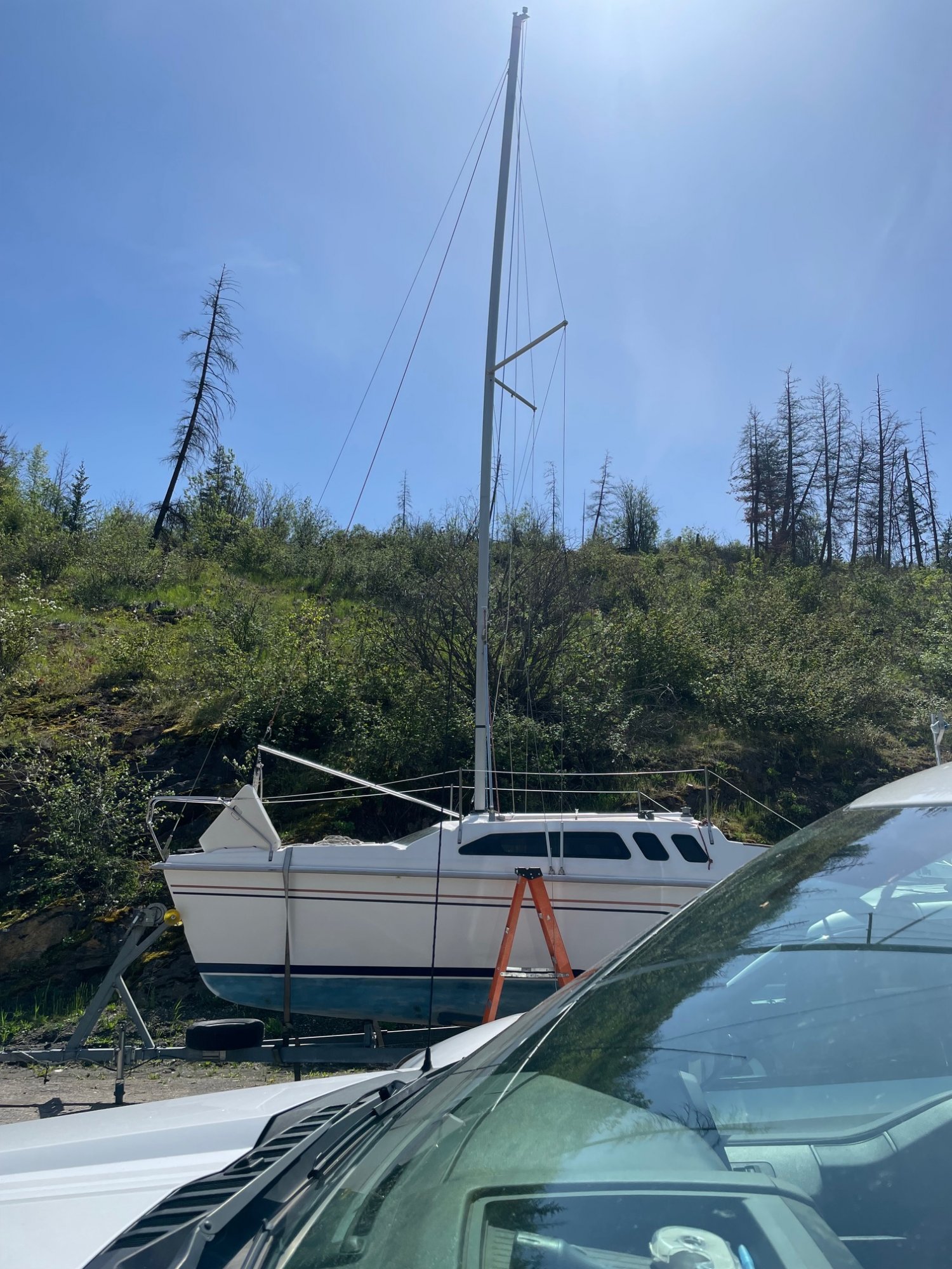

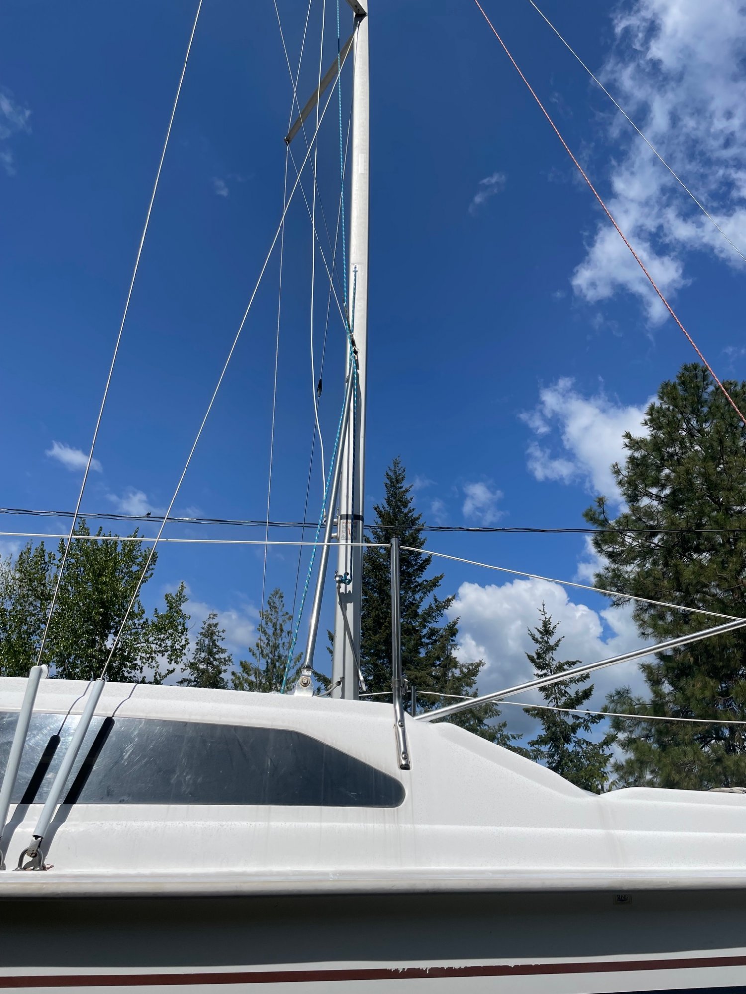

Last one, this one went together quite nicely. 10% on all shrouds and just shy of 8% on the forestay. I like this one but I'm surprised by achieving a tighter forestay how it makes it look straighter than the 4 inch.
I'm happy with this 5 inch extension ( 2 inches longer than the stock forestay) and the stays are tight enough to check final under sail.
Thoughts?

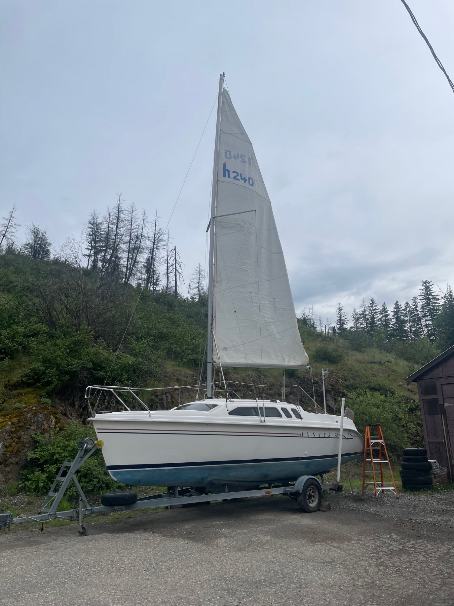

I hoisted the main today; first time I've seen it lol. I'm pretty sure I can see a whole lot of rake aft. I have likely put back all kinds of weather helm in her. At least it's a simpler adjustment now.
I'm getting close to taking her out.
Maybe, maybe not. That’s why you need to splash her and go sailing. See what you got. Let her take on her true form. Sitting in the water is different than sitting on the trailer. Who knows she maybe just about right.
Take her out in a fresh breeze and do some repetitive tacking. Feel the windward and leeward shrouds. Are they keeping the mast in column? Can you tack up wind within 90 degrees or are you just going back and forth? Use both foresail and main.
