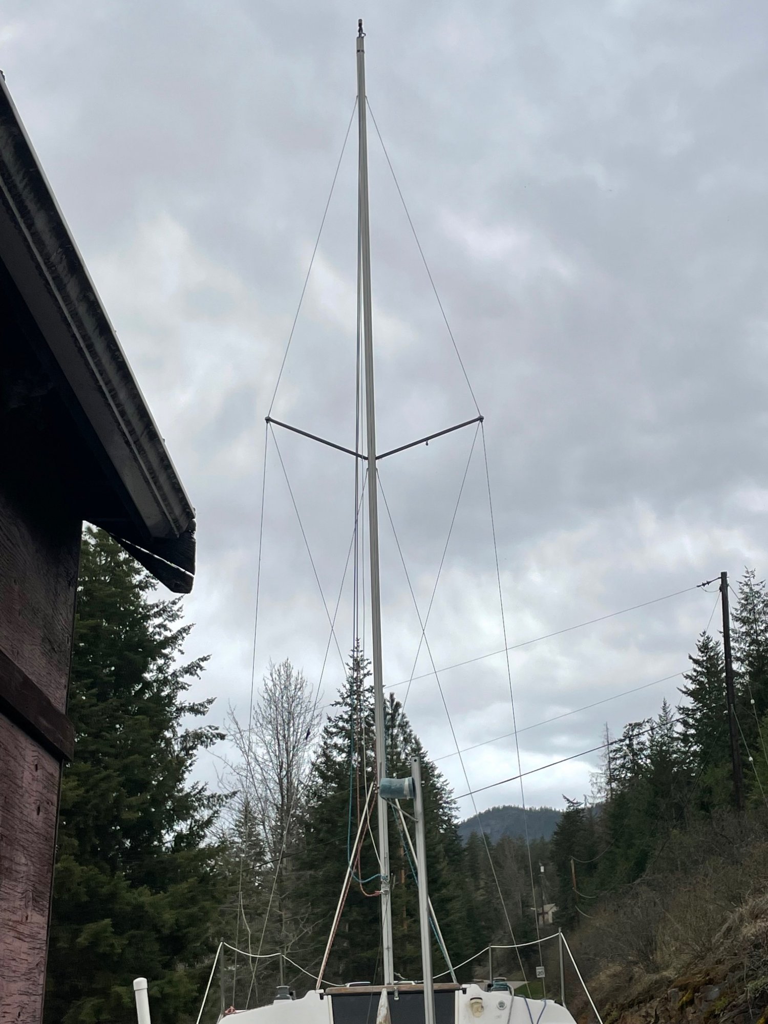

OK, attached some open end wrenches to my halyards and was shocked to see them swing out a foot past the mast. I thought, ok this is really dependent on the vessel being level. Not so easy but I believe I got it pretty level. Both halyards are laying very very close to center. The main halyard is close to the top of the mast (of course) and very close to the bottom of the mast with a 4-5 inch ish gap from the middle of the mast to the halyard.
The jib halyard is close to the mast up top (of course) touches the mast down to just below the spreaders then starts to move ahead of the mast. At the bottom it is roughly 4-5 inches forward of the mast.

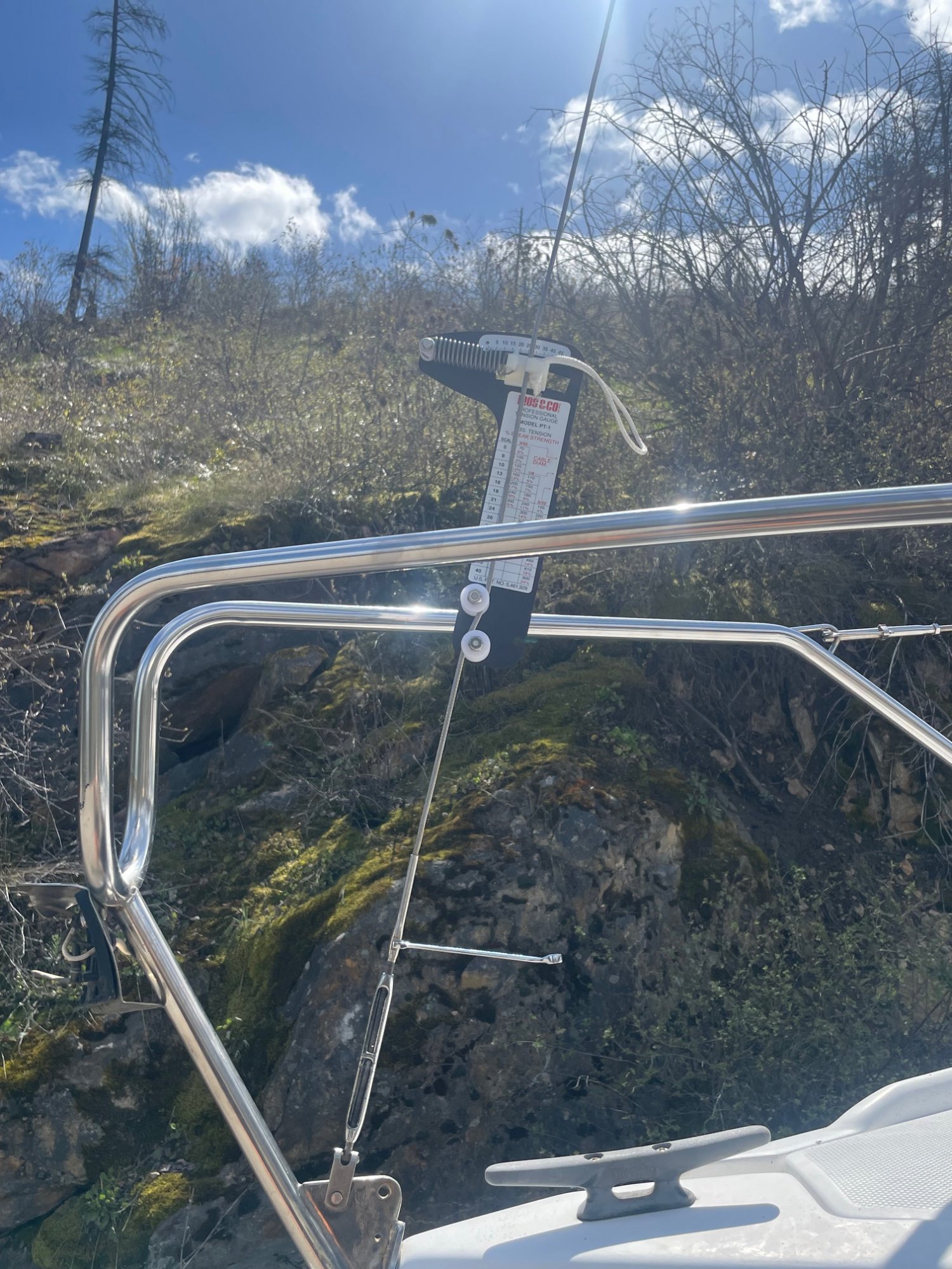

I checked all of the rigging tension. I was almost on the scale lol. I started with the forestay. I attached the Loos gauge and started tightening. With both T bolts almost touching I was still only at roughly 3-4%. I checked the shrouds too make sure I wasn't going too tight again, roughly 10% ish. I am going to wait until I get advice re D1 or V1 tightening options (post #9) as I don't want to over tighten anything. Chances are I will have to back off the forestay before I tighten the shrouds up.
I am hoping for some advice guidance now.
Now I want to: tighten D1 to 10% then check forestay and set to 10-12% (checking D1 again likely loosening back to 10%.
Then set V1 to 10% and check all again.

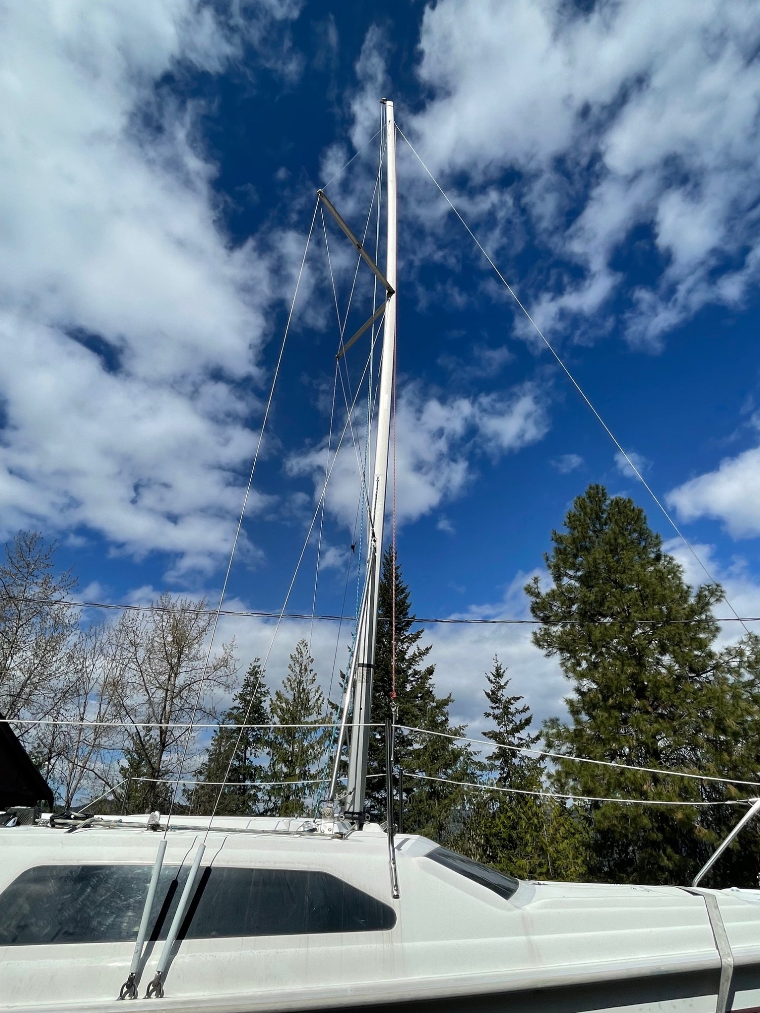

Does the camera mess with perspective, or is your mast actually raked forward? You don't want that.
Mark
23,755
This is a fact that is valid for all boats.
Ease the forestay. That will allow you to increase the aft shrouds.
This is a balancing act. You want the mast to be “In-Column” and with a slight prebend aft of center. It is important to achieve the correct shape even if the numbers are not exact on your loos gauge.
Try sailing then adjust as needed.

That’s her, standing tall. I took another picture from the other side tonight. The mast follows the lines of the manufacturers formed deck/plates.

So maybe I am looking at this wrong. I see the forward lean in the mast and the forward leaning seat the mast sits on. Makes it look fast. I’m thinking if I achieve the right tensions, I will have to shim the base as there will surely be a gap :)
If I look at the hanging weighted main halyard. I would have to say it looks much better. Changing my thinking to yes perhaps I can achieve a few degrees of aft rake adjusting the tensions.
How/what/where are you guys looking at?

This picture. It looks raked forward, but that might just be perspective.

I don't understand your comment about the halyard being over the rudder. The halyard comes down the side of the mast - no?
I looked at images of Hunter 240's, and they all had varying degrees of prebend and rake, but none of them were raked forward. At most, it was plumb.
But I would probably expect that if these boats have their masts regularly removed and restepped.
Mark
23,755
I’m looking at the vertical angle of the mast plus the bend. When the middle bend is ahead of vertical there is too much. Releasing the forestay and adding a little to the aft shrouds would provide balance. The mast is intended to be in column with a bit of “pre-band” to the upper third.
