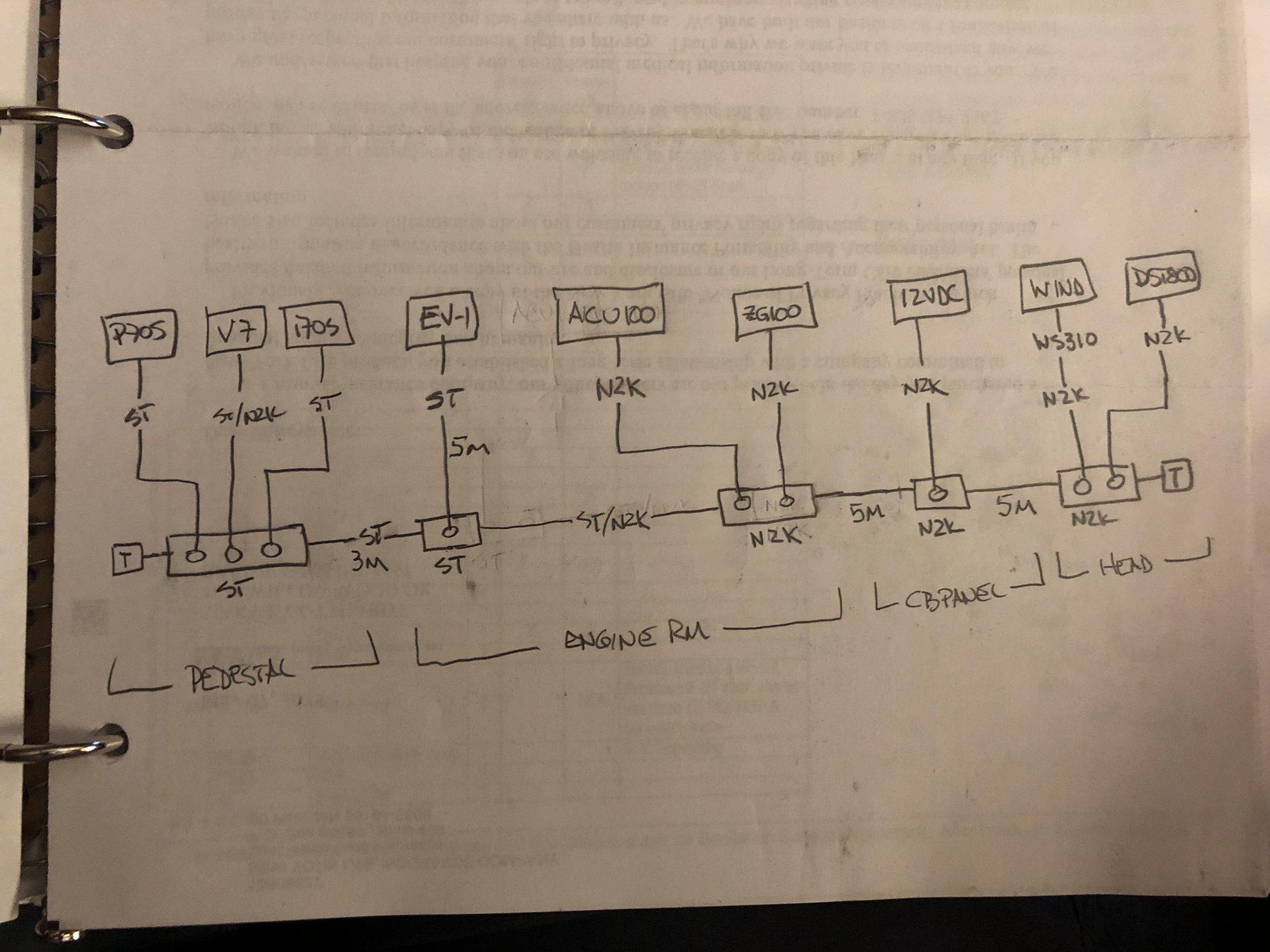

I've had my Tartan 33R for a little over a year now and the wind instrumentation has worked well until it quit during my last sail a few days ago. At the dock today I turned on the instrumentation and the wind data was back .... for a very short time.
As I understand it, the WS310 masthead transducer sends NEMA0183 data down the mast cable where's it's then connected to an interface cable. My interface cable is marked 032-25127-02, but I believe another number for it may be 000-14389-001. The interface cable has an integral electronics module which converts the data to NMEA2000. The N2K end of the interface cable is connected to a dual port tee. The other port is connected to the knot/depth transducer, which is working just fine. I inspected all of the connections and even replaced the tee. This spring I refreshed the entire NEMA2000 network with mostly new cables. I have a B&G Vulcan 7.
The mast cable has what appear to be some proprietary connectors, so it not's possible to check the NMEA0183 data lines with an LED. As best I can tell, the Vulcan 7 isn't seeing the interface cable on the N2K network, other than some artifacts from when it was working. After poking around in the source settings in the Vulcan 7 for a while, there's certainly some things that I don't fully understand. I've ordered a NavDoctor to help me analyze the N2K network activity. The path of least resistance at this point is to replace the interface cable, I've got one on order. I could be wrong, but I'm going on the theory that if the masthead transducer had failed, the interface cable should still be active on the N2K network and Vulcan 7, albeit with no wind data.
Any suggestions will be appreciated.
14,158

I finally figured out how to get to “settings/network/devices” on the V7. The WS310 is reporting OK, just no data. That leads me to believe the 0183/N2K interface cable is alive, at least on the N2K side. It’s either got to be the mast cable, masthead connectors, or the masthead transducer. I’ve got an interface cable coming, but I suspect that a trip to the top is going to be required. Is there any service out there that can repair the WS310 transducer? It would appear that they fail frequently.
14,158
If it is the transducers, it is an easy repair if you can get the part. Assuming no physical damage to the vane or cups, disable the unit by unscrewing the top (vane) side of the body and the lower (cups) side and slide the circuit board out. Put the new circuit board in and reassemble.
