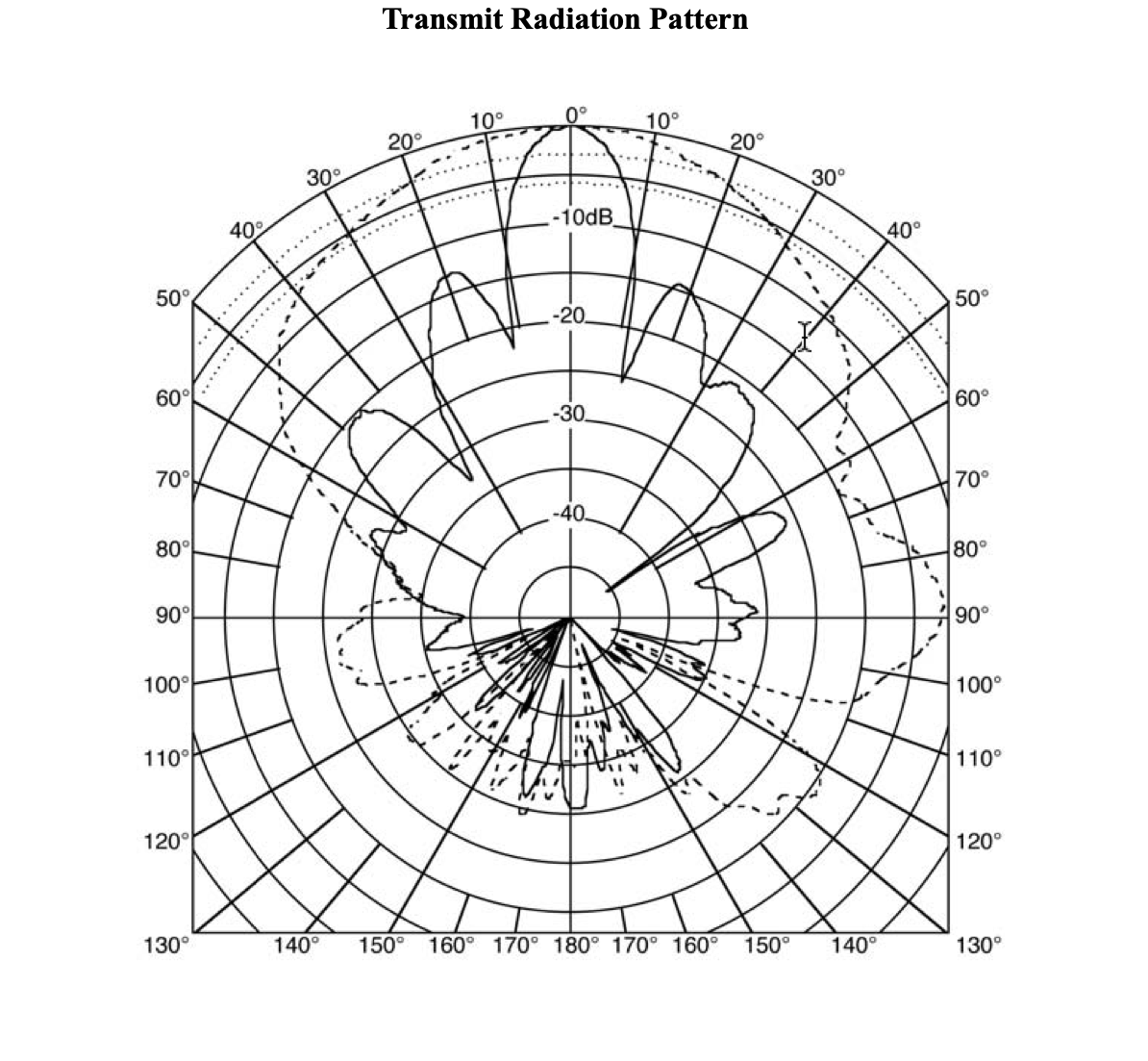

The reason we install the sonar transducer near the bow is to enable the return signal to give us information about what is immediately ahead. Here is a link to the 810's acoustic data. The acoustic pattern of the transducer gives us info on how the system can display what is ahead of us. If we go slowly and can understand the information projected by the system, we can know the dangers.

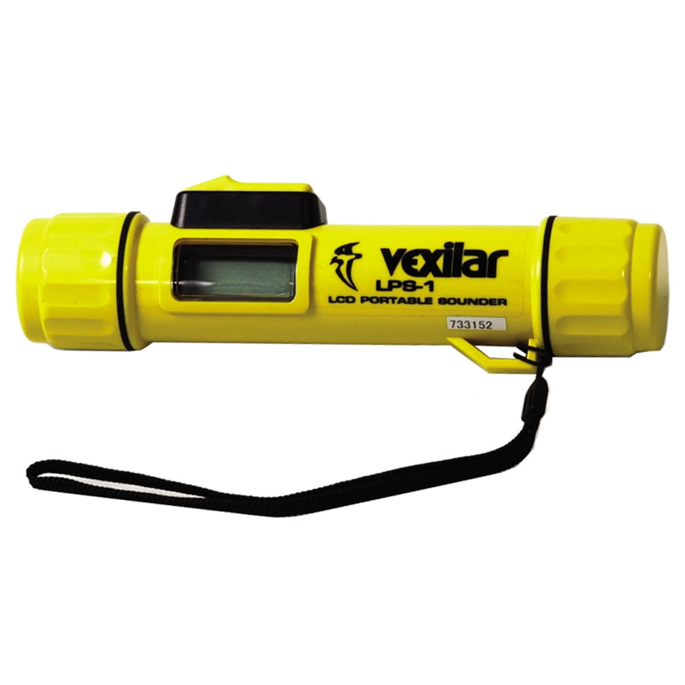

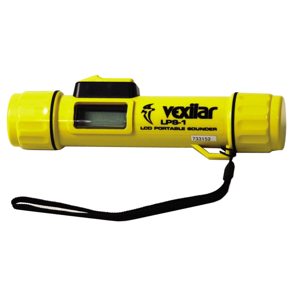

A simple and inexpensive method of entering shallow waters is to take a dinghy into an anchorage or shallow water passage and use a hand-held depth sonar to give us the necessary information.
Jan 4, 2006
7,862
Done that before but haven't bothered with the handheld sonar as the water is so cold in northern waters not a lot of small stuff grows quickly. We could quickly scope out an anchorage looking at the bottom before bringing in the mother ship.
That's the way Cook sent in the longboats to explore the coastline of BC back in the late 1700's before bringing in the mother ship. Put a hole in the big one and it's game over.

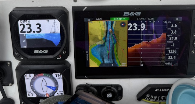

(TST810 values reported on the Triton)
Quick follow up after a summer's trip:
-The Forward Scan went into the existing blank about 6" to the side to the existing downward sonar, just fore and starboard of the keel. It did get faired out to be plumb (rather than the hull angle).
--I did use the supplied stainless through-hull but the B&G rep says that that is not absolutely necessary. Because the FS pokes down a bit more than an inch the stainless is structurally better if you hit a dead-head.
-It was plug and play into the Zeus3 with an additional 10' extension to the supplied longer cable. No sonar hub needed. (Rep said that beyond that distance you "might" need a Sonar Hub to amplify the signal.)
-Power consumption is not huge--but we did put it in standby when not using it.
-It seems to provide nearly equal values, compared to the DST810, even at hull speed (7kt), BUT:
>at depths >90-100' it totally freaks out. It has no idea what the depth is, regardless of speed. At depths <90'-100' the values suddenly match the DST within a foot.
>the "look ahead" gets pretty flaky about 50-70' out, even in deeper water. Beyond that distance, the graph changes so quickly and wildly it isn't really usable.
-It was a great extra bit of data when poking into those small coves and especially navigating narrow channels at low tide. It did point out some dangers, but I don't think it changed my behavior appreciably. It did keep my blood pressure and heart rate a little lower.
-I would do it again. But I also make a lead-line dLj. The lead-line was great for confirming depths under the spade rudder after we had backed in.
