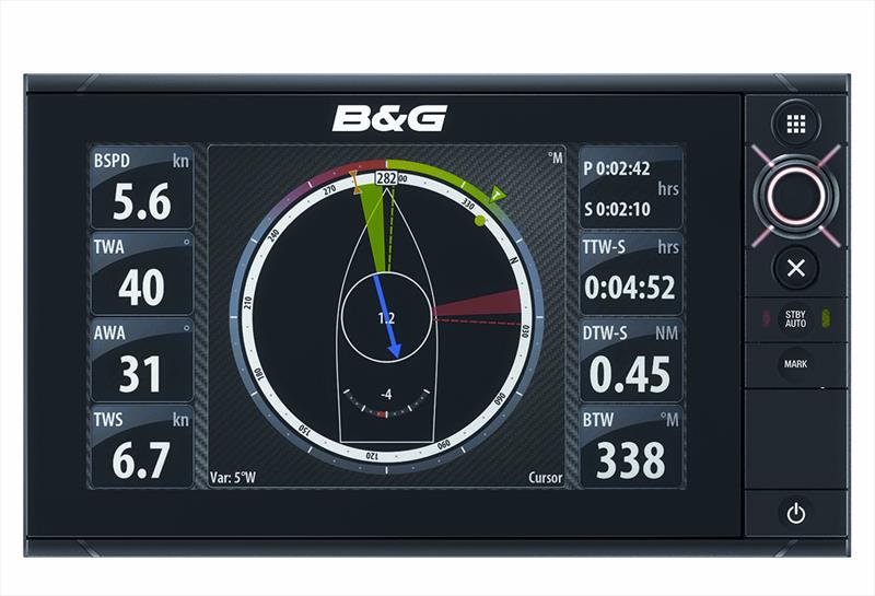

Is it still possible to connect an iPad to previous generations of the B&G Zeus chartplotters?
I have a Zeus 2 with an external WiFi module, and in the past, I have been able to connect my iPad to the chart plotter. First with the GoFree app, then with the Link app, but now I am unable to connect the two devices. I have checked the B&G support site for software updates, and it looks like I am up to date based on what is available for the Zeus 2. The Link app is still seems to be available on the Apple App Store, but there is also a B&G Companion App available as well. I found a compatibility chart which indicates that it is compatible with an external WiFi installed, which I have, but I cannot establish a connection between the two devices.
Back when my systems were new, I had a procedure to follow which rebooted and reset the entire Zeus system, but I haven't been able to find those notes, and the only "Reset" that I can find in the install or operators manuals just seems to reset subsystems within the Zeus to factory default values. Any help or insights would be much appreciated.

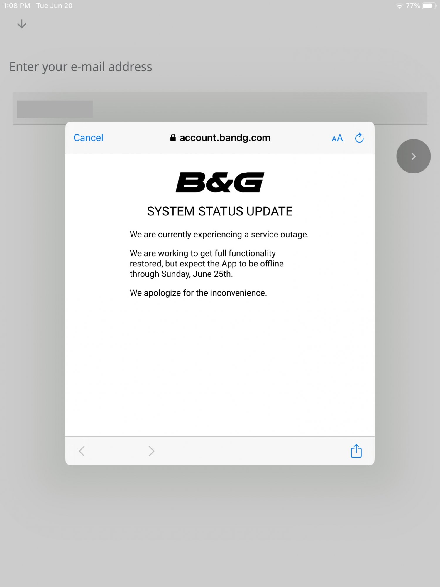

…I have such awful luck getting support from B&G…
To clarify my comment about software updates, my Zeus 2 is up to date per the downloads page at ver. 18.3, but there is a note regarding the new companion app which says that it requires a version above 20. Have they just continued to develop chartplotter software and kept backward compatibility with some prior generations (like the Zeus 2)? If so, how do you find the most recent version?
Whatever the case, it doesn’t look like it’s going to be resolved this week…
