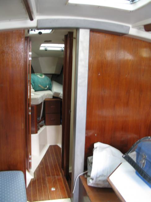

This summer I purchase my first sailboat; a 1984 Hunter 34. While in the process of documenting all the work I need to complete I noticed that none of the lights on my mast work (Anchor, steaming or spreaders). Does anyone have suggestions for some steps I can take to begin fixing this problem without climbing the mast? FYI... The previous owner had replaced the compression post with a stainless steel support. PS. My boat was just put on stands yesterday. Can you climb the mast when it's on stands?

I think it is unlikely that all of your mast lights are burnt out or are corroded in the sockets. I would look for a common ground connection to the lights or a bad common fuse or breaker in the control panel. Do you have a wiring diagram of your boat? If not, contact Hunter and see if they can send you one. Underneath the gray ceiling panel by the compression post should be all of the mast light connections. Given a wiring diagram you could determine if power is getting to the proper wires. After disconnecting the wires you could measure the resistance of each circuit up the mast to determine if there is a good bulb and the circuit is complete. Lastly, I would not go up the mast while on the hard. And I suspect that your marina wouldn't like it either.

The wiring for the mast comes down a track at the back of the mast and at the bottom of the mast the cables go inside the mast and through the deck to the compression post. Sealant is put round the cables to stop the water ingress into the boat. It relies on the sealant being done well and often it wasn't leading to water damage to the compression post. The track at the back of the mast has a sliding aluminium cover and if you remove the plate the boom vang attaches to you should be able to get access to these cables at the bottom of the mast. You may need to shorten the cover. I used a dremel. You can then test them to see if the lights are operational using temporary wiring. If you do need to replace the connections through the deck you can fit a cable gland in front of the mast and take the cables through the deck.
