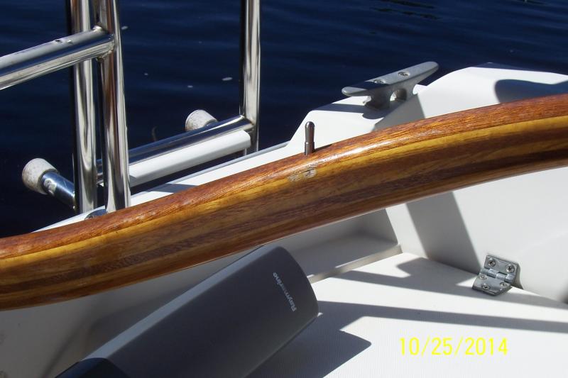

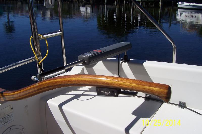

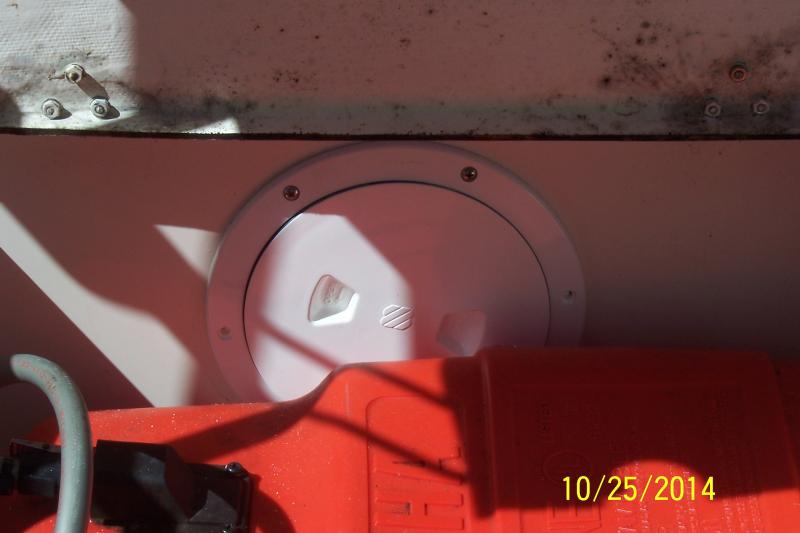

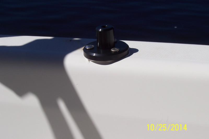

Thanks for the help. After thinking about all the advice that pointed in one direction regarding how important it is to follow the installation instructions to the letter I decided to bite the bullet. I cut an access port in the back of the gas locker so I could reach up to install a pedestal mount on the port side coaming. This enabled me to mount the S2000 at the correct height and distance.

Looks good! How well does he steer? Got him dialed in yet? I nicknamed mine Ray (Marine, that is). "Port ten degrees, Ray!" Makes me feel like a real Captain ;)
