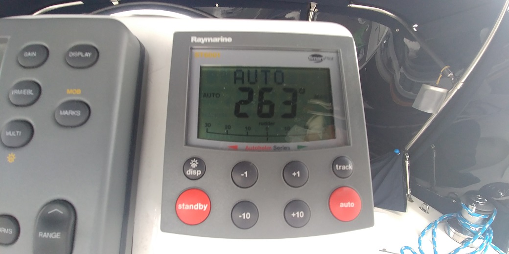

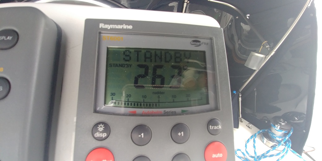

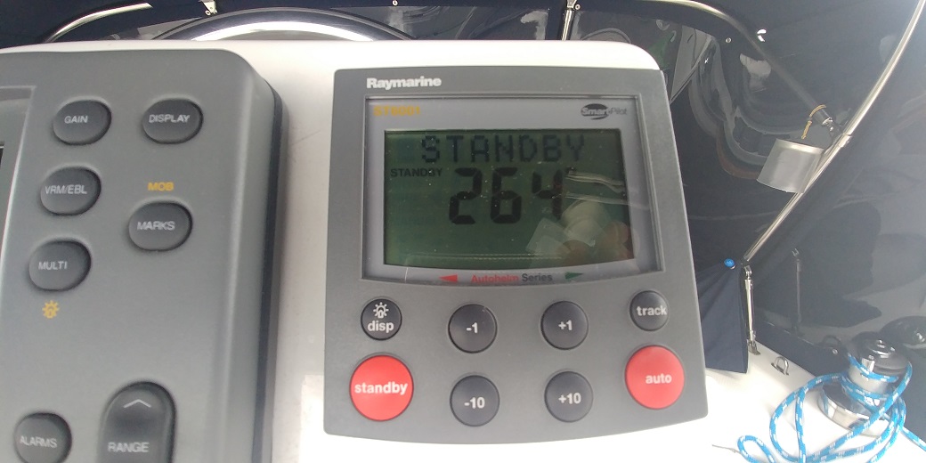

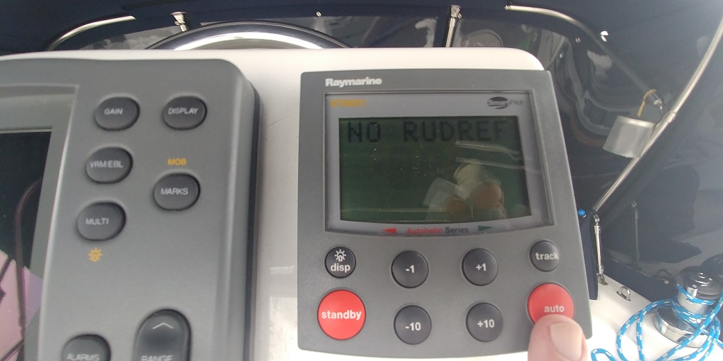

Rick,
Came across this forum trying to solve 'my problem' (similar setup ST6002 + SPX30 and on STDBY no rudder reference display, on AUTO up comes rudder reference display and seems to work show everything OK).
Have tried nearly everything (obviously not the fixer).
What 'did the trick' to solve your problem? Have read others' input to no avail.
