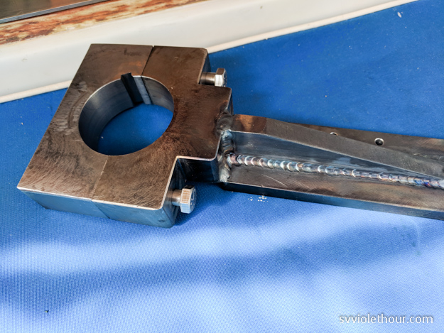

Definitely time for an autopilot on my 40 &. I had hoped to do it this winter while the boat is still on the water. However, when I looked at the rudder post I could see no keyway to secure a post. Is anybody familiar with this, could I have missed this? Seems inconceivable that a large boat could have been built w/o such a provision? There does seem to be a horizontal ledge back inside the transom for mounting the actuator.......Edson clearly states that mounting to the radial wheel is a recipe for disaster. Having to drop the rudder & having a keyway milled into it also seems like a recipe to add a thousand more into what is already an expensive proposition as it is.

Louis. The paragraph that started "Custom Tiller Arm" caught my eye.

My boat came with an Alpha 4404. It is a linear drive and the arm is simply clamped with a set screw to locate it. No keyway needed.

I think that if you can find a suitable arm from a one of the manufacturers you will save some money over having 1 fabricated.
