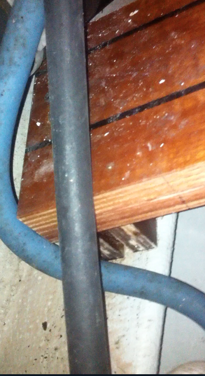

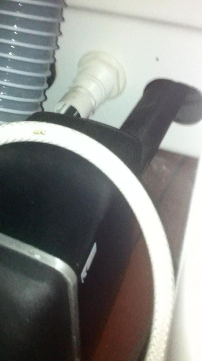

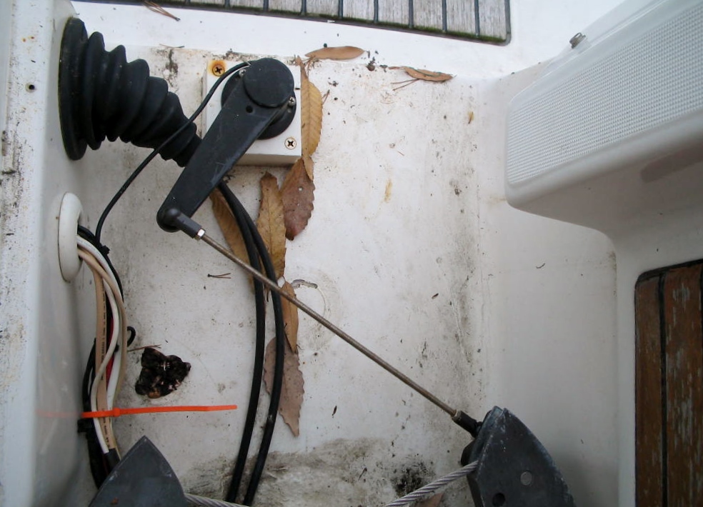

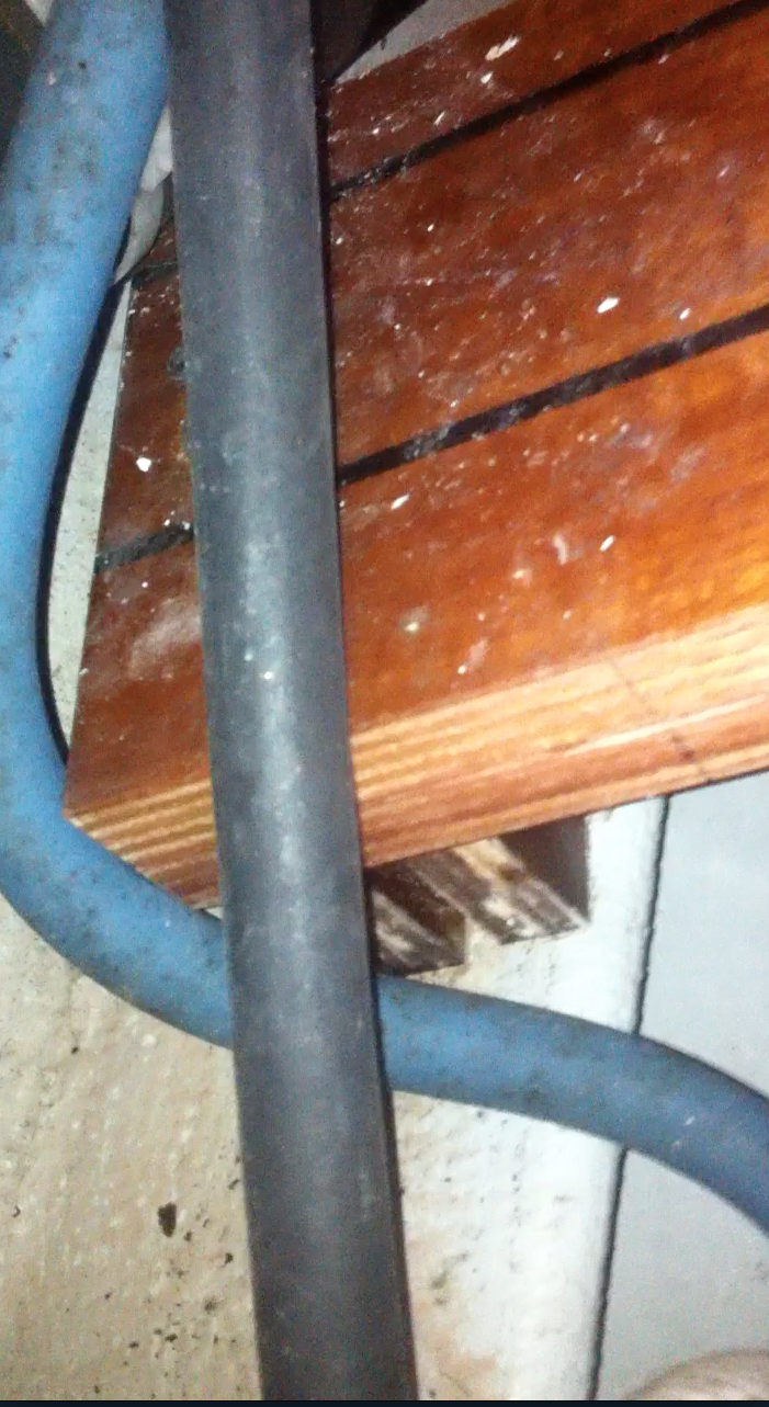

I have the same boat, and I have a mechanical linear drive. Lift the starboard cockpit seat to access the stowage compartment below. All the way to the back, you can see a fiber glass lip on the hull. You need to mount a thick piece of marine grade plywood across the gap between that lip and the fiber glass wall in the middle of the boat. Then you can install your linear drive unit to that.
The first image shows the lip on the hull, the second shows the part facing the middle of the boat. Note the hole that has been drilled to allow the drive unit to access the plate that moves the rudder.

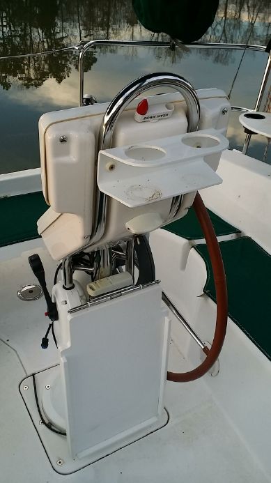

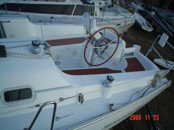

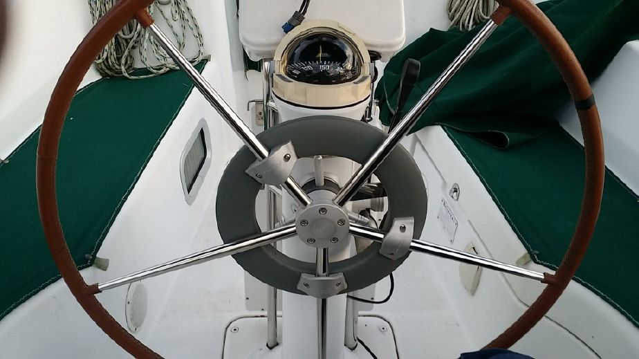

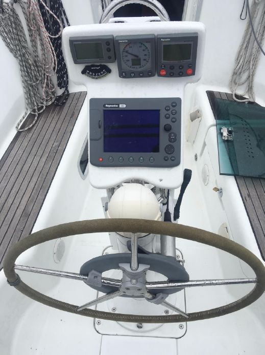

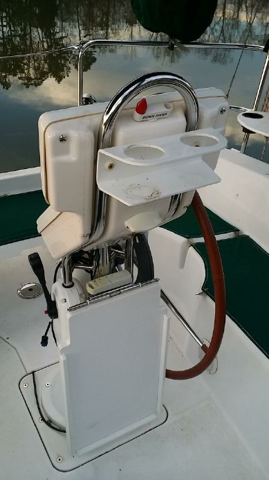

Here is a 323 with a wheel mount. You can still pivot the wheel.

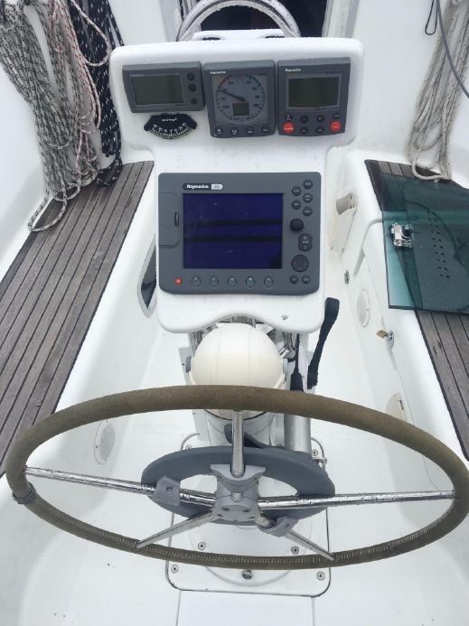

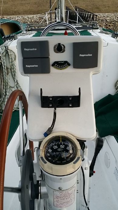

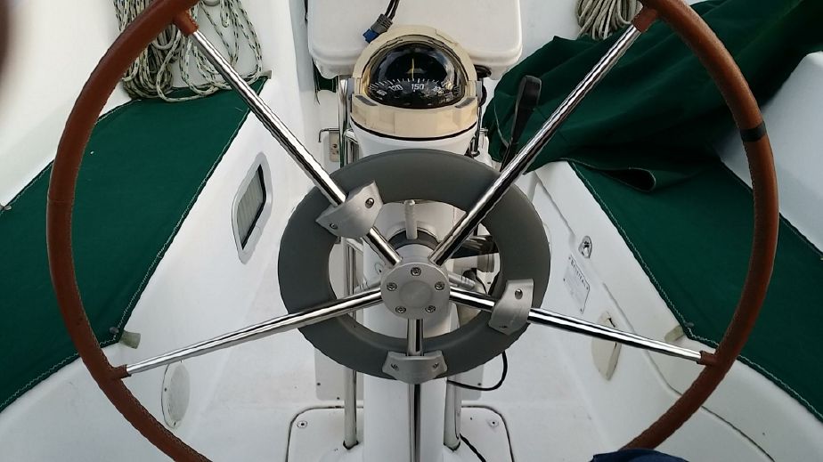

Not my boat. That was a stock photo but it looks like a EV-100. The brackets give it away.

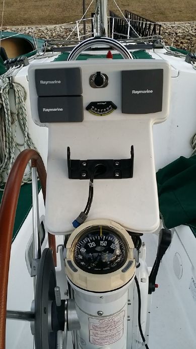

Attached is another set of stock photo's of a B323 with the EV-100 and shows the wheel in both positions.
Good Luck

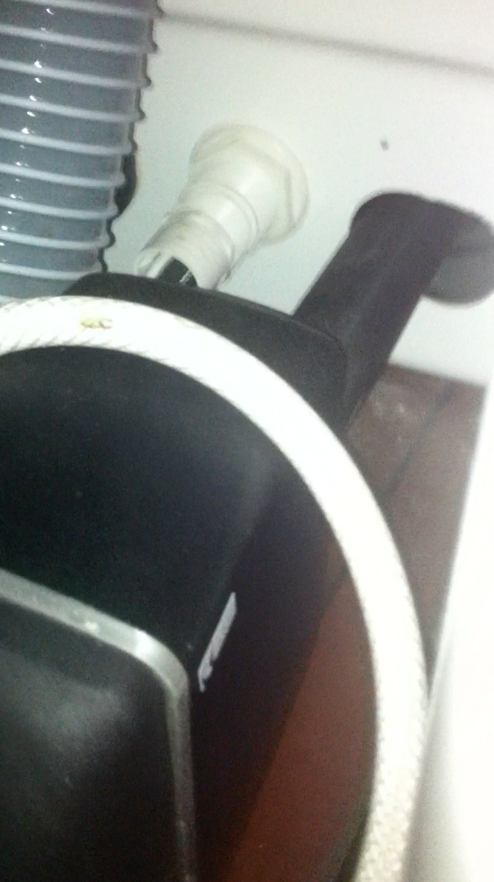

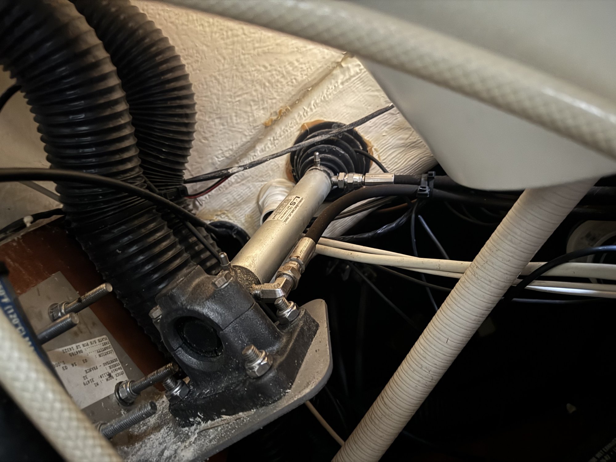

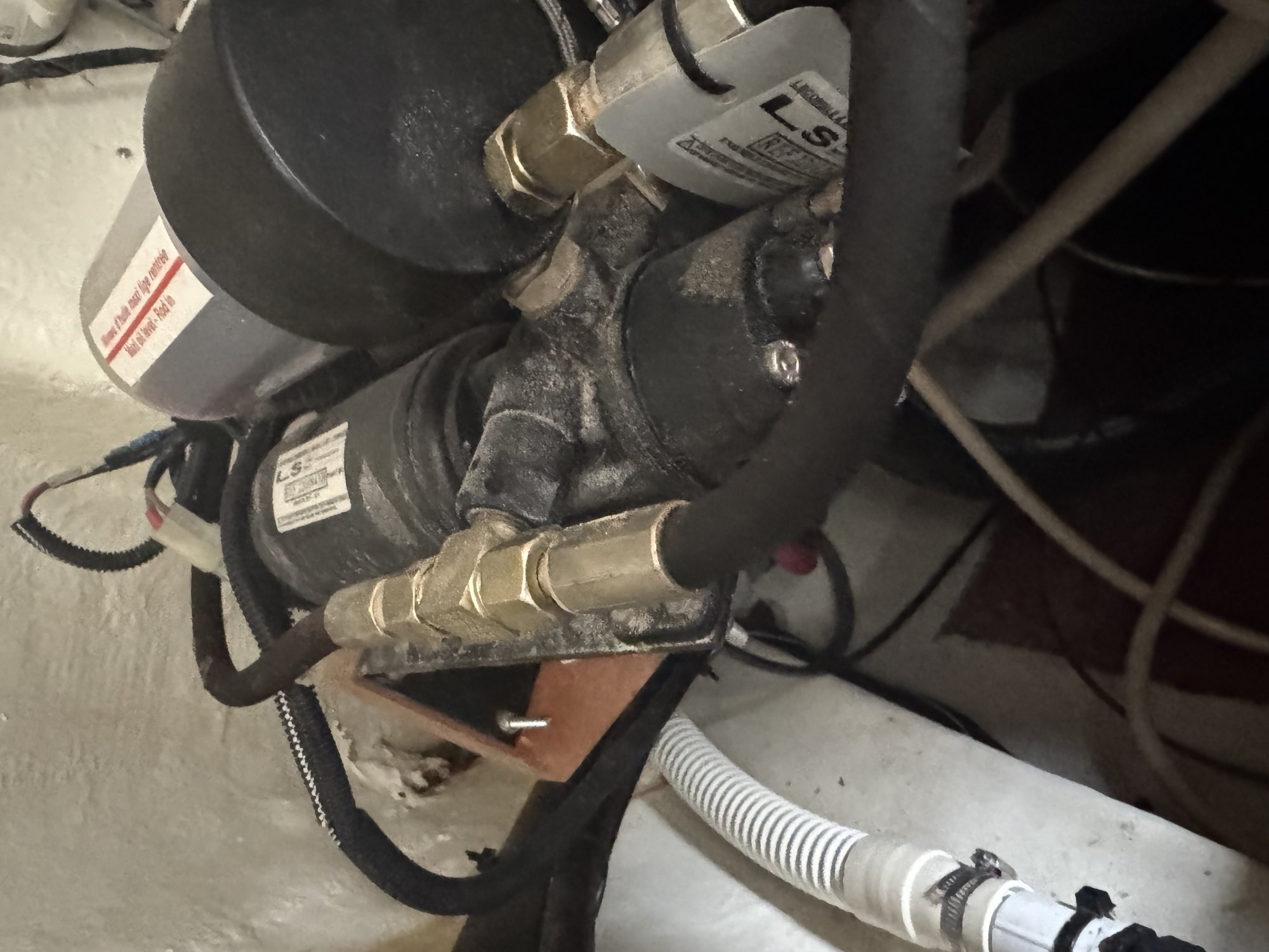

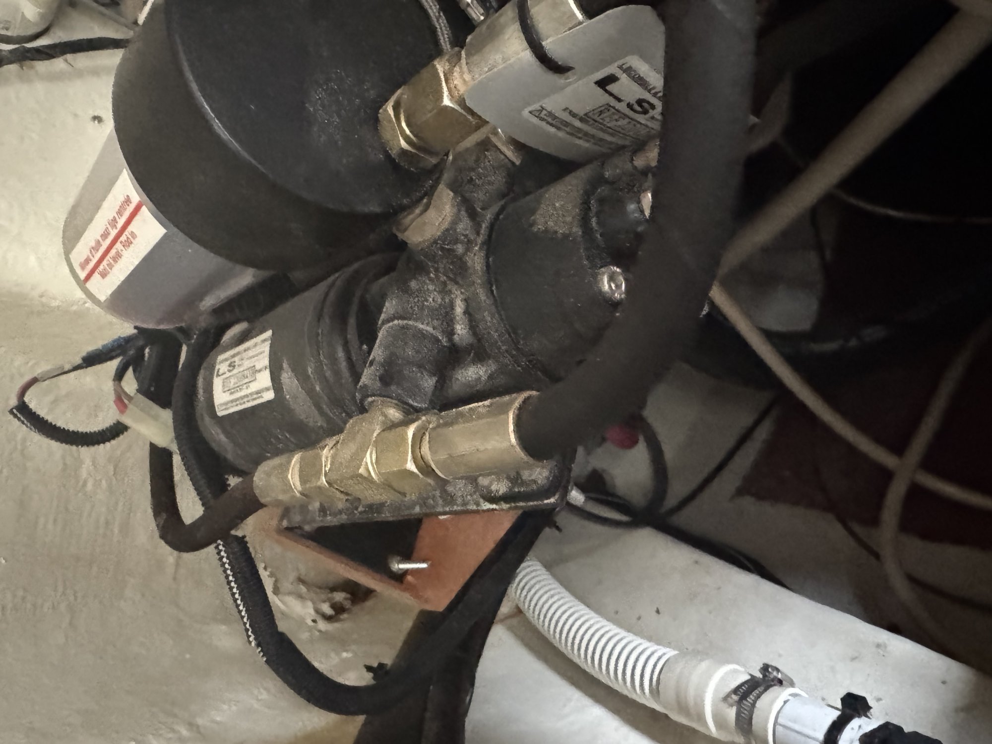

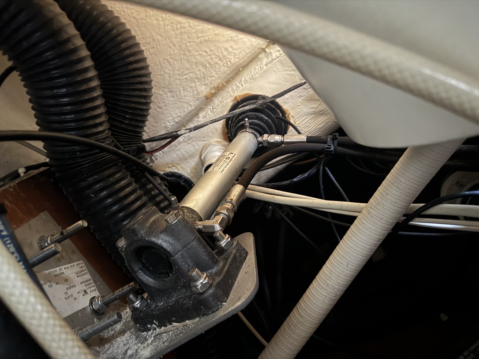

These photos were taken from the aft part of my starboard lazarrete on my 2005 Beneteau 323 (made in SC, USA) that were installed as an optional underdeck hydraulic linear autopilot. The are a Lecomble & Schmitt (L&S) hydraulic linear drive system, very likely an LD100 or closely related model sized for boats in the Beneteau 323 range.The silver cylinder mounted athwartships is the L&S hydraulic ram (linear actuator) that connects to your steering quadrant/tiller arm to move the rudder. The black assembly with multiple hose connections and the silver motor on top is the L&S reversible pump/motor unit that pressurizes the ram; this whole unit is the “hydraulic drive” controlled by the autopilot course computer. I have a Raymarine SmartPilot ST6001 (possibly a +). I am unsure but the ram arm attachment. to rhe wuadrant may be accessible by removing a panel of the deck emergency tiller.
Jun 27, 2018
16
Beneteau 323 88 Grand Rivers, KY
My autopilot hydraulic linear LS drive I assume is like DougM’s above so I was curious. I. don’t see any leakage from mine and it works (I have only had my 323 for a month now). Here is a manual NOT-300-VERINS-INBOARD-LS.pdf
