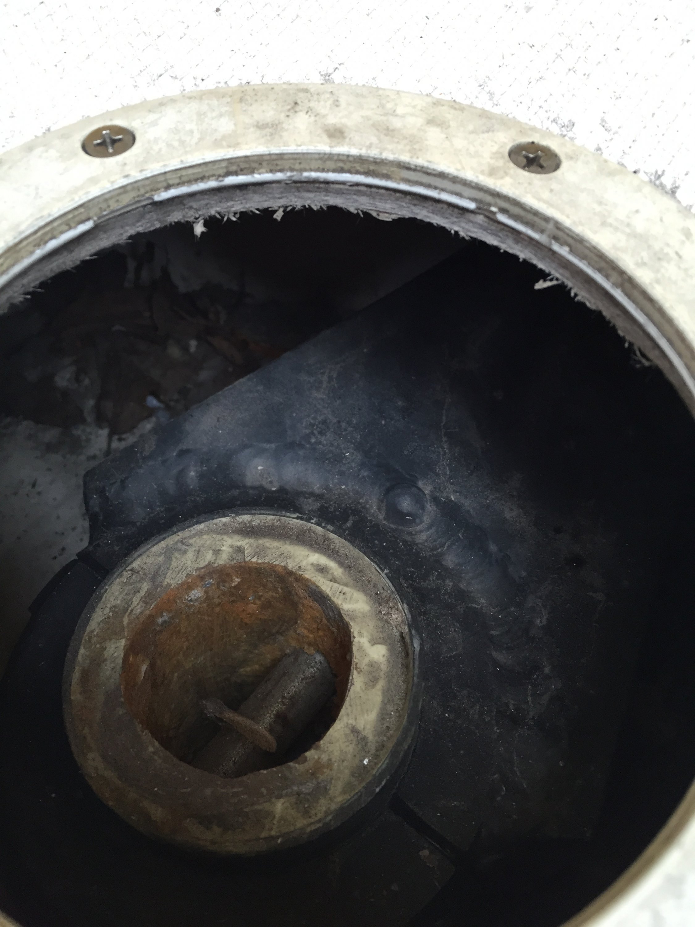

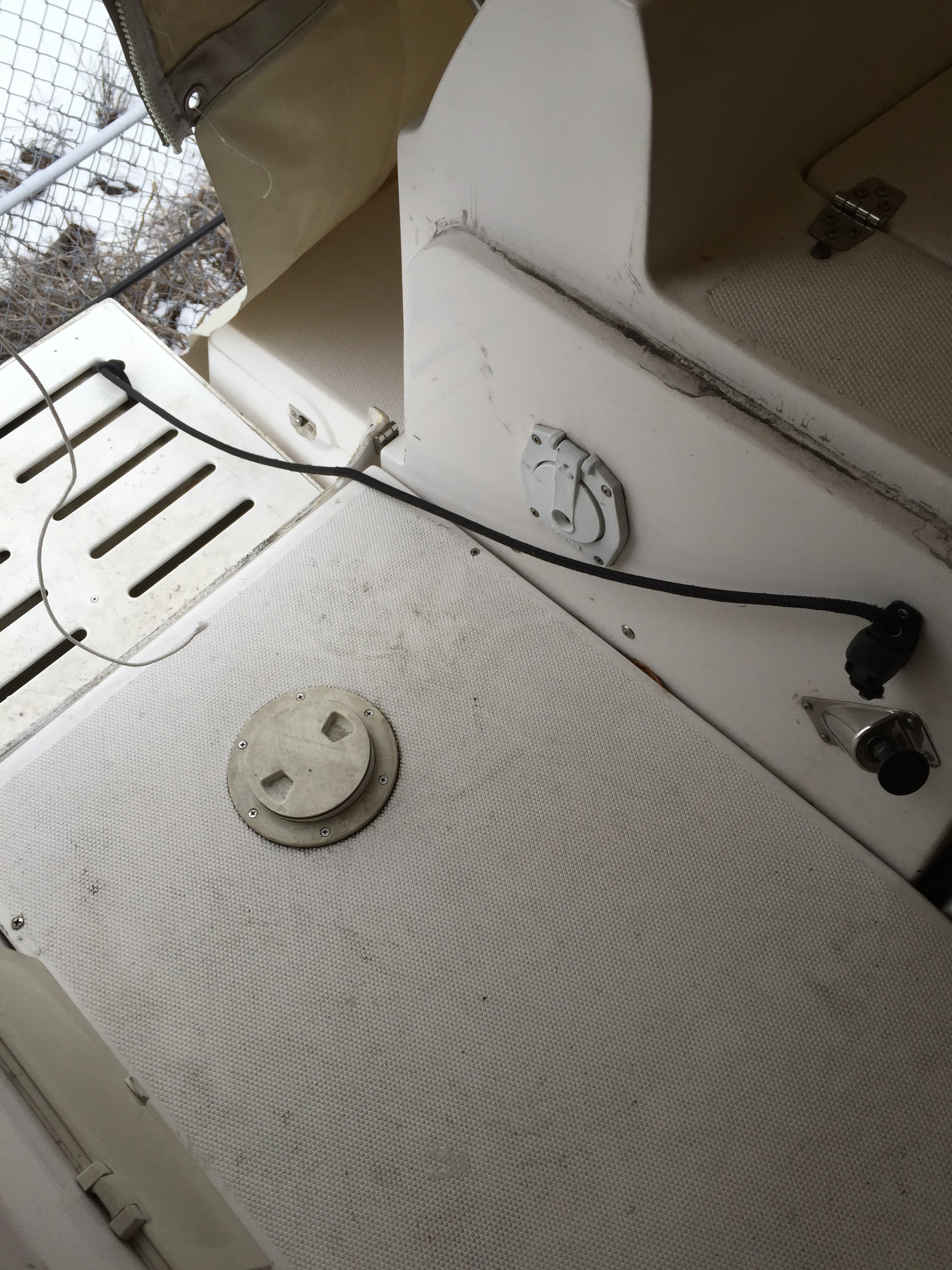

it's the bulkhead in the lazarette where they mounted the drive, not the aft cockpit locker. I tried to get a pic of the quadrant - it's definitely very different from the 36.and doesn't have the second lobe where the drive is attached.. the cockpit locker has a space - where Jerry's box is mounted - and if the drive shaft is at the very bottom of the drive it could go thru the side of the locker and come under the cover over the steering (where the helmsman stands). It will take careful planning to make the mechanical link to the quadrant - there's not much room.
