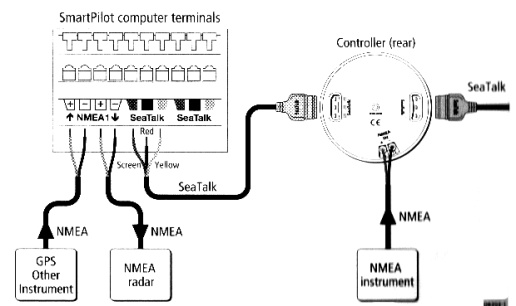

Hi,
I have the H260 sailboat with the wheel steering and Garmin 740 GPS on it. I want to install the autopilot , please help me, what should I get, and what brand? I don't want to overspend for the trailerable boat. How hard is to install it?

Autopilot brand should not matter, but I suspect with the wheel your options are for the Garmin and the Raymarine. There is also a CPT out there but it is a few more dollars. I have the Raymarine and on the back of the control head it has connections for NMEA 183 which is the serial standard that every chartlotter/gps supports. Picture attached.
