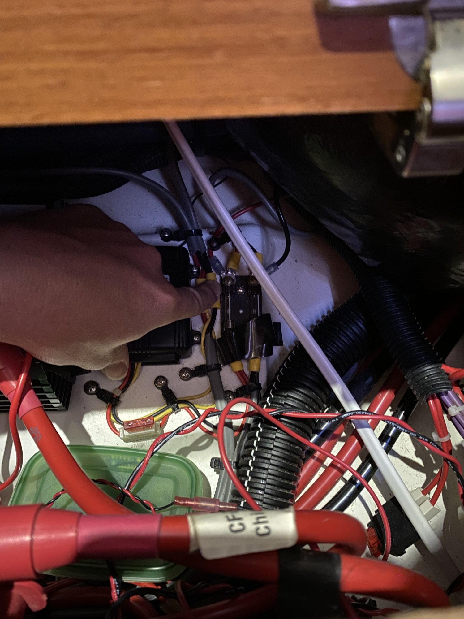

My 2013 Oceanis 41 has a Rule Mate 1100 automatic bilge pump. The pump operates with the switch in the on position, but will not kick on with the switch in the auto position. I suspect a blown fuse near the battery, but I am not sure where the fuse is located. There is no wire coming directly from any of the batteries. Is the fuse on a relay near the battery, or somewhere else?

The 2014 37 has a pair of glass fuses in the battery switch compartment in the aft cabin. A small wire comes off the output side of the large red house battery switch and goes into one of the fuses. The fuse leads to one wire going to the bilge pump and another to the memory-hold circuit of the stereo. The second glass fuse fuses the negative of those circuits.
As a result of the shared fuse any fault in the stereo (like damage from lightning) also disables the auto part of the bilge pump :huh: .

The way Beneteau wires the pump (at least on the 37 of similar vintage) it could still be a fuse. Beneteau wired the electronic “float” to power the pump in auto mode through a fuse directly off the main battery switch. The manual switch on the DC panel bypasses that fuse and powers the pump directly.

I certainly agree with that. Ours actually has a both an “auto” and “on” mode for the pump on the DC panel. The “on” mode bypasses the water sensor and runs the switch manually as you’d expect. The “auto” side is deceptively useless - the output of that isn’t actually connected to anything, since the sensor wire bypasses it completely.
