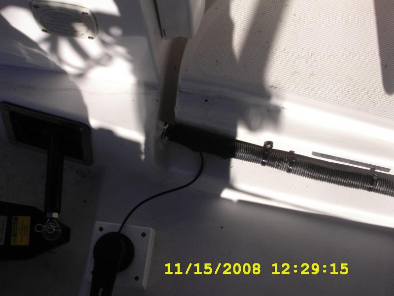

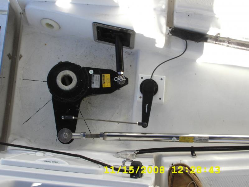

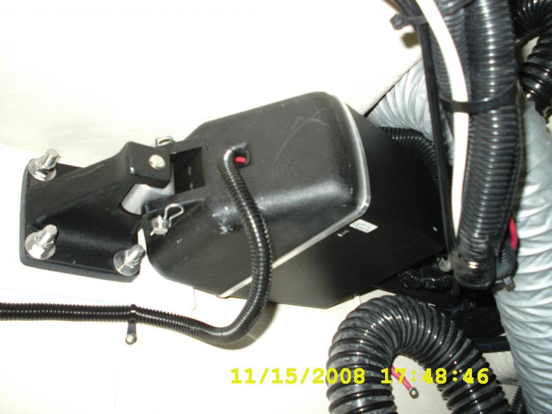

Did you happen to take any photo's of the unit all back together and any photo's of what it looks like installed.
I am thinking of up grading my AP that type drive unit on my 2007 H-36 and here some photo's I have seen and just wondering how yours compare and may be different with my newer rack and pinion.

Are those pictures of the autopilot of what you currently have installed or planned?

Hi Jim
Those photo's are some from Hunter Factory install on I think 38 and are also from a H-36 but not sure I will make the up grade yet and not sure I will do it at all at this time,my works pretty good so far.
