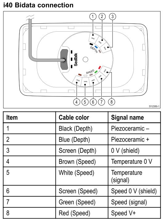

I see that the Raymarine i40 only has connections for seatalk and a sensor, I can't tell which one.

Alternately, as you note, you can wire your existing transducers to the new i40 display, using one of the 2 connection options.

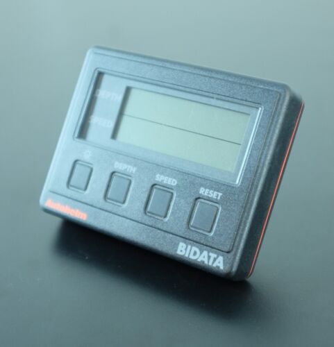

At this stage of the game you may want to consider the I40 BiData display. It is the replacement for the ST40. Fits the same space. As far as I can determine it can use the old transducers.
