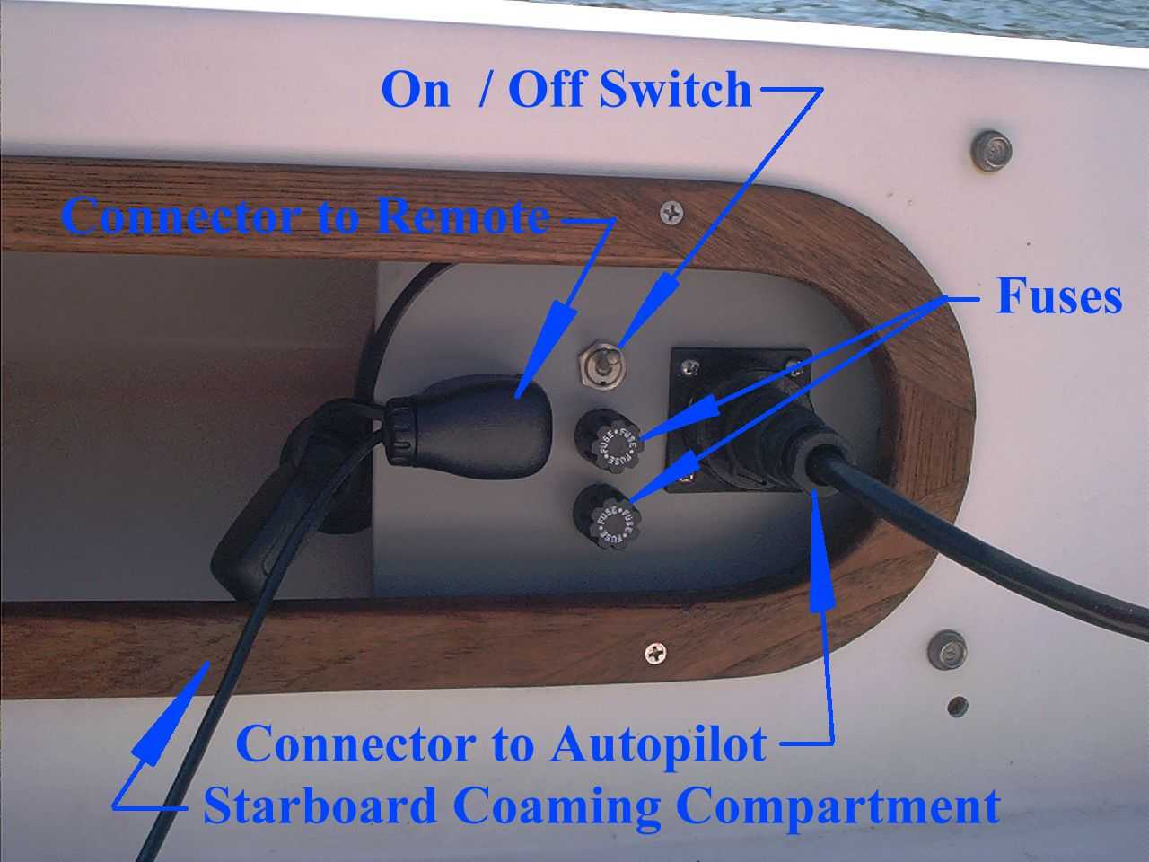

Photo of Electrical Connection
Rex: I couldn't open the link that Don attached, at least not on this computer, and I really wanted to. I try at home, later. I have received 2 requests for the photos showing my installation, so far, and have forwarded the photos. I'll try to attach one to this response. It shows my starboard coaming compartment where I put the connectors for the autopilot, remote, and the switches and fuses. This panel was my first attempt, and I made it from a scrap of plastic that I had. I didn't want to drill any more holes in my boat than I had to, and the holes that I drilled for this are all covered up by the teak trim ring. This spring, I will add the connector to connect the GPS to this panel. I might even reduce the size of it if I have time. I'll still send you the other photos showing the mount, if you want. Send me a message at aadjcamacci@panetwork.com. Aldo

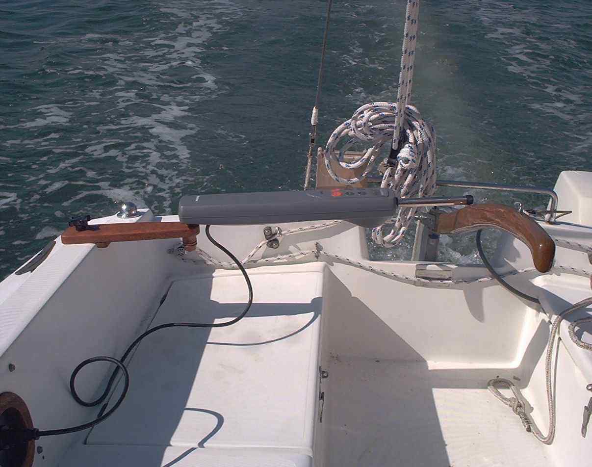

Another Photo of Installation
Rex: The photo didn't upload, and I couldn't delete this response. Aldo
A
Aldo
Rex: The photo was still too big, next time I'll get it. Aldo
A
Aldo
This time I think it will work
Rex: This time I think I have it compressed enough. (The little wooden block behind the autopilot, attached to the traveler, is our dinghy motor mount). Aldo
