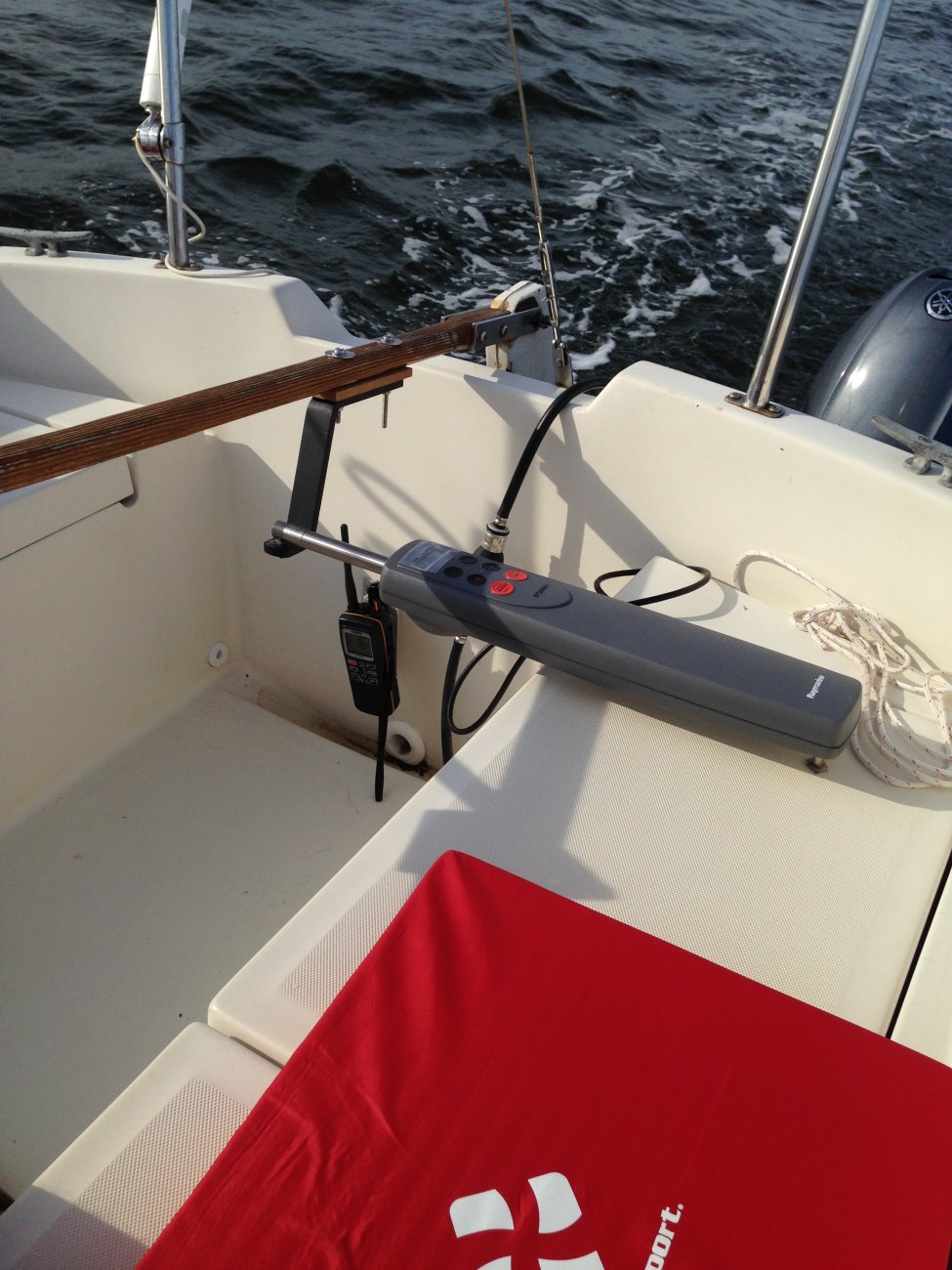

My OB was on the port side, I'm right handed, I frequently sat on the port side, my wife mostly sat on the starboard side. So it made sense to me to install the ST2000 on the port side.
Attached is a photo of it in use.

I have an oday 25 and have used both the st1000 and the st2000. The st1000 is not designed to stop when reaching the end of the drive. Over time it will reach the end, keep trying to move the piston and grind itself to death. This happened to me so I upgraded to the st2000 as it handles the end of the drive by stopping. Mount the unit on the port side to allow access to the engine and hatch when the unit is being used. The st1000 and st2000 mount exactly the same. My mount is like that shown by Ward H.

I would go with the port side also. Does the ST get in your way when operating the engine? I see the need for the bracket. Lucky you with two hatches. I have a transom vent that I put my gas line through. 2000 seems like the way to go.
It did a little. My Yamaha had the shifter on the tiller handle just behind the throttle grip so it wasn't too bad to reach over the ST.
I had always planned to put another socket on the starboard side but never got to it.
