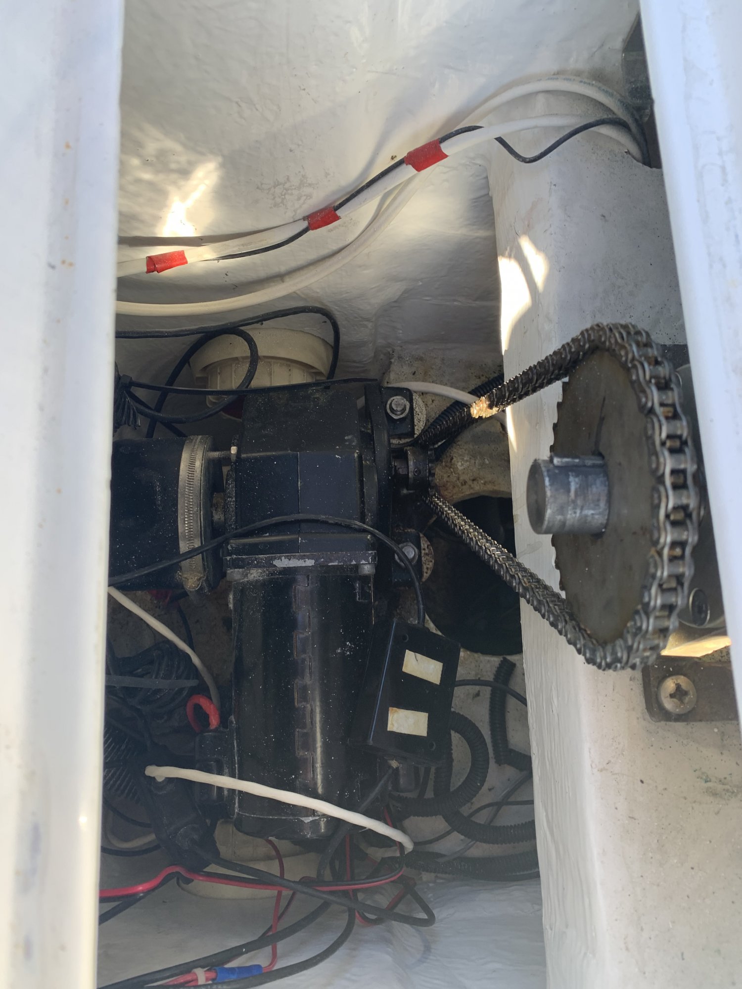

I’m also wanting to R nd R my autopilot on my H376. I was going to replace the electronic components, computer, head etc but keep the motor in the pedestal. I assume the motor is original equipment. Not sure what kind of system this is called. Any comments. Thanks

.............I’m also wanting to R nd R my autopilot on my H376. I was going to replace the electronic components, computer, head etc but keep the motor in the pedestal. I assume the motor is original equipment. Not sure what kind of system this is called. Any comments. Thanks
Looks like a rotary drive autopilot. What manufacture autopilot control do you have now?

Autohelm. I think made by ray marine. It doesn’t work now. I showed photos of parts to electronics guy at west marine and he told me they are the very old style. I bought the boat several months ago and upgrading a lot of stuff and I want a good reliable ap

I had a belt drive and controller Autohelm in the cockpit on my 1987 Hunter 31. Replaced it with a Raymarine wheel autopilot and companion controller. I wonder if Raymarine can confirm if you can install a new controller that will work with your drive unit?
If the motor still works but it's just the electronics that are shot, maybe you should contact Pelagic Autopilots and see if their controls could work in conjunction with your motor. It should be able to.

Walt, which pedestal do you have on your 386? My 2003 has the large fiberglass pedestal wrapped around the Edson rack and pinion steering. On this model, there is a Raymarine rotary driving a chain on the wheel shaft.
If you have the smaller pedestal that was on the later 386’s I’d go with below deck linear.
For me the existing drive and clutch were in great shape, but upgrading the computer to the EV-200 with the EV1 gyro compass unit. I had upgraded the wheel pilot on my H31 to the EV100, and loved it. What ever you pick, be sure to network it to your wind and speed sensors. The Ray units will sail a wind angle, and alarm if there is too large a wind shit, perfect for single/short handing.
