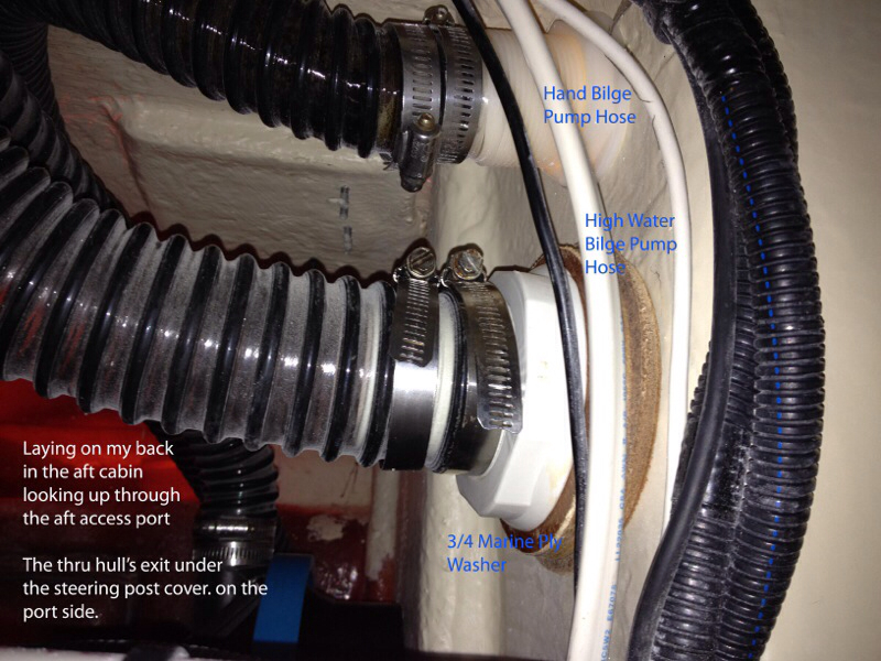

Although I did find a photo of the space another contributor on here has posted. Its showing where he put the discharge for a high water bilge pump (something I am going to do). The linear drive goes through the side wall right in front of where he had labeled hand pump discharge.

Thank you! I, too, need to put a manual bilge pump in. I have been looking for a space to do that, too. Maybe install both at once and have only one clean up.
