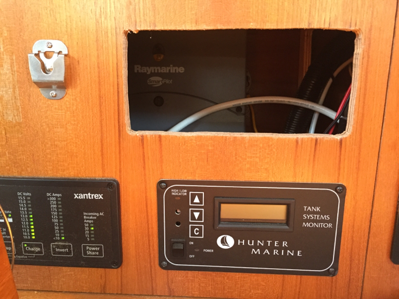

I have a Raymarine, ST6002 series auto pilot believe original unit on 05 Hunter 36. Can someone tell me where the location of the Smart Pilot computer may be on this boat? Had the GPS out for repairs recently and after reinstalling the smartpilot controller and screen have no function. Hoping one of the fuses is bad on the computer. Thanks for your help.

have you got a auto pilot display at the helm ...if so trace the wire coming out of that back and on the other end of that wire should be the computer ...or find the flux-gate compass and follow the wire from it back and the computer should also be on the other end of that wire

It could be different places that a dealer installed and look in rear stern up high
in port side rear locker and that's where mine is or could be behind the high cabinet at nav station.
Also check all the wires connected to GPS at the helm and I had bad connection
in my Nav Pod at the helm and try following wires from control head.

I have a 41 DS and the smart pilot is located behind the panel holding the vhf radio and tank monitors etc.
