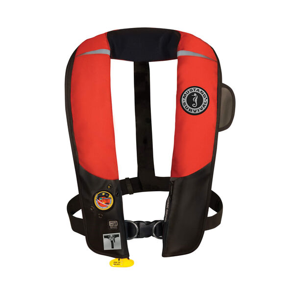

My preference is for an automatic hydrostatic inflator. These are less sensitive to dampness and getting wet as they inflate based on water pressure. Mustang makes them among others. I have 2 with harnesses.

No, it will not deploy in rain. However, at least the old still "pill" inflators could deteriorate if there was excessive dampness over time. That's why I prefer the hydrostatic inflators.

At Annapolis we looked at the Spinlock 5D Deck Vest with harness. I found it much more comfortable to wear than the Mustang HIT vest we have been wearing for the past 6 years. The 5D is auto inflate has built in harness and crotch straps. It uses a "pill" type activator but is "improved" to avoid false tripping. Apparently the pill sits in a tube protected from rain and splashes of water. When it goes in the water the water rises in the tube to get to the tube.
