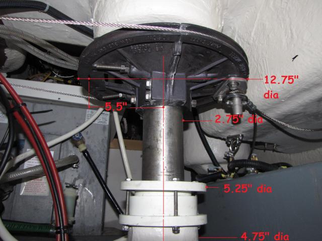

rpwillia . Sep 29, 2008 1,981 Catalina 310 #185 Quantico Apr 29, 2010 #4 $0.06 - Stolen from Paul J "Good artists borrow; great artists steal" ascribed to either Picasso or Salvador Dali. If you get the AP with the rudder sensor, don't fret but look at the attached picture. Built it from PaulJ's specs. That was one of the harder parts. Attachments IM000915.JPG 82.6 KB Views: 299
P paulj . Mar 16, 2007 1,361 Catalina 310 Anacortes,Wa Apr 30, 2010 #5 For an in focus picture Ray............ paulj :troll: Attachments Auto pilot bracket sketch.jpg 31 KB Views: 282 First dimensions.jpg 47.3 KB Views: 309 IMG_0937.jpg 54.8 KB Views: 287 IMG_0939.jpg 47.1 KB Views: 290 IMG_0943.jpg 45.6 KB Views: 279 IMG_0944 - Copy.jpg 39.8 KB Views: 304 Rudder Postion Sensor.jpg 43 KB Views: 303 scan0002.jpg 28.1 KB Views: 312
