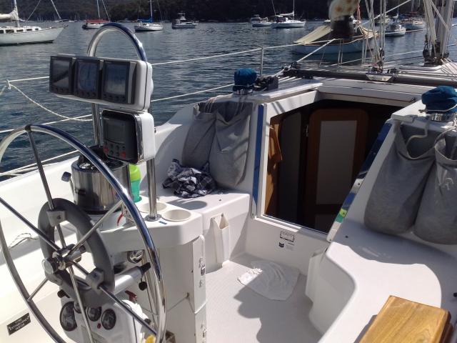

Did you install it yourself and, if so, how did you do it?
Yes, installed it myself with some help from this forum and quite a bit of patience. Otherwise, just followed instructions in the manual.
Most difficult part was threading wires thru pedestal guard and cockpit floor.
As you can see from attached pic, the Pilot Controller housing is mounted separately on the guardrail. At the time I thought it’d be cheaper and easier. In hindsight I probably would have been better off by replacing my existing Navpod with one that could accommodate the Pilot Controller , at not much extra cost. But I was also keen on getting it all fixed for my purposes and go sailing.
Consequently, I do not at the moment have the Pilot Controller connected to the other instruments and therefore lack the automatic Windvane/angle mode. However, that would only need connection of a wire. GPS, when required, can be connected to the Course Computer, which I located under the Nav table.
Things to watch: Placement of compass distant from ferrous metals, motor wire is not very long, ensure there is enough space for drive motor and clutch.
You will find many different ideas in posts in the 310 and other forums regarding installation of the Pilot Controller, Drive Motor (some routed their connections thru the Engine Display panel), Fluxgate Compass and Course Computer. Some prefer to add a rudder sensor. You may be able to adapt these thoughts to your C30.
Commissioning and subsequent adjustments are easy. Happy to answer any questions
PS. Being totally unqualified, it took me about 3 half days on a swing mooring.
