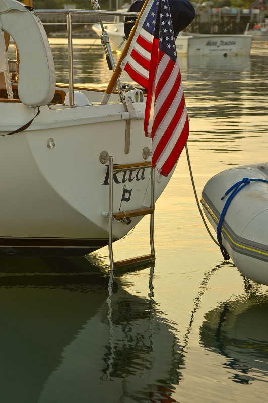

C'mon Gail she's no pig! I think she has a rather nice behind (see below=sexy). I do agree with waiting till your next boat though and I understand you two have been loosely tire kicking the idea about..:)
Thanks... perhaps a poor choice of words on my part. Indeed we are kicking keels (certain sisterships to your boat are quite enticing) and we would NOT get the return on investment if we put a radar on, only to sell her right afterwards.
She does have a rather nice behind, but we have GOT to do something about that stern ladder! Her behind would be so much prettier without it!
