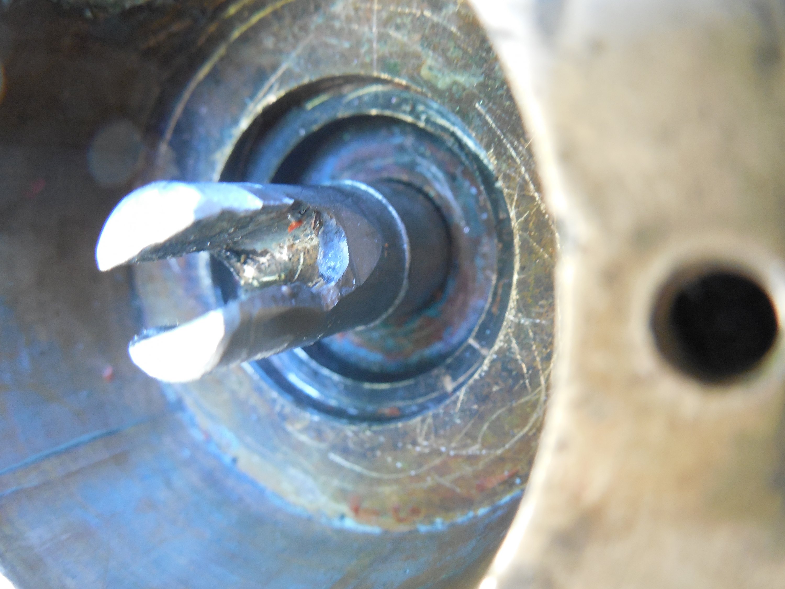

When inspecting again the shaft after a recent not quite successful new seal attempt to stop my Jabsco 2760-003 seawater pump from leaking, I noticed it (the shaft) was in fact scored.

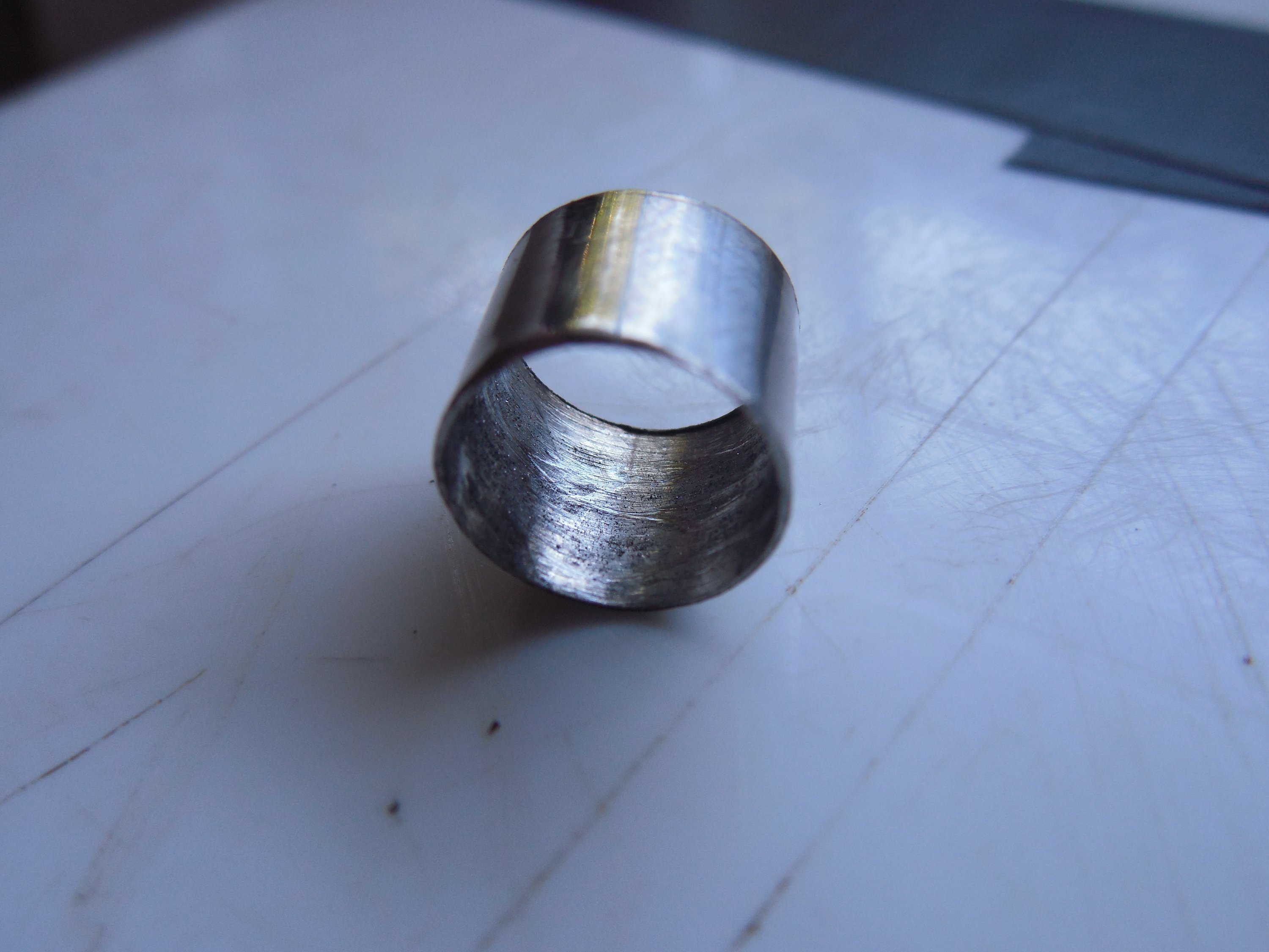

But I did come across on ebay a 10mm O.D. stainless steel tube with a very thin 0.3mm wall – which yielded an I.D. only 4/1000” smaller than 3/8”. Maybe worth a DIY sleeve attempt? I ordered.
A 3/8” drill bit easily reamed out the 4/1000” ID undersize. The reamed out length slid snugly over the shaft. The tube is the welded type, so it had a very slight ridge along the weld line. Scraping with a sharp box knife took this down. Then I smoothed with 1500 grit wet/dry sandpaper. With a Dremmel cut-off wheel, I cut a length slightly longer than the 7mm thickness of the oil seal body. Smoothed out the burrs so the seal wouldn't be damaged during installation. Put a very thin layer of epoxy to the inside of the sleeve. Then with light taps on the sleeve lip using the blade edge of a slot head screw driver, slowly drove the sleeve along the shaft to the spot where the seal resides. Wiped off the epoxy that had transferred to the shaft. After the epoxy cured, I reassembled as normal the seal, o-ring, cam, impeller, gasket and cover.
Mounted on the engine today. No drips after 10 minutes running. Will report back again after an outing or two.

Reverting back to the DIY sleeve repair topic. What I don't know is the grade of SS steel the eBay tube I bought. I suspect 304. Not 316. Time will tell if its an issue that will lead to quick failure of the mod.
1,099
That is a commendable repair job, rardi! It will be interesting to see how it holds up. I suspect the 304 versus 316 stainless alloy will not be an issue. My understanding is that stainless steel is most vulnerable to stagnant salt water, so maybe not a problem in this application. I have had OK results using epoxies like JB Weld on different kinds of worn shafts; it would be interesting to compare the longevity of epoxy to sleeving. (I suspect the sleeve might win).

Two outings now since putting the sleeve over the shaft in the attempt stop the seawater leaking through the newly replaced seal.
Totally dry! So looks like the mod will hold until/unless the sleeve prematurely becomes corroded and/or scored. But considering that the shaft itself did the same after only 2.5 years and 150 hours ... shouldn't be much worse? The main risk to failure would be that the epoxy "weld" of the sleeve to the shaft doesn't hold.
