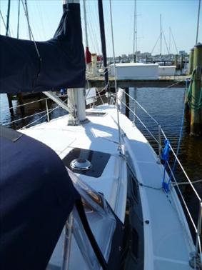

I just got my Wichard Gyb' Easy today. Been looking at the instructions and installation and think I might have a problem. The brake hangs below the boom in front of the vang, the line is supposed to run through it to blocks which should be attached at the base of the chain plates on either side (slightly forward of the brakes attachment point on the boom) and from there run back to the cockpit to the winches. So, my problem is I have a Vision 36 and no chain plates or rigging to attach to. The only things I have available are the base of a stancion post which doesn't seem like a good idea, or a deck cleat from which to tie a makeshit attachment for the needed blocks. Does this seem like a wise choice or do I have an accessorie that cannot be used on my particular boat?

No metal toe rail or any other attachment point is a problem on these boats.
I have considered getting one for my HV'36 and the ONLY practical solution that I have come up with is to drill larger holes in the side deck. Fill those holes with epoxy and then re-drill with the proper sized bolts. You should have an adequate backing plate for the mount that you decide to use.
Depending on exactly where the attachment points turn out to be, there may be some aluminum glassed into the deck. If this is the case, you would just need to drill and tap the proper sized holes.

Shouldn't the deck cleats which are mounted mid-ship be sufficiently reinforced enough to be used? The attached picture in the OP shows the cleat (with a blue line tied to it).

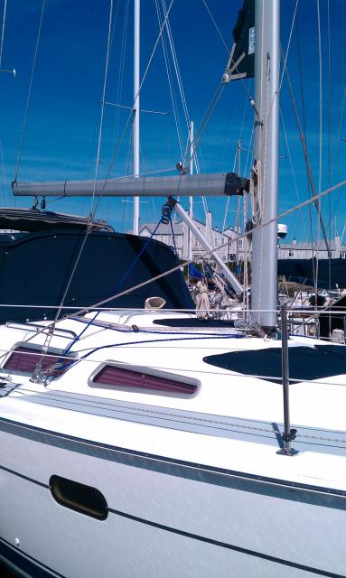

Save some money on blocks and install fairleads since all all you need to do is to is tension the boom brake line. I tie-off the fairleads to an inboard side stay. I route the line to mast to a fairlead then to the cockpit through a clutch where I can take to a winch to tension it.

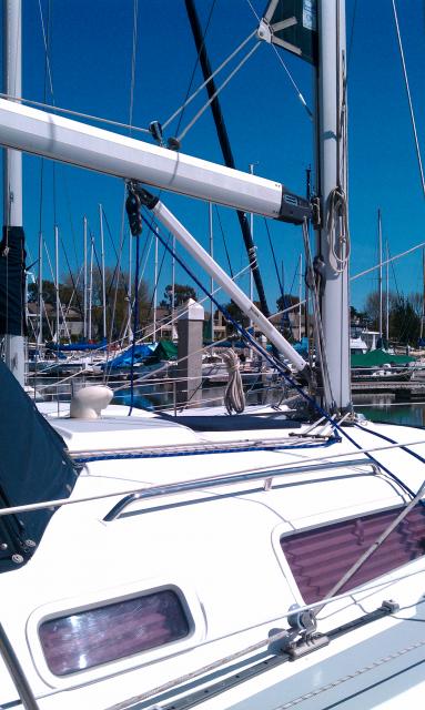

I have a dutchman on my 44. I use the midship cleats on both port and stbd, which seem plenty beefy for this load. On one side I have a single block turning the dutchman lead back to a single fiddle block attached to the spinnaker block fitting on the arch, then to the sheet winch. All works ok but it seems the dutchman is difficult to tune exactly for the wind conditions off the wind in particular. Either too much friction or not enough. Not to turn this into a dutchman teach-in, but does anyone with a dutchman have any tips to pass along?

The midship cleats on the HV'36 are not factory installed. Just check them out and be sure that they have substantial backing as Rich mentioned.

Rich: On the 44 there are two cleats port and stbd. I chose the one which supports the circularity requirement. So the thing works ok going to windward so that the boom crosses over smoothly on tacks. But off the wind there is so much friction in the mainsheet and dutchman combined that most time I have to run up on deck to fiddle with the adjusting knob on the dutchman and push the boom out manually, which as you know is not very far to begin with due to the swept back spreaders.
