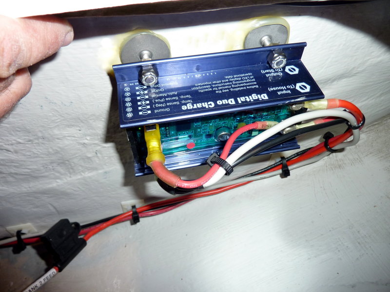

This is the exact situation the OP is trying to avoid. This bulkhead was very thin and gelcoat on the other side. Owner did not want visible screws and not enough meat to drill into without poking through, maybe 1/8" thick..
This option allows the Duo Charger plenty of air flow for cooling and took all of six minutes to mount...
