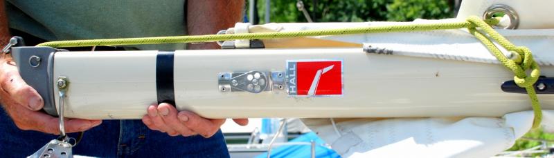

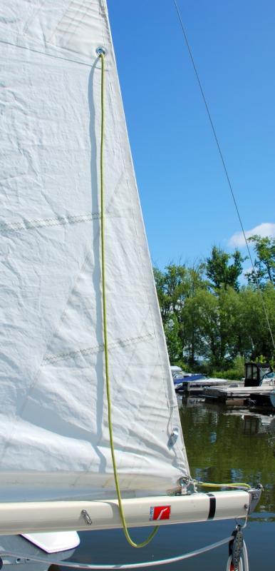

Mick...
On our boat with single-line reefing
1. the line exits the aft end of the boom
2. goes up through the reef cringle
3. back down and under the boom
4. then up to the line itself, tied off with a bowline in these pictures.
Since then, I’ve ended it with a plastic thimble in place of the bowline, which seems to cut down on the friction. Unfortunately, I haven’t replaced the photo.:redface:

Joe
Jun 1, 2004
8,349
Mick...
Paul
I'd move that cheek block on the boom forward 6 inches or so.. then anchor the loop end of the line to that, rather than back on itself, to get the desired 45 degrees down/back... problem solved.
