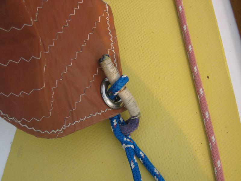

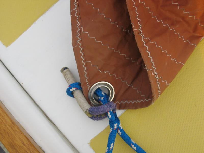

You need sheets with a couple of long eyesplices, about like dock lines. These pictures actually show a mock up with a couple of dock lines.
The first sheet is put on by running the end through the eye in the normal manner. Both it and the bitter end of the other sheet are run through the second eye as shown.
If you try it out ahead of time, you can have the splice for one sheet made shorter for better appearance.

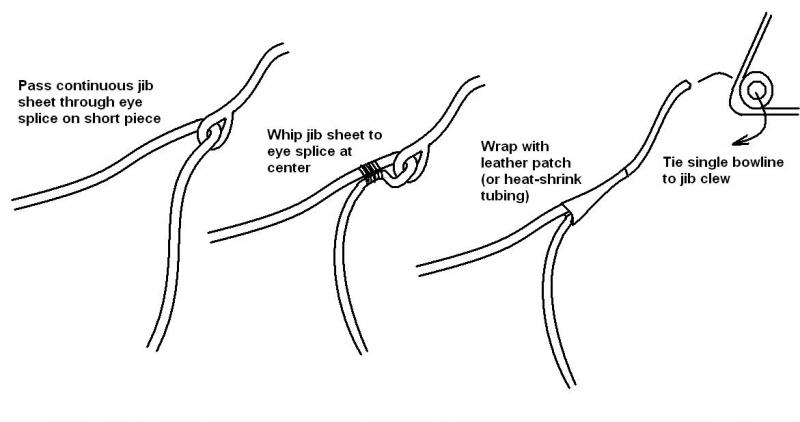

Here's the way to do it if you have the foresight to buy your sheets in a single length:
