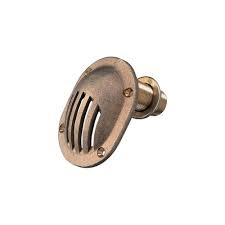

@jviss: entertaining thread so far. My 2cents? yes, short bronze screws. And bottom-tap the holes in FRP is a good idea. Otherwise the risk is cracking the gel coat. A little adhesive on the threads and as gasketing on the edge, with slots facing backward. I have much like others, I have this version:
you're boat, you're option...LOL

I'll give you a quick lesson. My sailing buddy and I on different boats transiting the Fox River, WI locks, (when you could) had to wait for the lock to open. On one particular lock he got an engine overheating alarm. Shut down his engine and in the meantime was slowly being swept to the lock overflow, not a great position to be in. He found fresh water snails in his engine intake and was able to clear in time to not get pulled into the overflow. Lesson learned. We both installed the strainer you've shown at our next winter haul out. That was 30 years ago.
Now it gets fuzzy, do you face the strainer into the prevailing flow of water or away from? I've seen and read many accounts, no one unequivocally says one way or the other. I choose away, thinking the water pressure would assure water flow into the engine water inlet and nothing would have a tendency to stay on the filter long enough to embed. I also filled the screw openings with screws, I've seen some that don't. Here it is many years later, I've never had a problem with my intake water. Hope this helps.
I have the same integral slotted strainer thru-hull and love it for protection from debris in the water, especially in the river, but I can say from experience it does not protect against all fresh water mollusks. Zebra Mussels get in behind the screen when they’re small, attach themselves, grow in size and multiply until you have a problem. This is one of the reasons MaineSail hates exterior strainers. Depending on your waters, periodic diving between haulouts may be required to clean out behind the screen.
Our invasive Zebra Mussel population has been way down here the last few years. They so depleted the algae supply that they starved themselves. In the past, after winter on the hard, I‘ve used a knife blade between the slots to break out dead snail shells that were too large to have fit through the screen, but had not yet caused any noticeable problem.
I like that version, but I'm just too lazy lately to replace the entire through-hull. :) Maybe I should consider it.
I'm not crazy about how the through-hulls (TH) are done on my boat. The bilge is very shallow, and there's an elbow immediately after the TH and then a ball cock. It's like a regular plumbing ball cock, not sure if it's brass or bronze. So, not sure I want to disturb this at this point.

The clamshell filter on our NTU (new to us) boat mounts on a bronze gasket or plate with threaded holes for the bolts that hold the clamshell on it. The gasket is embedded into the hull around the intake. When we hauled in October the clamshell was almost completely clogged with barnacles. We're not putting it back on next season, so I get to remove the bonze mounting gasket.
