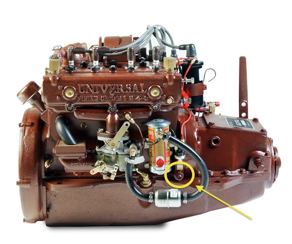

A4 Oil pressure adjustment located near the carb/fuel pump area. See the highlighted adjuster on the attached image for a visual. Jump over to moyermarine.com forums for specifics on removing and cleaning the crud out of the adjuster which can give a person oil pressure reading issues.
Idle oil pressure of 20lbs is typical on A4s, and then it should ramp up to as high as 40lbs at cruising. Plenty of discussion on what is normal at moyermarine forum, with a fair bit of variety from all the users.
I'm thinking overheating coil as well.
(Disclaimer: Not my engine in the photo, mine looks a bit dirtier and has a big boat attached to it ;) )
