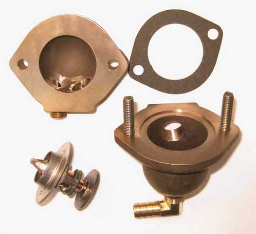

Here's a couple of options
I need to replace the thermostat on my 1981 Atomic 4 engine. The replacements are $250.00 +. Is there a standard replacement available at a reasonable price??
I am not using this but maybe I will someday:
$150 RWC or 135 for FWC, see pic below.
http://www.atomic4.com/thermostat.htm
An adjustable thermostat bypass valve makes the Atomic Four have that "vintage" engine look, but is completely unnecessary if a functioning thermostat of the correct temperature rating to suit the engine is fitted to a properly tuned engine that has reasonably clean water jackets, a properly functioning water pump, and (in the case of a post 1968 Atomic Four) a thermostat housing with a bypass port boss which is in good condition. If there is a need to restrict the bypass hose with an adjustable valve to prevent overheating, the engine and/or the thermostat or thermostat housing should be repaired/replaced. source:http://www.cncphotoalbum.com/atomic4/faq/atomic4faq.htm
Westerbeek 140 Degree Thermostat
$163 -- http://www.marinepartssource.com/newdetails.asp?mfg=Universal&pnumber=uJHW262278
