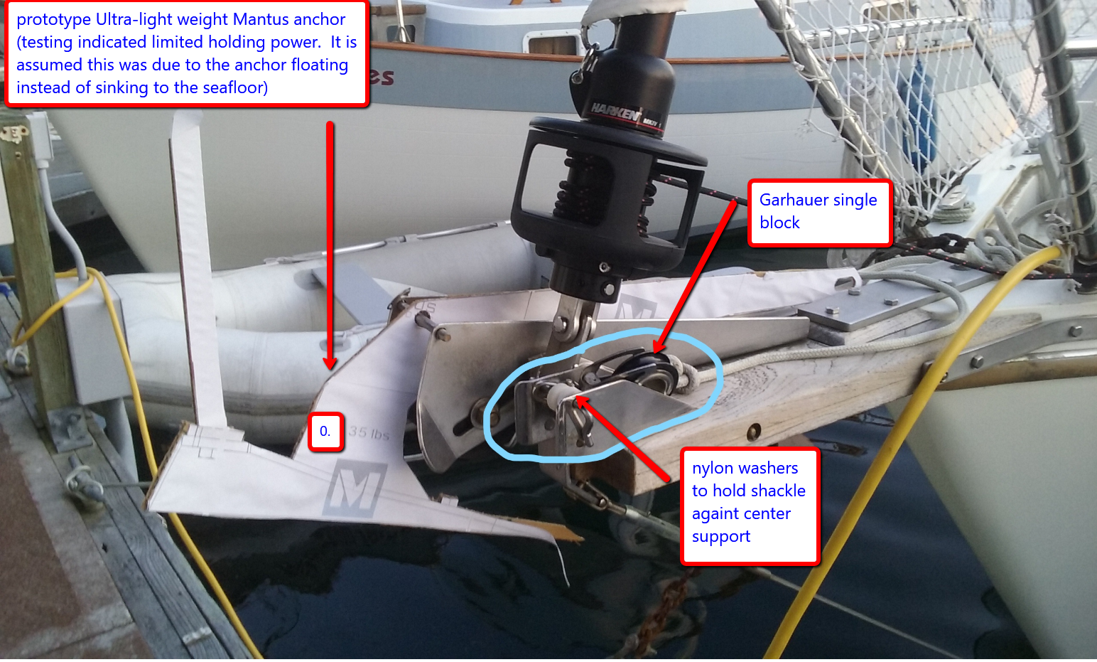

If your bow roller is securely attached to your boat, then it might be usable. That is what I have used.
I adding a length of shock cord to raise the tack block above the anchor on the roller.

Note that the ATN Tacker is not a tack attachment as it does not hold the tack down to the bow. Its purpose is to control the location of the the tack near centerline but you still need to run a line down to a strong point with a block attached. I attached to my anchor pin.

I have a shackle just aft of the roller furler that I could connect a block or anchor pin.
