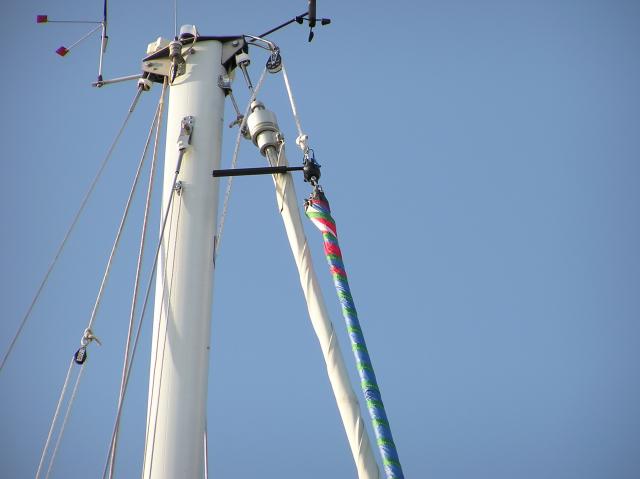

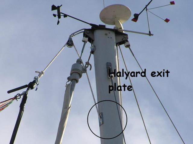

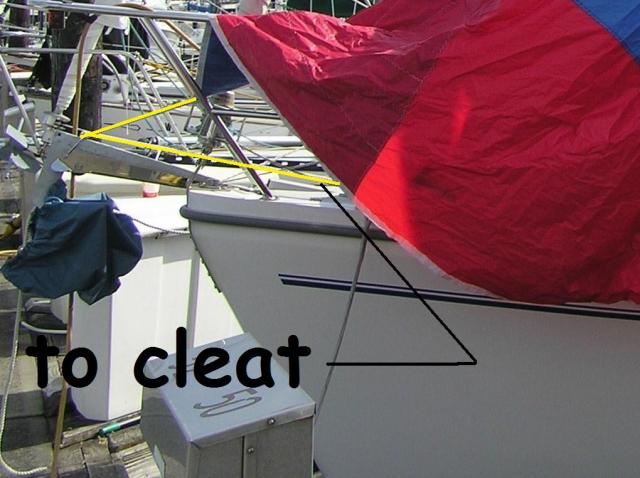

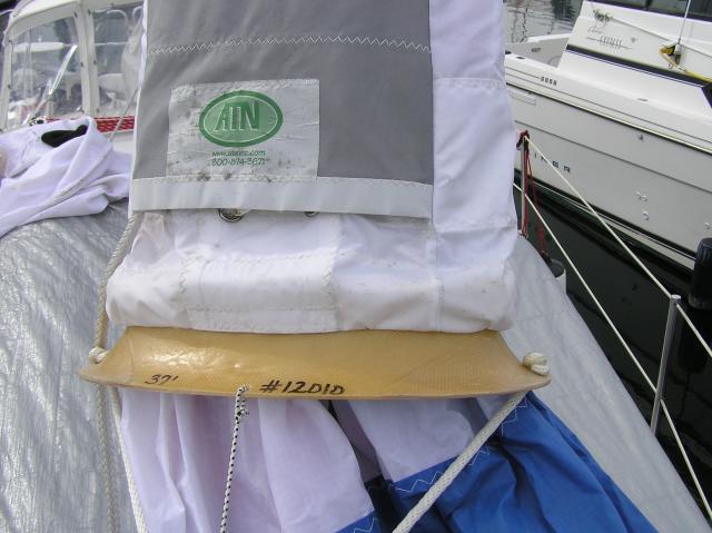

Witzend
Photo 1 My asym with a ATN sock.
Photo 2 My ATN sock and bag are for sale.
Photo 3 My asym on a RollGen.
Photo 4 Asym attached thru anchor bale to cleat.

Dec 25, 2008
1,580
catalina 310 Elk River
Paul, how did you get the halyard reeved to it's current route? Mine extra halyard comes out next to the jib halyard?
Dec 25, 2008
1,580
Yea, I was wondering if the asym halyard was being interfered with. What about butting a block where the exit plate should have been to provide fair lead?
So, your asym halyard was already run through this exit plate? I may have a plate, but there is certainly no halyard reeved through it.
Looks like for this mod. I would have to un-step the mast, add the bracket and reeve a halyard.
