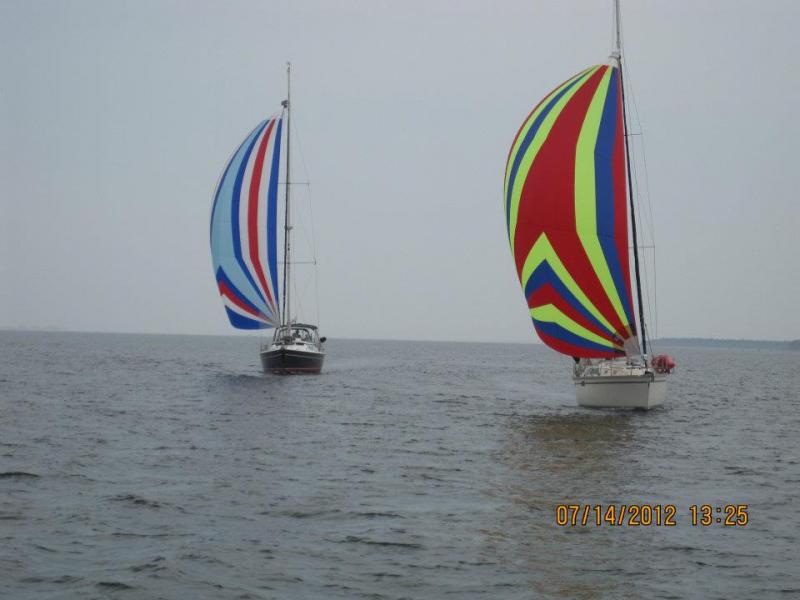

Offline, we have found that you can go directly downwind flying the Asym with the B&R Rig if you furl in the main nearly all the way or all the way. However we do prefer to go a bit off since it makes it easier to keep it full. BTW we fly it with and without the main deployed depending on the wind conditions and direction.
I know that as soon as I say that I will get a few responses saying that you should not or cannot fly one without having the Main deployed so I will share a Hunter Picture that I found. It looks as if he is going pretty much downwind.

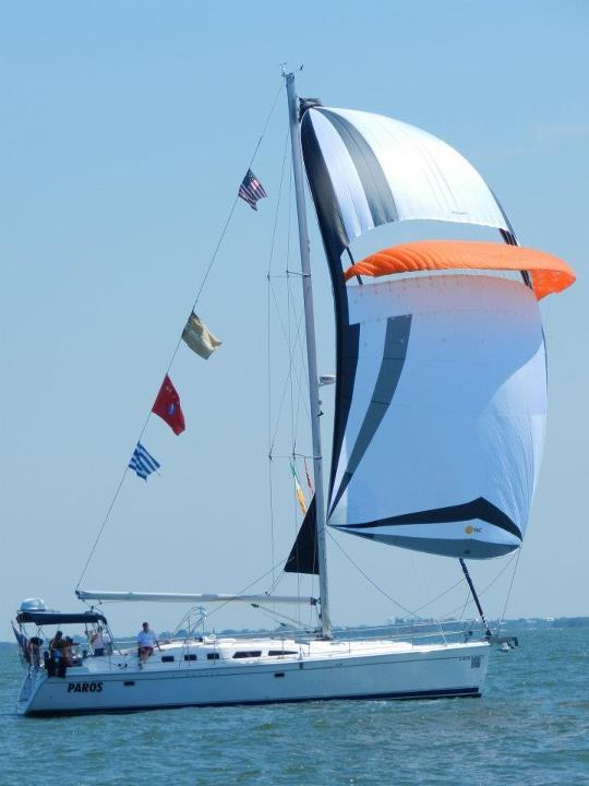

Nodak, that's a pretty wild looking spinnaker in your first picture. Never seen that before. I wonder what the theory is behind that design.

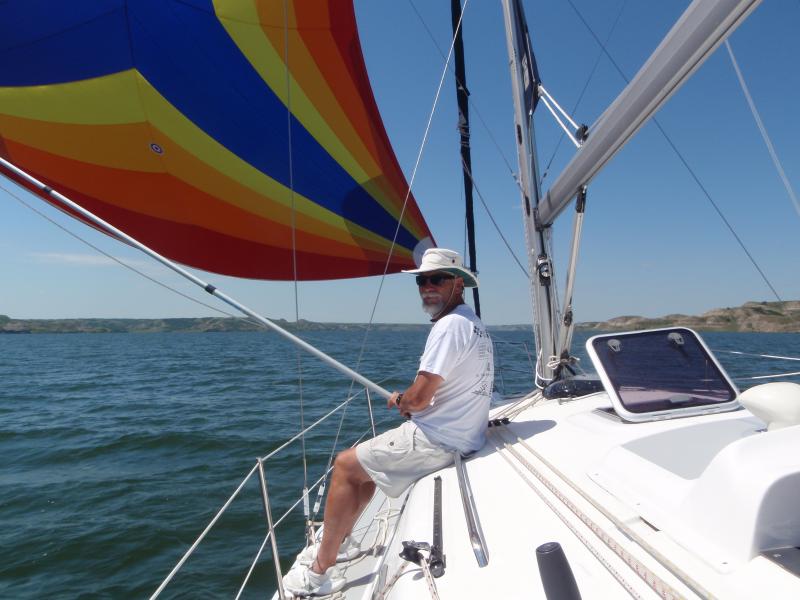

Offline, there has only been one time when we used a "pole" and that was one the wind was so light it would barely keep the sail inflated. We do not have a pole so I used an extended boat hook to hold the sail out. I think I have a video of it. So no I don't think you do need a dedicated pole. IMHO
If those two boats are going anywhere CLOSE to DDW that is terrible spinnaker trim. WAY overtrimmed. The tack line should be let out about 3 -4 feet, allowing the luff to curl to windward as the sheet is eased. Easily 1/3 of the spin should be on the windward side of the boat in this situation.
You can't fly it like a big genoa!
Jackdaw, relax, we were not even close to ddw in this picture. It was just a picture of the two of us flying the asym... :D
Here is a picture of us and our "spinnaker pole". I believe this was a bit more downwind then the other. You can see there is a little heel on so it is not ddw.
Here is a video of us flying it and it was not completely ddw
http://www.youtube.com/watch?v=qLURSOjUiQo&feature=youtu.be
:). All good!
My only question is this... Why do you need a pole to get the asym to fill fully? It seems over trimmed. The sail should fill by itself and fly directly in front of the apparent wind, particularly without a mainsail to blanket it.
In general I agree, for lazy days asym sailing when sailing deep, taking down the main is a good idea!

:). All good!
Jackdaw you do make a good point. In this case I wanted the clew of the sail out further do I could go further downwind. The wind was light enough that if I let the sheet out the sail would not remain filled.
BTW my Asym trimming is atrocious and I admit it. We really have not flown it enough to get the full benefits from it. It is just plain fun to fly though and pretty!

Istec Parasail
John, We discussed that sail here about 2 years ago. It is an Istec Parasail (http://www.istec.ag/us/products/parasail.html). I think it is pretty cool, but the smaller one that would fit my boat was $6500 :eek: and the better sized one (dealer said both would work) was $7500 :eek::eek:.
One of the magazines did an analysis of it (Sail Magazine?) and said it was nothing special, but I still want one. :D Just can't get over the price. :eek:
